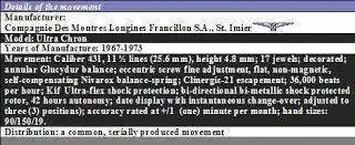

A Brief History of the High Frequency Watch Movements with Specific Attention to the Longines Ultra-Chron
[The following is a synopsis of the more detailed article which appeared in the Bulletin of the National Association of Watch & Clock Collectors, December 2007]. A full copy in pdf-format can be foundhere.

The base was designated caliber 430, indicating hours, minutes and seconds. This seventeen (17) jewel hi-beat movement was round and measured 11½ lignes (25.6 mm) and 4.30 mm in height. A movement this thin allowed Longines to encase it in cases of slender proportions and with the usual Longines style, yet they did not always take advantage of the movement's svelte dimensions or their own historical and undisputed flair for watch design. Many are quite simply unattractive watches. However, some encased in the thin Admiral one-piece cases were attractive.
Several variations were derived from the base movement. The calibers 431 and 433 have the date complication which increased the height to 4.80 mm for both despite the absence of a seconds hand on the latter; the 432, like the 430 but without a seconds hand and a height of 4.30 mm. The caliber 430 series found a home in one, two and three piece cases which carried such style names as “Ultra-Chron,” “Admiral HF,” Conquest and "Olympian." The “HF” indicated “high frequency.”
