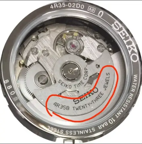

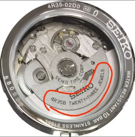

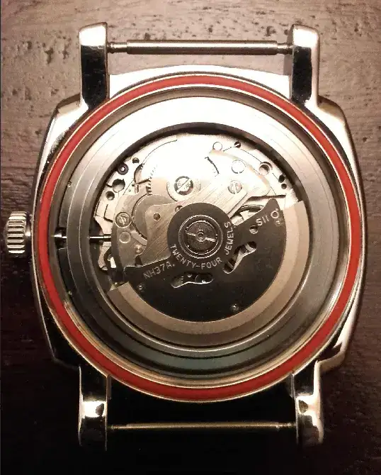

UPDATE: 23 OR 24 JEWELS CONFUSION
There is much confusion in the watch community around the caliber 4R35B jewel count. Blogs and watch sellers often refer to the 4R35B as having 24 jewels, this is because that is what Seiko’s official documentation has stated since the tech sheets were published in 2011. Interestingly, the conflicting information in the tech sheet appears to be caused by Seiko combining the calibers 4R35B and 4R36A in one document. The original 4R35A had its own tech sheet. The rotor drawing on the 4R35A shows the caliber number and jewel count spelled out (as it would look on an actual watch), however, the 4R35B/4R36A drawing has a blank rotor without any markings, continuing the cause for confusion.
We have not seen a caliber 4R35B powered watch with rotor markings indicating 24 jewels. The Caliber Corner Community is also backing up the discrepancy in the comments below, so we reached out directly to Seiko for information:
“Dear Seiko, can you please confirm if the 4R35B has 23 or 24 jewels? Tech sheets say the “B” has 24 jewels, but many watches with a 4R35B signed rotor say 23 jewels. Thank you in advance for any clarification you can provide. -Caliber Corner”
Dear Customer,
We have inspected few watches with B movements, and they all state 23 jewels.
Thank you for your feedback, we are in process of correcting that information.
Kind Regards,
SWA
De Caliber Corner.

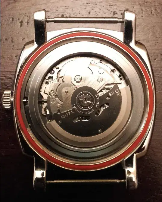

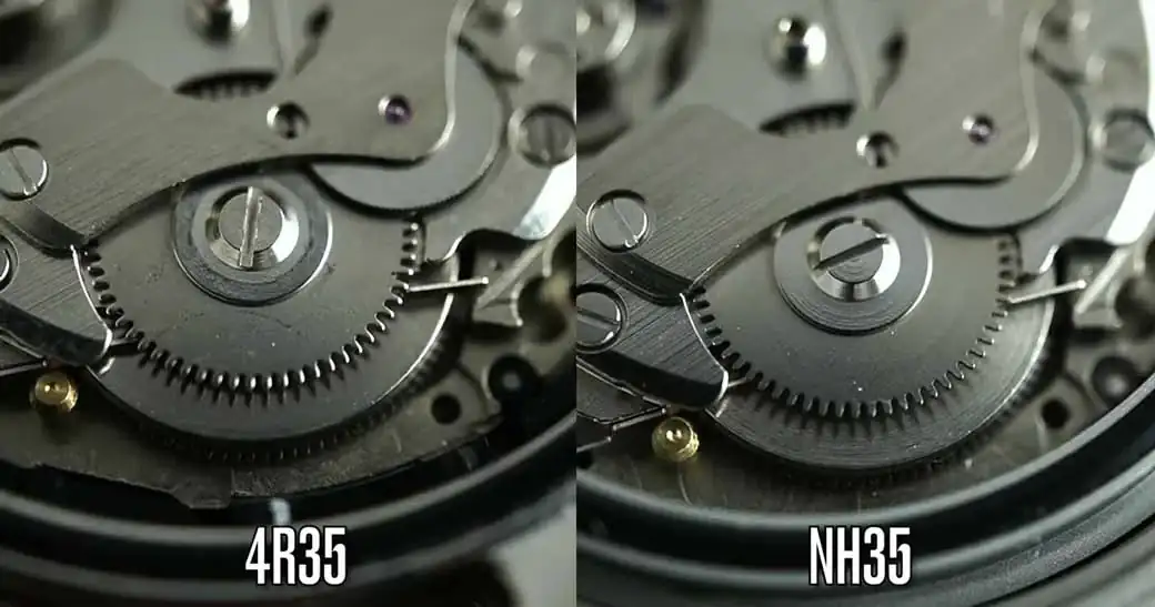

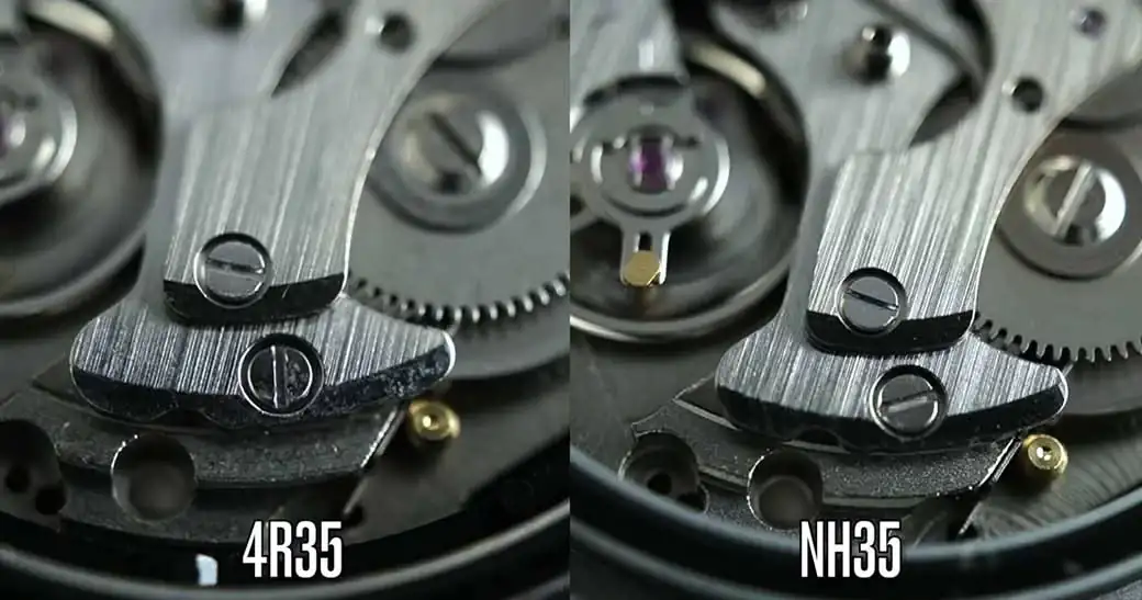

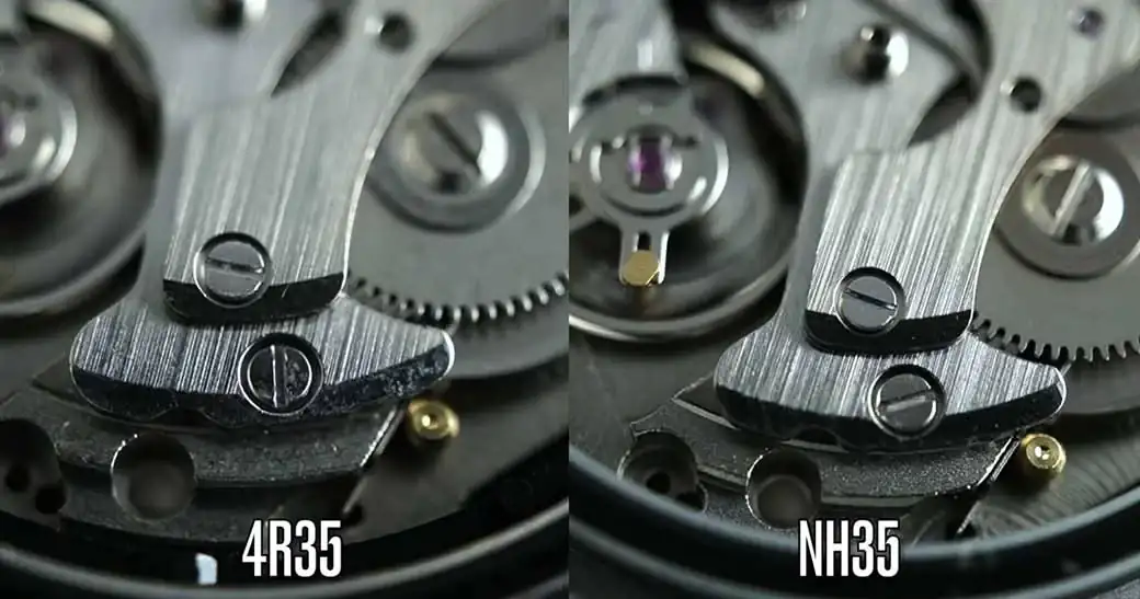

"El nh35 tiene 23 rubíes y el 4R35 tiene 24 rubíes".
Falso.
Los dos tienen la misma cantidad de rubíes.
Ver el archivos adjunto 2877794

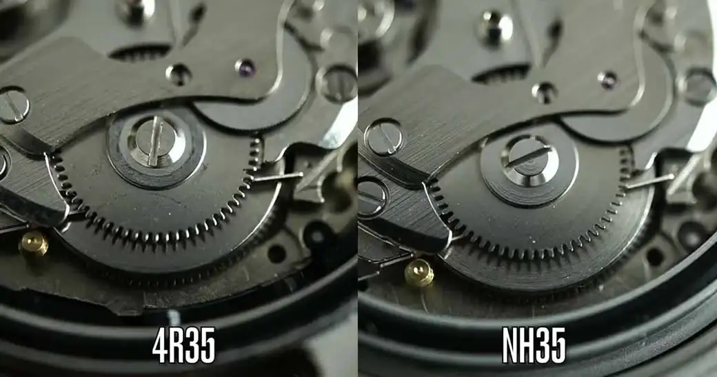

Enormes y evidentes diferencias entre Nh35 y 4R35, cualquiera diría que han salido del mismo torno, pero igual es un efecto óptico o alguna clase de droja 😂😂😂
Ver el archivos adjunto 2877795Ver el archivos adjunto 2877796
Solo una precisión. El 4R35 es la versión de Seiko del 4R36 sin fecha. En cambio, el NH35 es el que se equipara al 4R36, ya que son los que llevan fecha y día.
Lo digo porque la compración acertada sería NH35 y 4R36.
Reacciones: Josuegomez y Domimc

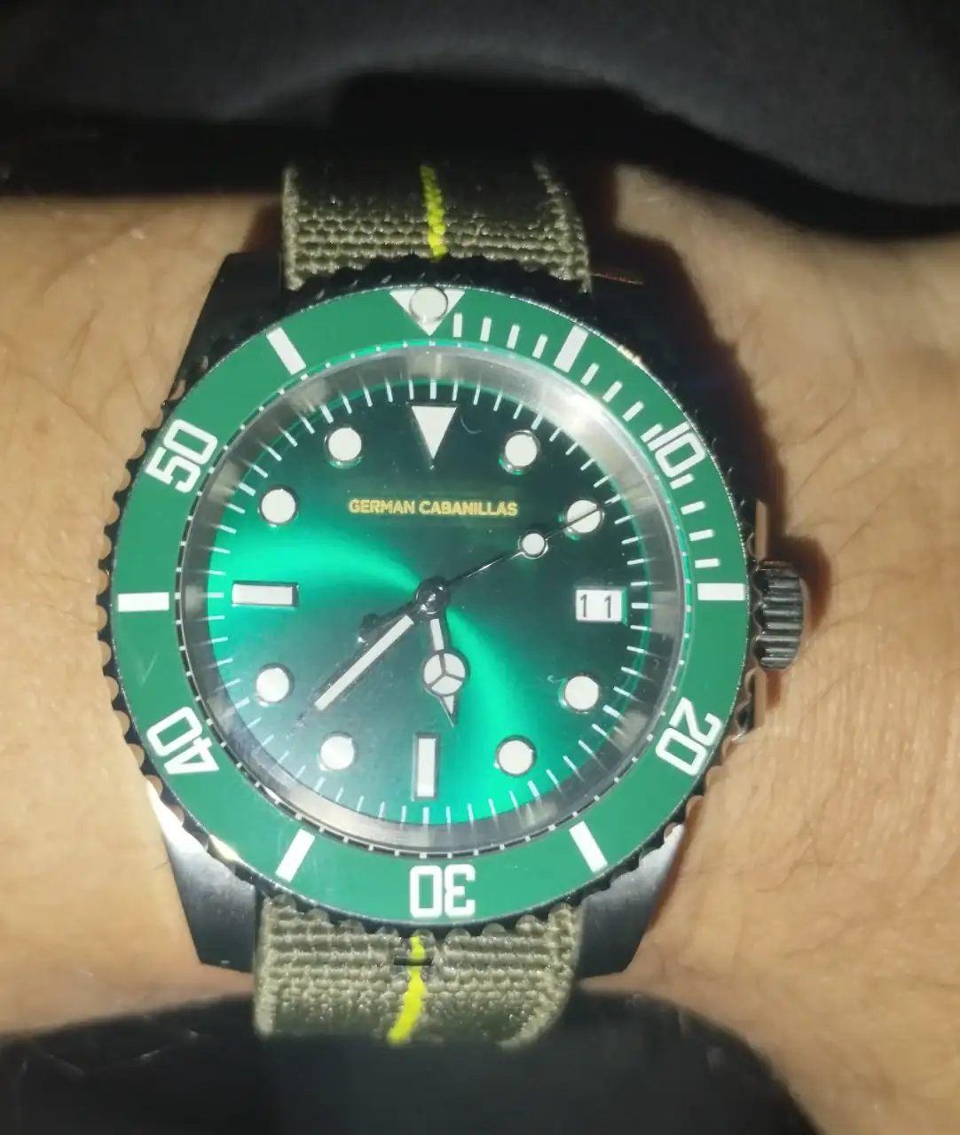

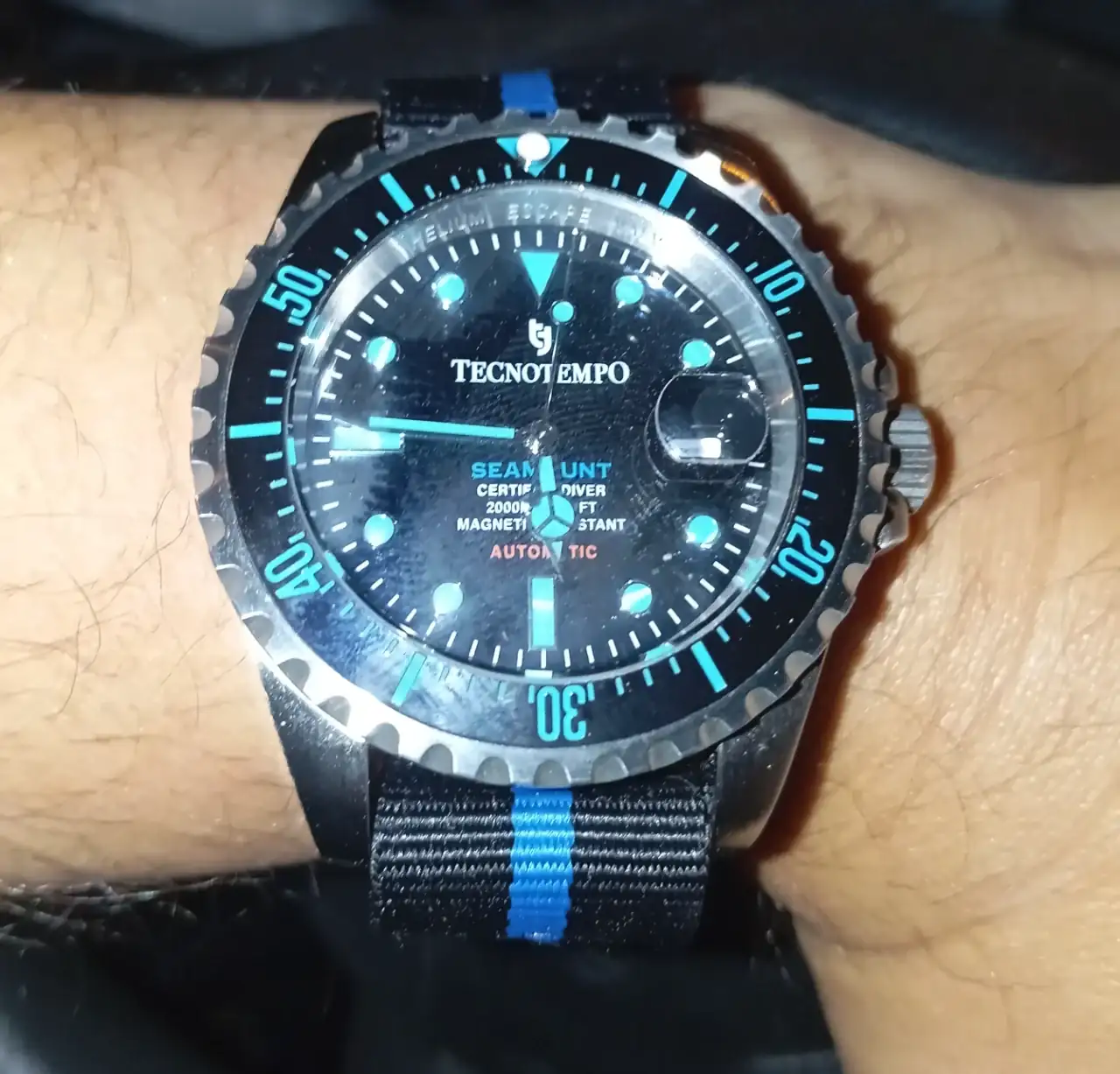

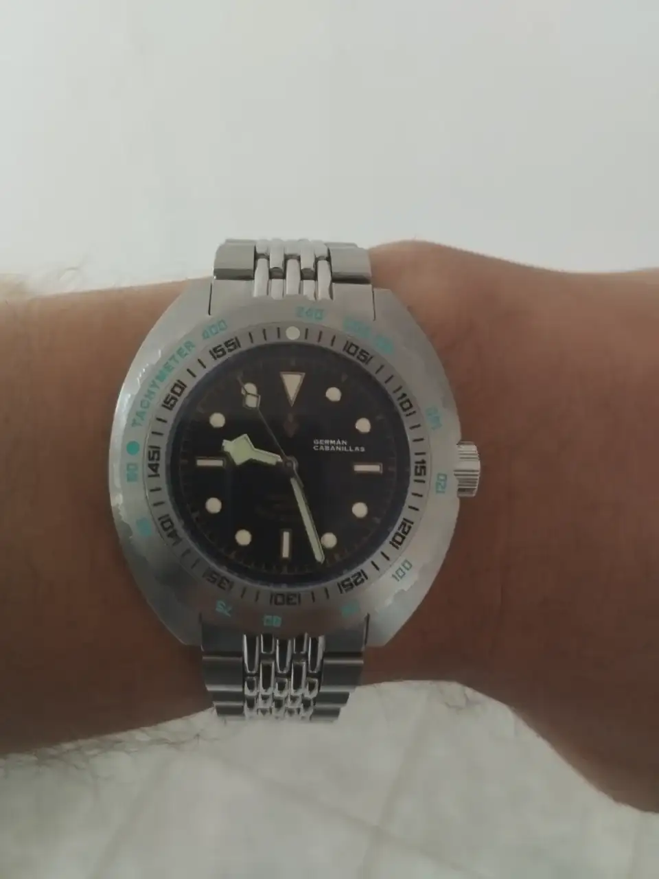

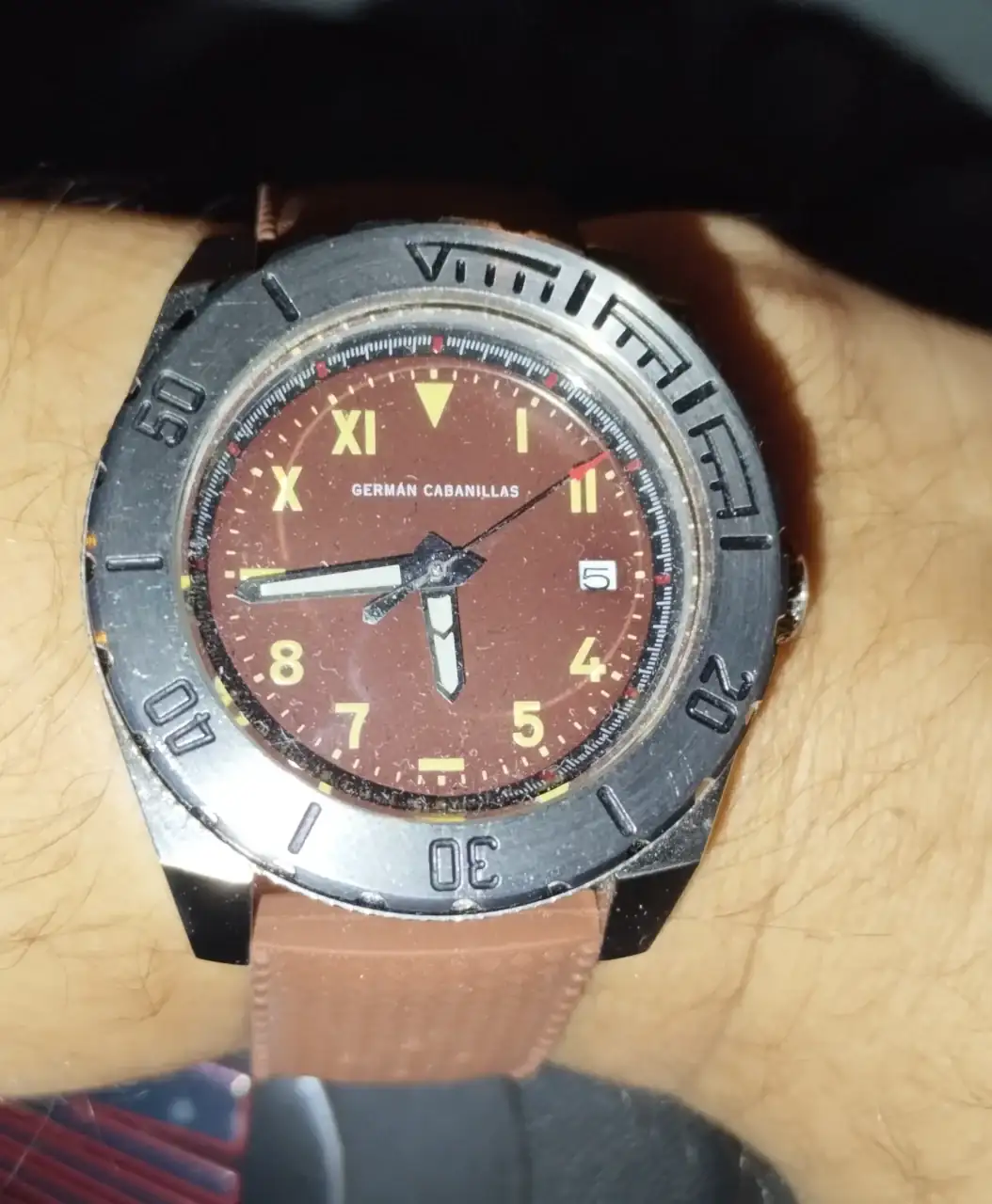

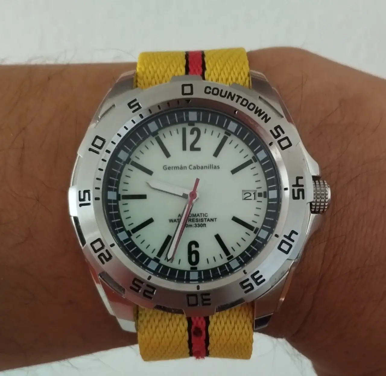

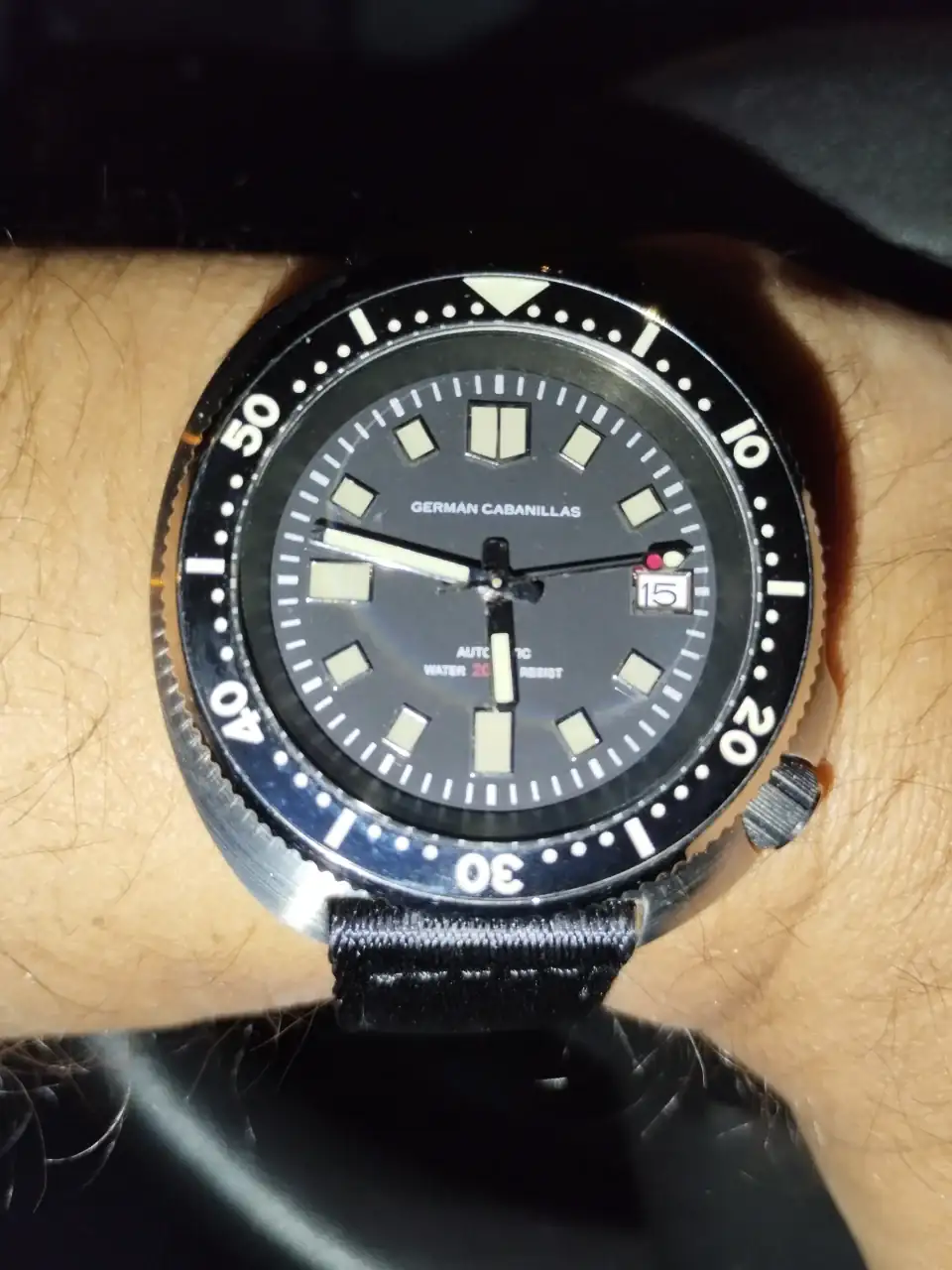

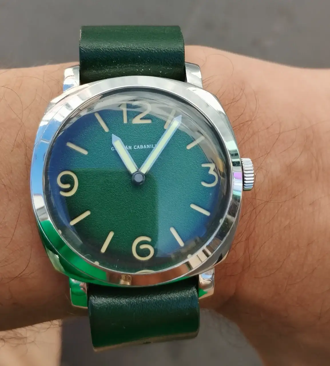

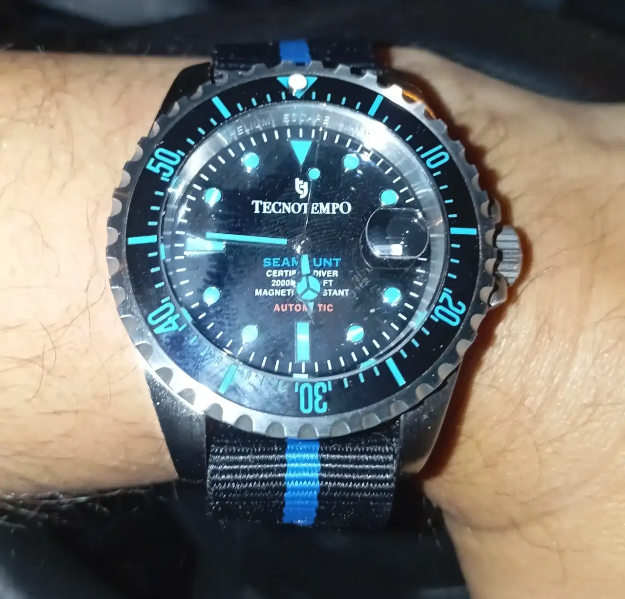

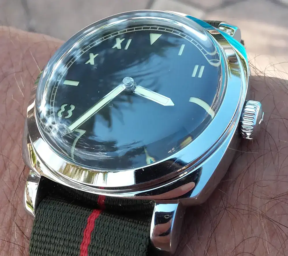

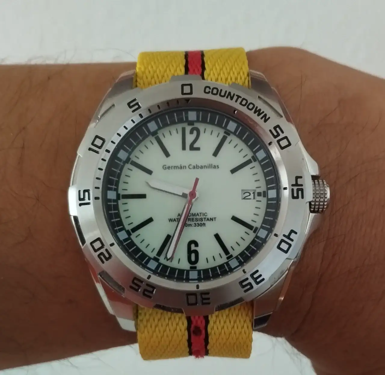

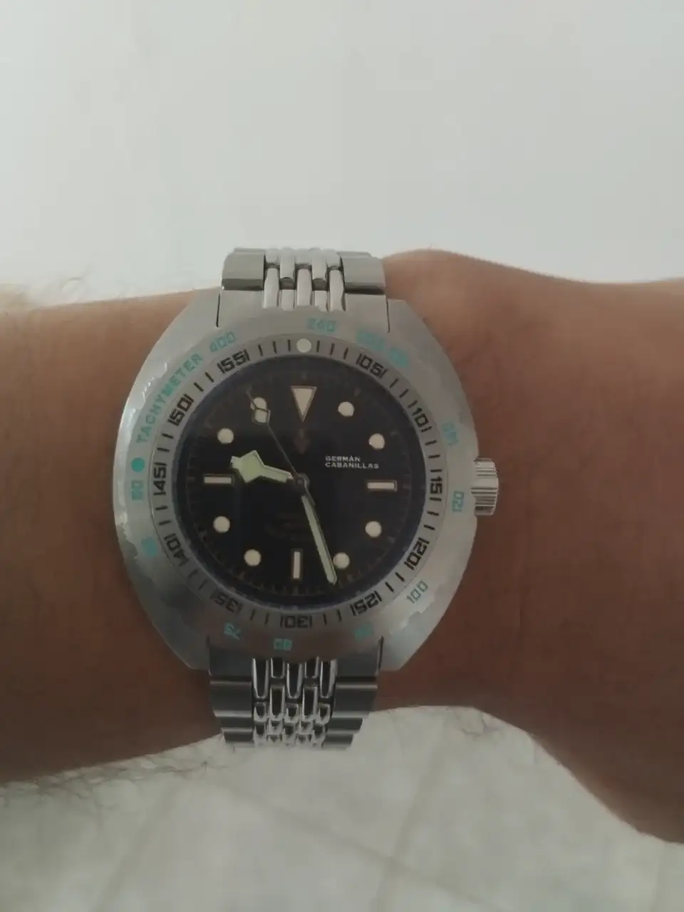

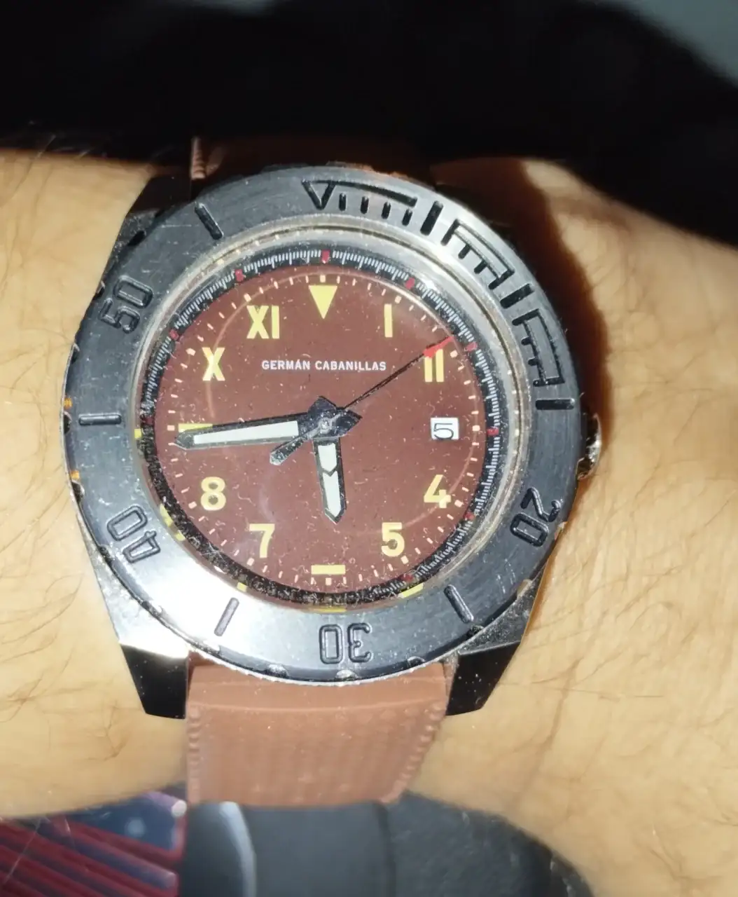

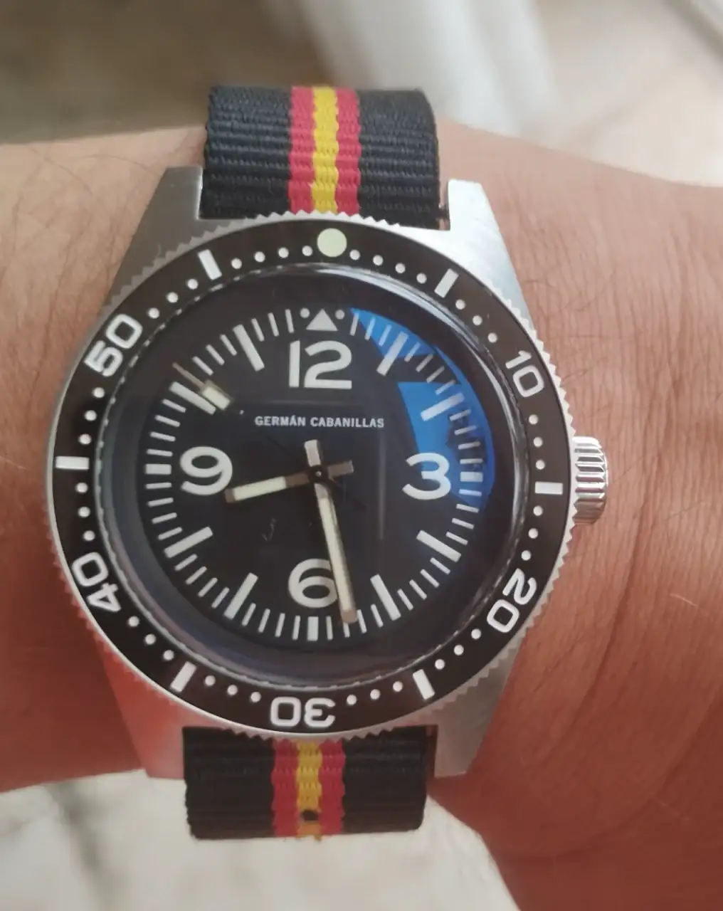

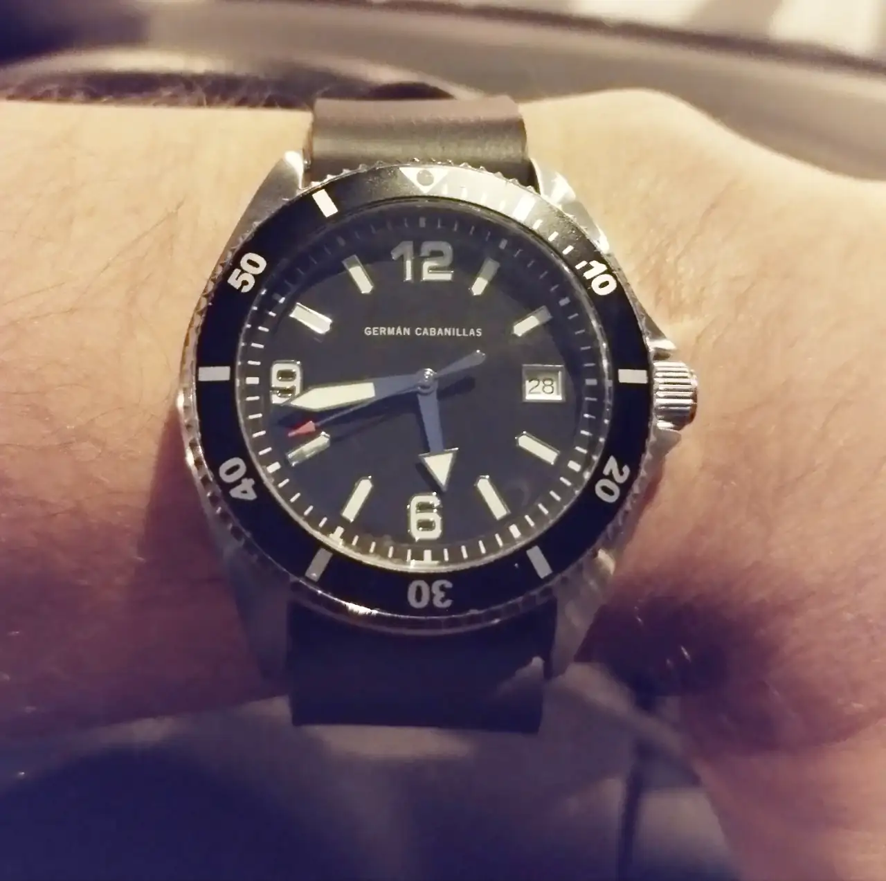

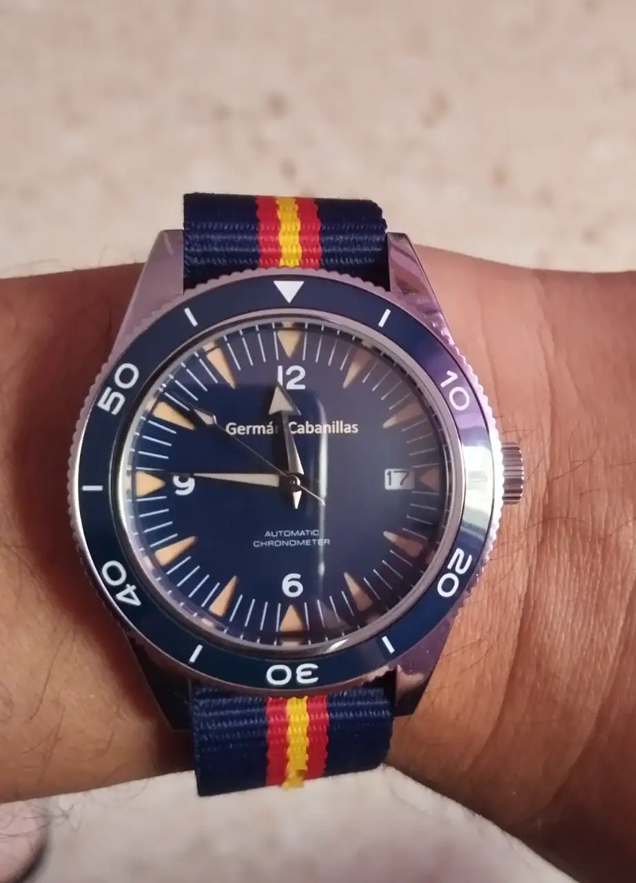

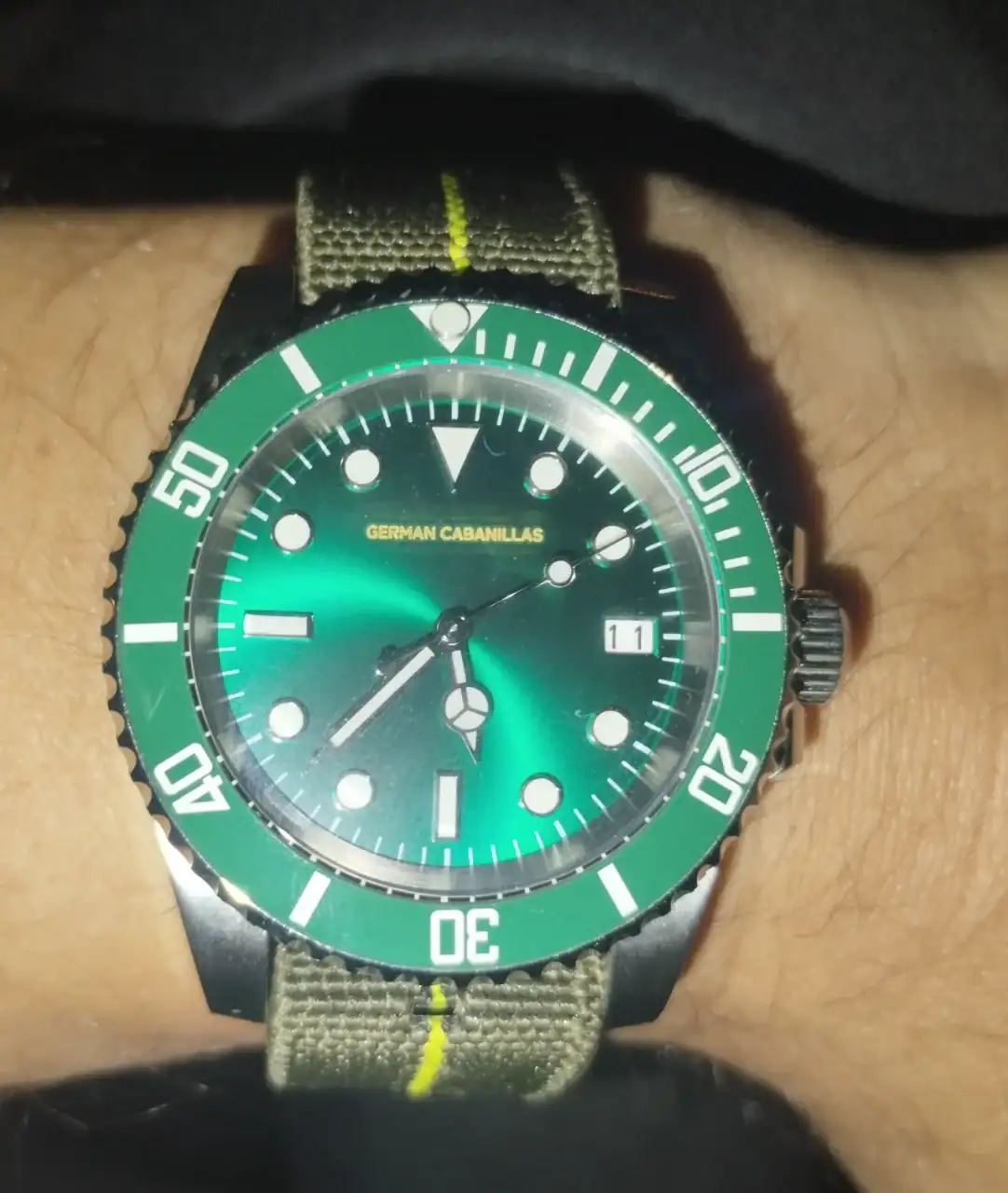

YO ( he tenido y aún) tengo varios relojes personalizados que usan ese calibre nh35.
Y solo puedo hablar bien de él.

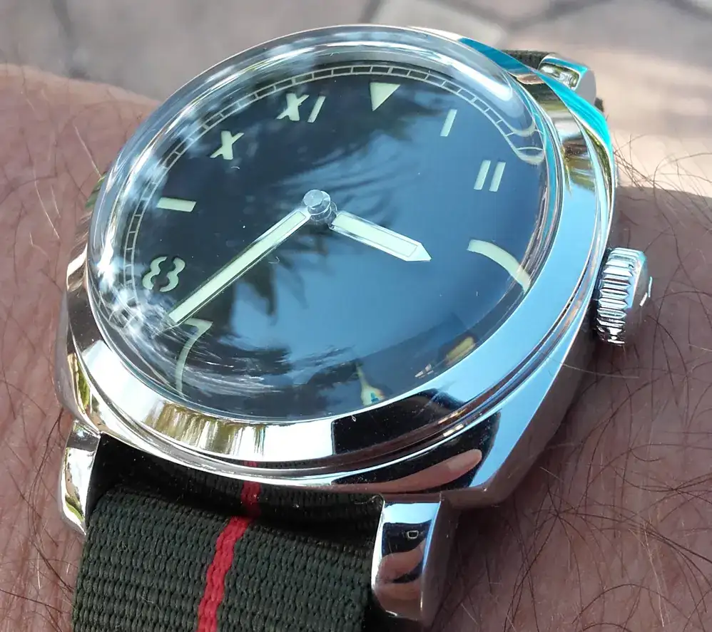

Mi último mod, con un dial y agujas de buena calidad, pero que voy cambiando de caja en caja porque no acabo de verlo:
El NH35 que lleva dentro con fechador negro lo pillé en una oferta de esas de aliexpress a 19,80 € es increible que puedan hacerlo.

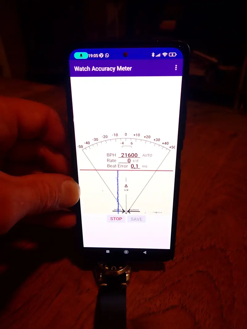

y este lo monté sin ponerlo en el timegrapher antes ni nada, me dije "voy a usarlo unos días para que se asiente y luego ya lo ajusto"
Pues de eso hace ya mas de dos semanas y da esos valores:
y los otros 5 montados con NH35 que tengo dan valores parecidos, aunque es verdad que a casi todos los he ajustado al recibirlos.

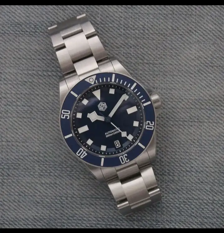

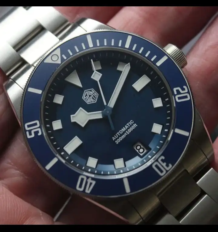

Hace décadas las empresas que fabrican esos movimientos, trabajaban para Seiko. Se crearon precisamente para hacer piezas y también luego, movimientos dedicados a terceras marcas y al que las quisiera comprar. No pueden poner Seiko porque no se permite por su política, pero sí bajo otra denominacion si lo hace TMI o SII.
Aquí todos hemos tenido Seiko asequibles, aquellos SKX y muchos más. Los mios nunca bajaron de 25 segundos. El Cadisen que tengo no pasa de 10 segundos. Tuve muchos invicta también, como todos, y alomejor alguno llegaba a 30 pero lo habitual es que no pasaran de 10 segundos al dia. Los vendí todos pero mi mujer si tiene un invicta aún, de SII y no pasa de 5 segundos. Tiene ya más de 10 años.
Nunca problemas y lo regalado por lo menos cinco con este movimiento a amigos, ninguno falla hasta hoy.
Observen la bata de metal en el San Martin !!!
Reacciones: AbderramanII, Josuegomez, Jose Perez y 5 más
