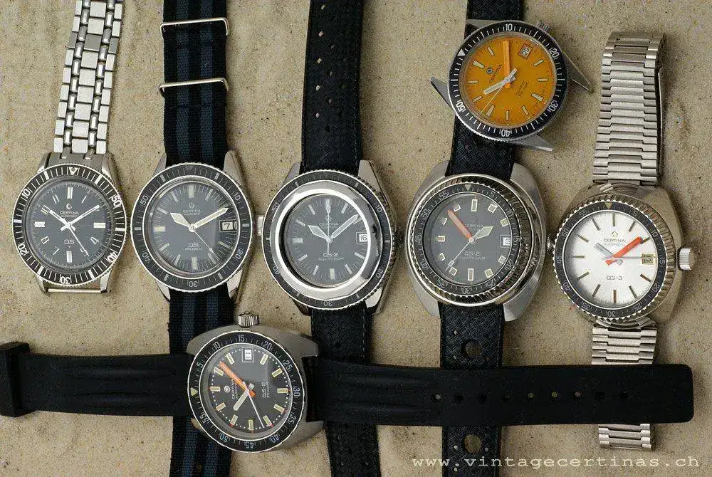

Por cierto, aqui una foto de un puñado de Certina divers, de Alinghi74 (de WUS forum) el señor de certinavintages.ch
De izq. a derecha >>
- DS Ref. 5601 113 from about 1965
- DS PH200M Ref. 5801 117 from about 1967
- DS-2 PH200M Ref. 5801 303 from about 1972
- DS-2 Super PH500M Ref. 5801 123 from about 1968
- DS-2 Super PH1000M Ref. 5801 302 from about 1970
- PH 100M Quarz 750 3008 41 from about 1980
- DS-3 300M Ref. 919 1402 41 from about 1976
Un abrazo
Alvaro
