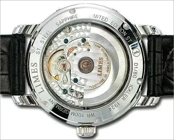

It wasn’t that long ago that when you purchased a New Swiss Made automatic Watch, you were guaranteed at least an ETA 2824 movement in it. While the ETA 2824 movement is by no means a rare or exciting automatic movement, it is reliable and can be very accurate in it’s highest level of finish. The ETA 2824 is used by a very large number of companies including Breitling, Hamilton, Oris, Omega, Tudor, Eterna, Tag Heuer and many many others including most of the German Brands.
ETA 2824-2 from a Limes Watch
After that came the Sellita SW200 movement, a direct copy of the ETA 2824 that is mostly made in Switzerland. While it is unknown how much of the parts are made in China, they at least come close to ETA in their quality. They are cheaper movements, and many brands including Invicta, Oris, Enzo and Eterna have begun to use the Selitta SW200 in their watches. I don’t mind the Selitta too much, at least it is somewhat comparable to the ETA-2824. The next step is a bit more disturbing.
