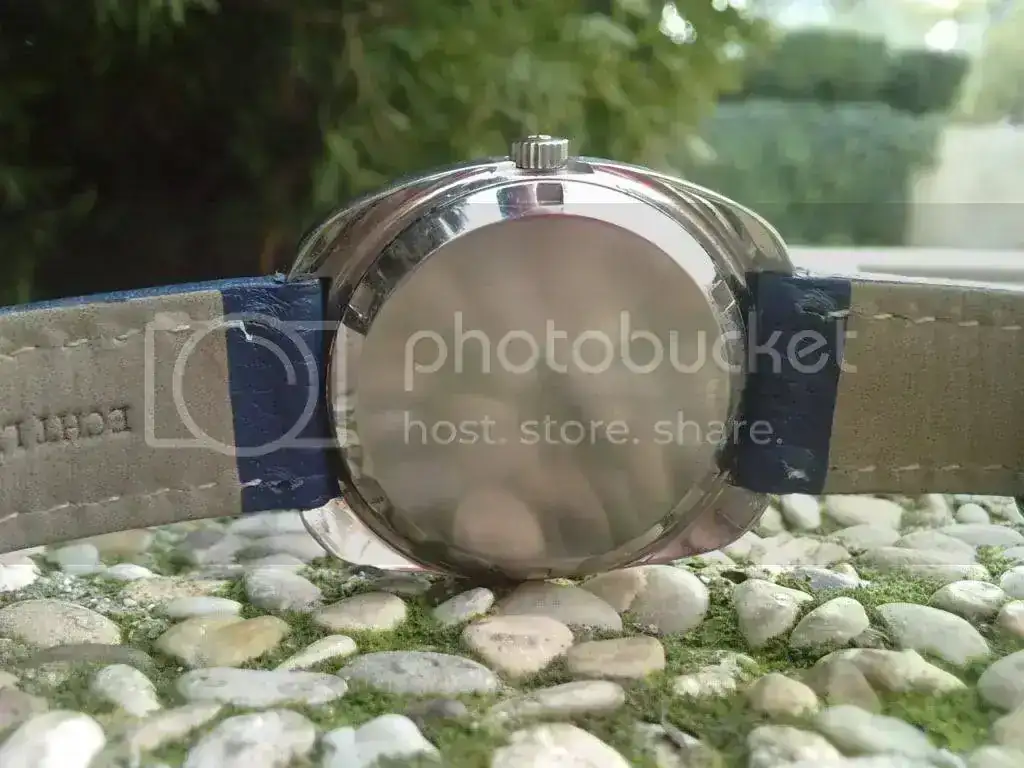

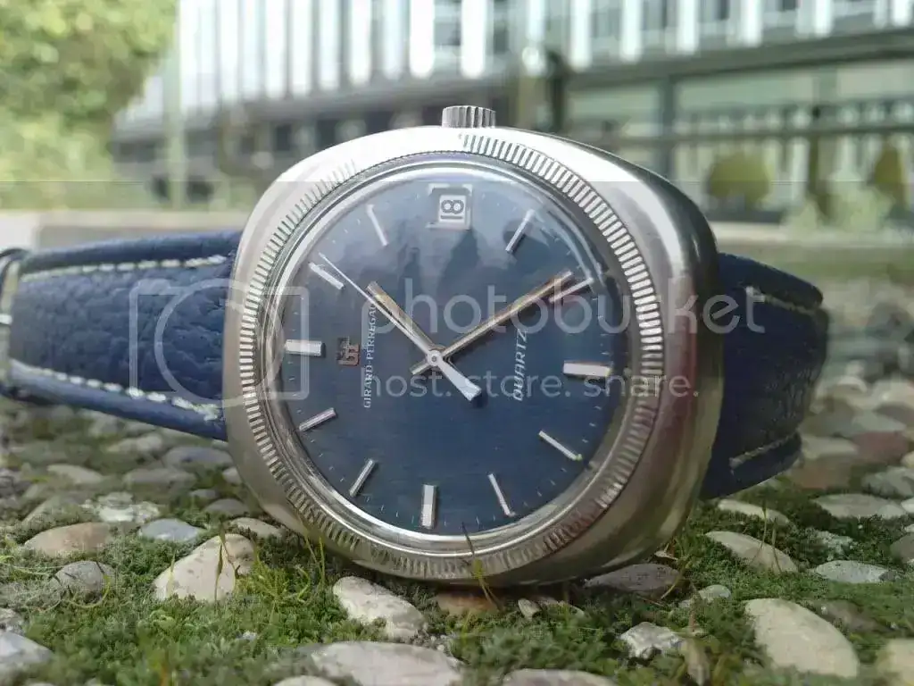

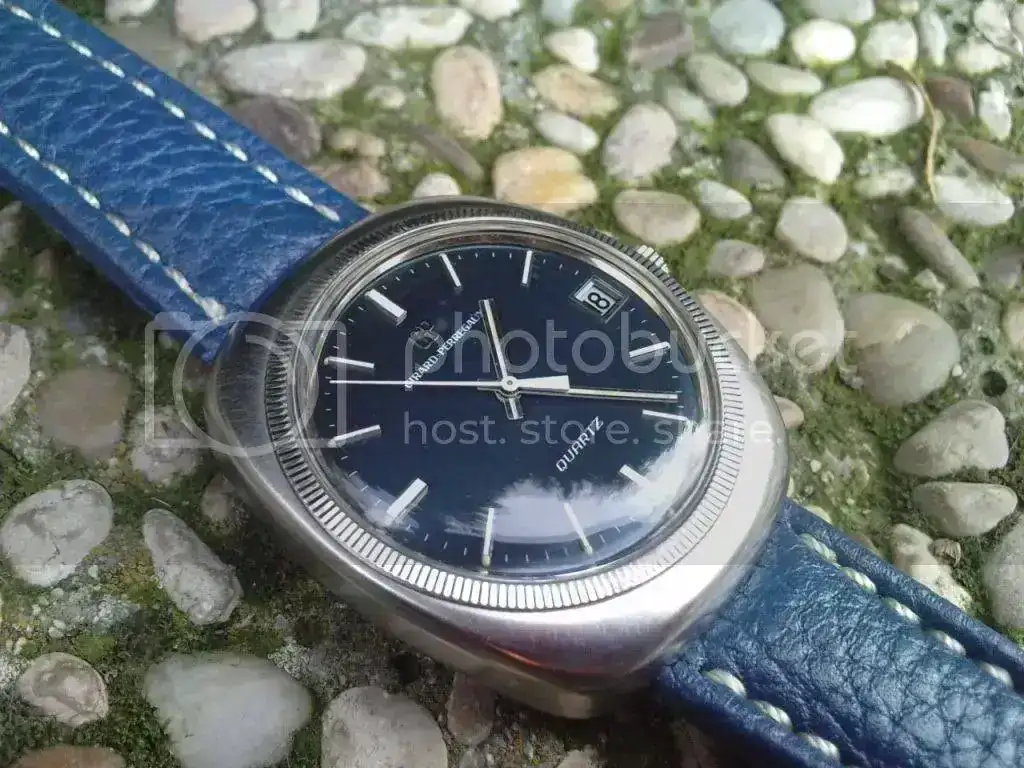

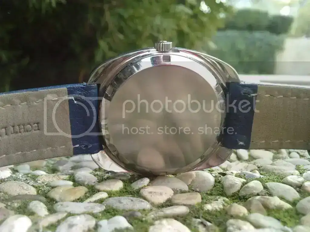

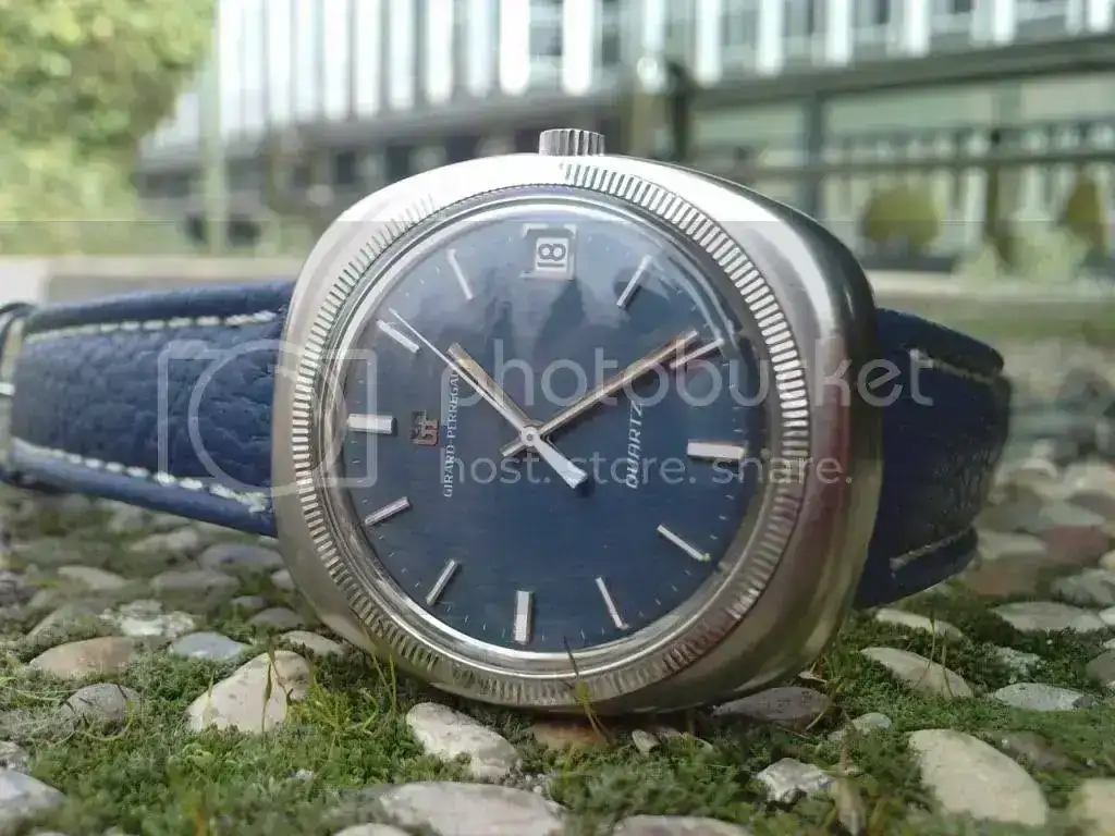

Yo contribuyo con un Girard Perregaux Quartz de 1970. Portador del calibre 352, que es una version menos complicada que el movimiento beta21.
Saludos!!

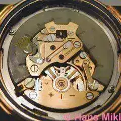

Hay la variante 4751
[SIZE=+1]Landeron 4750[/SIZE]
Features
electromechanically controlled balance motor
sweep second
Data
11.5''', Dm= 25.6mm
H= 4.35mm
12/13 jewels
f = 18000 A/h
Remarks
1960-1961
first electrical Swiss wrist-watch movement
early samples without excenter regulator (lower photo=
standard mounting frame Do=Dm=30.2mm (photos)
Example, year: signature; shock device

El Landeron 4750 fue el primer movimiento eléctrico suizo, que aparece en 1961.
El movimiento fue desarrollado por Landeron Branch of Ebauches SA (ESA), Neuchatel, Suiza.
Landeron 4750/51
"Ebauches S.A. (ESA) was the company that brought Switzerland its first fame in the production of electric wrist watches, when, after approximately ten years of research by André Beyner and René Besson, the Landeron '4750/51' was produced. Since most parts were manufactured at ESA's branch in Landeron, the watches were named the 'L 4750' and 'L 4751', the 'L' indicating the watches had been produced at Landeron. Swiss patents were granted under nos. 345611 and 346828 (1959). The movements were assembled by a few selected firms, amongst which Leonidas, at that time a well known chronograph factory. The batteries were the Mallory WD-4 or the rechargeable 15P 3.5, manufactured by Leclanché.
1959April 20th, application for patent no. 346828 CH is filed.1960At the end of 1960, the 'L 4750' movements come into production.1961April 15th, the first complete watches with the L 4570 are shown at the Basle Fair.1961The second version, the 'L 4751' comes into production. The start of sales of the much thinner and cheaper Lip R 148 signalled the halt in the production of the 'L 4751' already six months after the latter was first introduced. At this time, about thirty watch manufacturers sell watches with this movement amongst which: Favre Leuba, Benrus, Borel, Camy, Rotary, Royce, Eska, Avia, Admiration, Admes, Schild, Onsa, Huguenin, Gruen and Pontiac (Pontilectric). Two different models of the L 4750 were produced. One with a small dry cell, the other with an accumulator built in the back of the case, which needed recharging every six months by use of a simple flashlight battery of 1.5 Volts. To do this one had to pull off one of the two crowns and connect the flashlight battery to the watch case. A special shaped instrument, to connect the watch with the battery, was sold together with the watch. The 'L 4751' was a slightly modefied version of the above and only produced in the dry cell version. Improvement of the watch led to an increase in the battery's life span, a decrease of problems with magnetic fields and the addition of a stopping device, which stopped the balance so that the time could be accurately set. A demonstration model, the 'Montre ê Couilles', was also manufactured, containing two batteries of which one is a reserve battery. The back of the watch is transparent."
Parece que estos que hablan aqui, no son los que te muestro yo, estos estan desarrollados a partir del LIP, con un Diodo, sin transistor, que todavía no estaba en el mercado. Los que te mostre yo, el Longines en concreto son otra tecnica desarrollada a partir de la Licencia de Ato con un transistor y doble bobina, lo que me hace suponer que estos anunciados, junto con los LIP y Los Hamilton, fracasaron rapidamente.
Familia Lip, con Diodo - RELOJ ELECTRICO
Familia Ato, con transistor, RELOJ ELECTRONICO
Los Dynotron, estan referido a los desarrollados bajo la patente ATO, mañana te busco ese material.

Hola Rafel, ya lo he encontrado, esta en el mismo calibre Longines mostrado en el mensaje anterior, bastante escondido. LIC. ATO
Creo que definitivamente estamos hablando de cosas distintas, el reloj electrico, solo tenia un diodo, como el Lip y el Hamilton, y posiblemente este Landeron, que tuvo poco resonancia ya nacieron obsoletos, de hecho mira las marcas que lo montaron..... Creo que Sakarino tiene uno en Valencia que no funciona, estas alimentados con 2 pilas.​
Mientras que los Dynotron, estan desarrollados bajo la licencia Ato, funcionaron perfectamente, aún funcionan casi todos, estos si fueron incorporados por grandes firmas, casi todas en algún momento hasta que se desarrollo el Mosaba (Montres Sans Balancier), por Hetzel y el grupo Suizo, que finalmente fueron pleiteados por la Bulova que gano la demanda y les obligo a poner Lic Bulova y a pagar la licencia.​
Incluso he encontrado uno con 19 Rubies, un Bucherer, Ajustado 5 posiciones y Temperatura, de la máxima calidad en este sistema.
LOs movimientos que incorporo Longines son estos últimos, en el capitulo de Relojes Electronicos.​
Una Abraçada.​
