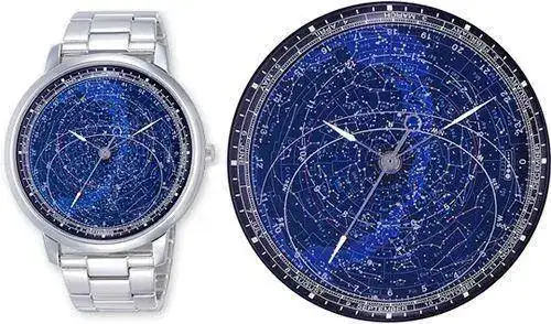

Yo añadiría este Citizen Astrodea más económico (eso sí, es cuarzo):

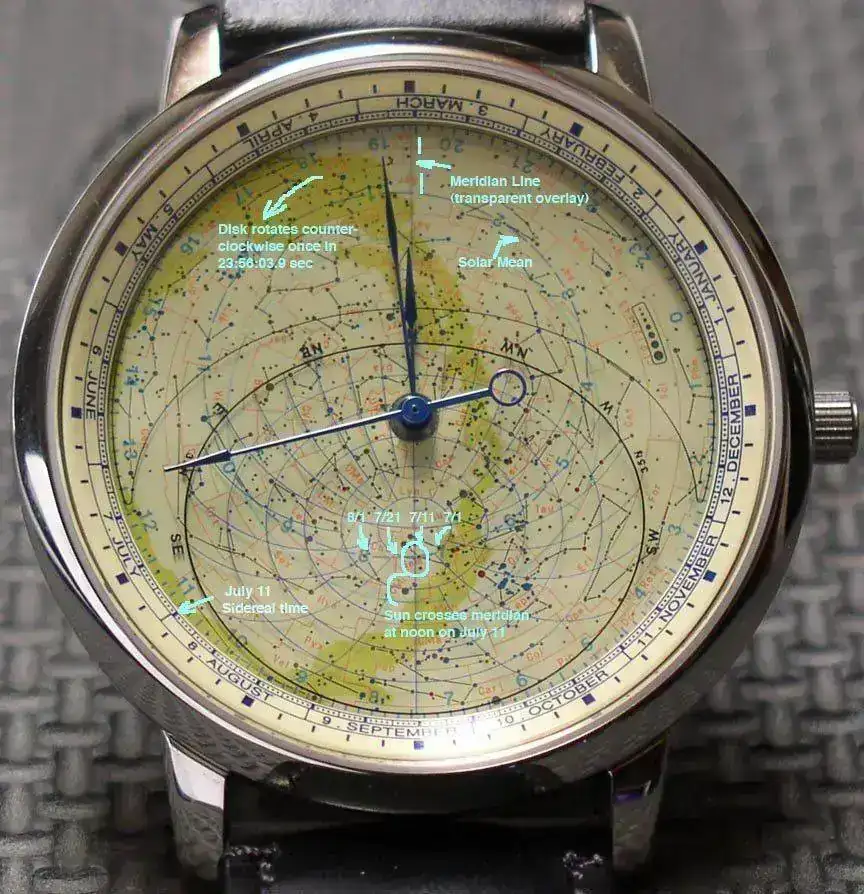

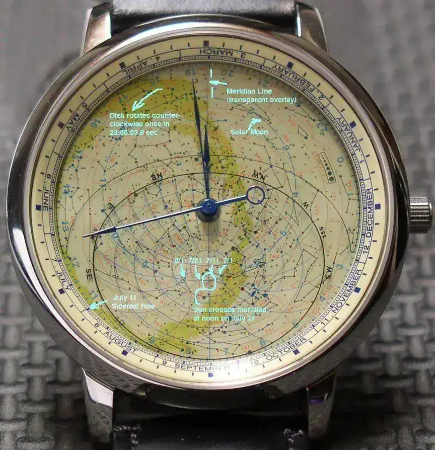

The main face of the dial shows the planisphere disk, and it moves in a counterclockwise direction, marking the sidereal day. It turns once every 23 hours, 56 minutes, 3.9 seconds (This would give a built-in error of about .2 seconds per day, probably limited by crystal oscillation rate and gear ratios, and is smaller error than the rated accuracy of the quartz movement at ±20 sec/month.) It moves counterclockwise because it shows the relative apparent motion of the sky opposite to the earth's clockwise rotation. This main dial has a huge amount of information packed onto it, including major constellations, visible objects of magnitude 4.5 and brighter, their different color types, and the sidereal hour markers around the edge. It also shows the solar mean disk marked with the numbers of the month. I found this solar display to be the easiest way to set the watch.

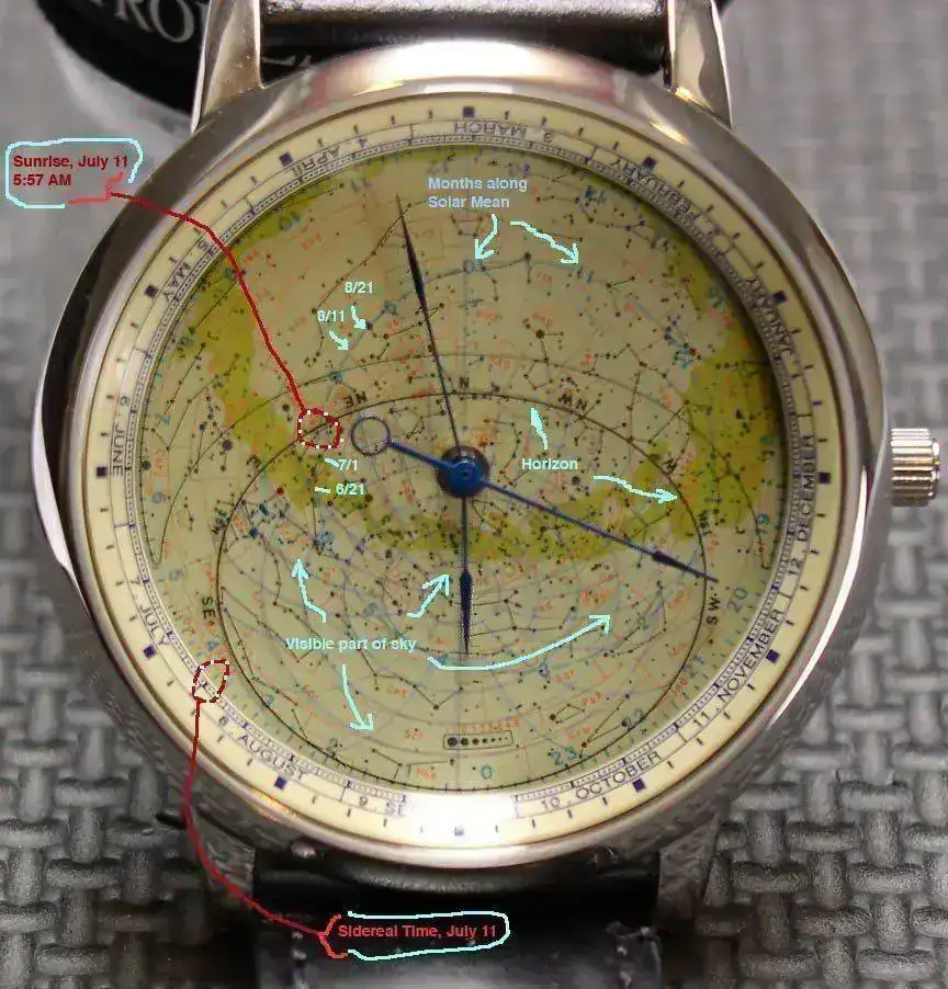

An easy way to set the star chart:
I must confess that I got a bit confused trying to understand the different approaches to using and setting the planisphere disk. Because it doesn't turn at the same rate as the 12 hour hands, it soon becomes clear that we need a calibrated start point, so the dates make sense along the edge as sidereal time slips earlier by 4 minutes each day. You can do this by calculating the longitude where you are standing, subtract 4 minutes per degree from 0° longitude (Greenwich) then find the correct settings for January 2 of the year. That gets really complicated.

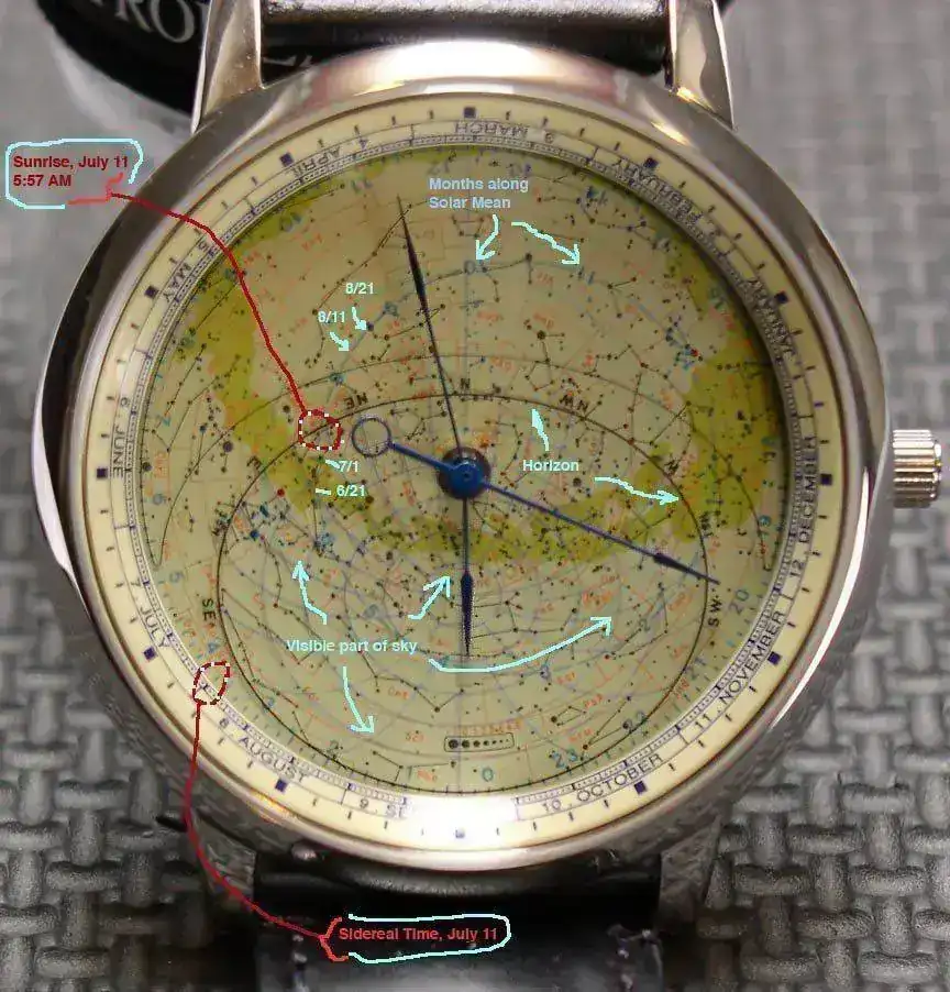

I found a little gem hidden away in the technical manual for the Citizen 4391 watch caliber. It explains a short cut using the date markers on the Solar Mean disk and published sunrise information for your current location. Here are simple steps:
1) Look up the sunrise time for your city, for today's date. Websites will show this, as will the weather page of a newspaper (remember those?)
2) Pull the crown all the way out, and set the hands to reflect the time of sunrise. In my example below I use July 11, 2011, with sunrise at 5:57 AM.
3) Look closely at the light blue Solar Mean disk, and you will see numbers from 1-12 corresponding to the months, and gaps in the line, between the month numbers, corresponding to dates 11 and 21.
4) Push the crown all the way back in, and then pull out slightly to the middle position to rotate the star disk. Rotate the disk counterclockwise until today's date on the Solar Mean lines up to the Eastern horizon line, corresponding to sunrise.
5) Pull the crown back out all the way to time-setting position, and back the minute hand up by about 20-30 minutes, then move the time forward again, back to sunrise (5:57 in the example.)
6) Check the solar mean to make sure it didn't slip after this time adjustment. Repeat the above procedure if it did slip. Once satisfied, move the time ahead to the current time on the same day.

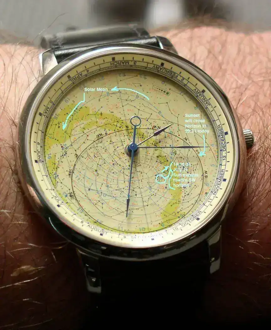

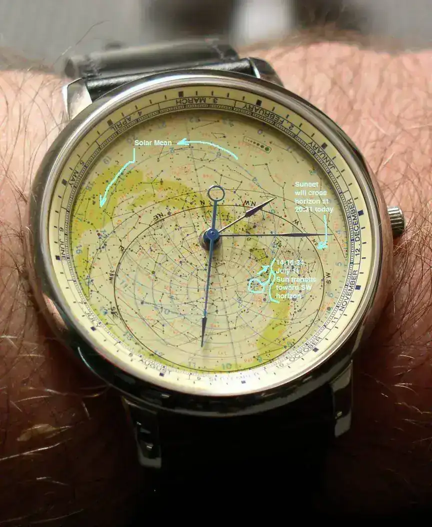

You can see from the pictures below that once I set the correct sunrise time for my date, I can track the position of the sun from the watch dial by tracking the motion of today's date, on the Solar Mean disk, as the watch face turns. At noon, you can see that 7-11 (July 11) crosses the meridian line close to the zenith. Later, at around 2:15 in the afternoon, it has moved towards the western horizon, and it should cross the sunset line (WNW) around 8:31 PM.
As the seasons progress, I will see these times change as the earth's position changes relative to the sun. In the meantime I can locate today's date on the outer chapter ring, and learn what the current sidereal time is relative to UTC. That would be useful if I wanted to calibrate a telescope, for example, or decide when to send a satellite into space.
I hope this didn't completely bore you. I thought a resource like this might prove helpful for those nutters like me who enjoy these sorts of toys.
All the best - Robert
    75,5 KB · Visitas: 92
    87,5 KB · Visitas: 79
    69,6 KB · Visitas: 85
