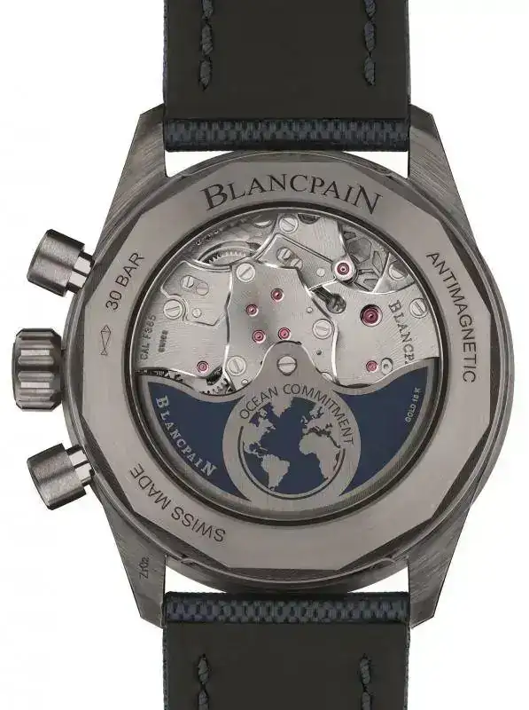

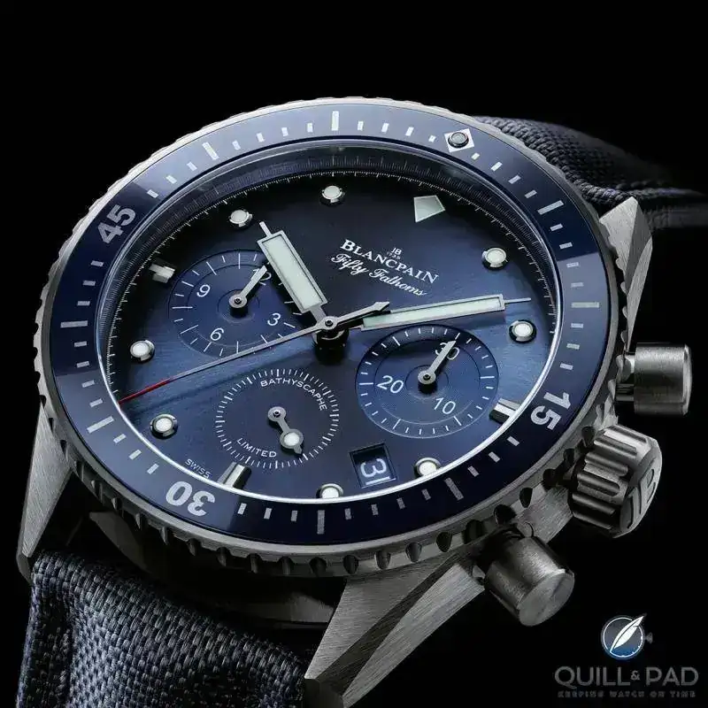

Y hay muchos otros a 36.000:
Blancpain F385 Caliber
“I’ve discussed this caliber at length before, but here’s a quick recap. The Blancpain caliber F385 is a column wheel flyback chronograph movement that runs at the high frequency of 5 HZ (36’000 vph), with each second is perfectly divided into 1/10th of a second intervals. The F385 is further distinguished by its use of silicon for the balance wheel spiral, which allows both protection from magnetism and a view of the movement (as opposed to use of an amagnetic iron inner case which obscured the movement). In common with all of the 33 new in-house calibers which Blancpain has introduced since 2006, the F385 has a freely sprung balance, with gold screws for fine regulation. Gold screw inertial regulation offers superior robustness and finer adjustment than the more common racket systems.
The F385 utilizes a vertical clutch for the engagement of the chronograph. Blancpain has been an industry pioneer in the development and refinement of vertical clutch chronographs. Unlike horizontal clutch systems used elsewhere, Blancpain’s vertical clutch guarantees flawless starting and operation of the chronograph. Horizontal clutch systems are prone to needle jumping upon starting and uneven movement of the chronograph seconds hand, both of which are avoided with Blancpain’s design systems.”

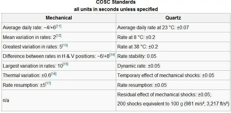

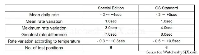

Un 3135 tiene parametros COSC(ese certified chronometer superlative bla bla bla es marketing, un Rolex 3135 tiene los mismos parametros que un MIDO ó un Tissot COSC)
Los GS tienen parametros mejores que COSC. Y si es un GS Special, aún mejores.

La precisión del GS es de -3/+5 seg/dia.
Sobre la resistencia magnetica, no se cual es la de Rolex, pero la de GS es de 16,000a/m(recuerdo que algunos suizos de muchos miles de euros hacen gala de 15.000a/m en sus diales...), y para tal tiene un dial totalmente hecho en hierro puro.
