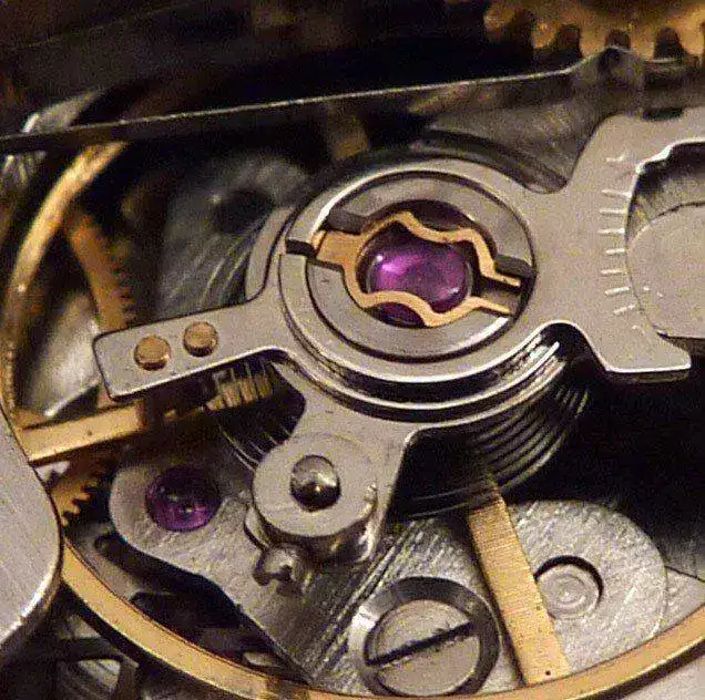

for example, my spring, back of the stud, is much more smashed than this one:
(picture borrowed from this post: https://relojes-especiales.com/threads/revisión-de-un-reloj-slava.257081/)

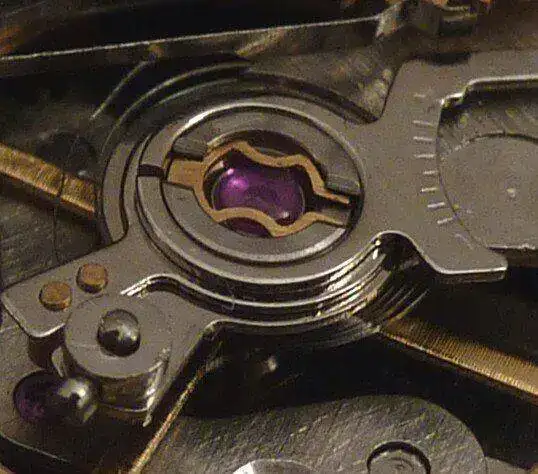

By the way: here is the picture. As you can see, beyond the stud there are no coils, as they're compressed near the axe of the balance wheel.
I have to try to regularize the shape of this spring.
Suggestions?
ok, after some tryes and work with tweezers I could manage to ply it and have a little better shape. At least now it runs slower, before i couldn't manage to slow it down, whatever the regulations I did, it was always too fast. Now it runs a little slow, so now it's a matter of the chrono comparator.

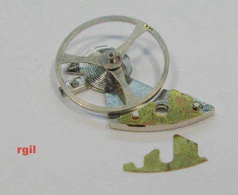

Sorry. I do not speak English. This is a machine translation.
The spiral is extremely delicate.
To get an idea. The spiral (photo from Slava,) is perfect.
The shaft is supported out of its housing and that makes it look asymmetrical.
Sometimes I worked correcting spirals.
https://relojes-especiales.com/threads/una-reparación-en-el-volante.28135/
https://relojes-especiales.com/threads/enderezando-la-espiral-torcida-del-segundo-seiko-6309.153297/
At the end, has always been better to get the spiral shaft
With the coil attached to the shaft, it is almost impossible to see where the twisted.
The result is always unpredictable, so it is better, first try demagnetizing and cleaning oil

What is see is:
The mobile stud carrier is far away from the balance bridge,
Also is too close to the regulator.
Try tomove the mobile stud carrier back a bit, towards the balance bridge (anti-clockwise)
and separate the regulator, in opposite direction,
Perhaps, that should do the truck.
regards,
Alvaro
I've tryed but the result is not good, I'll be better to wait and put it on the cronocomp.
