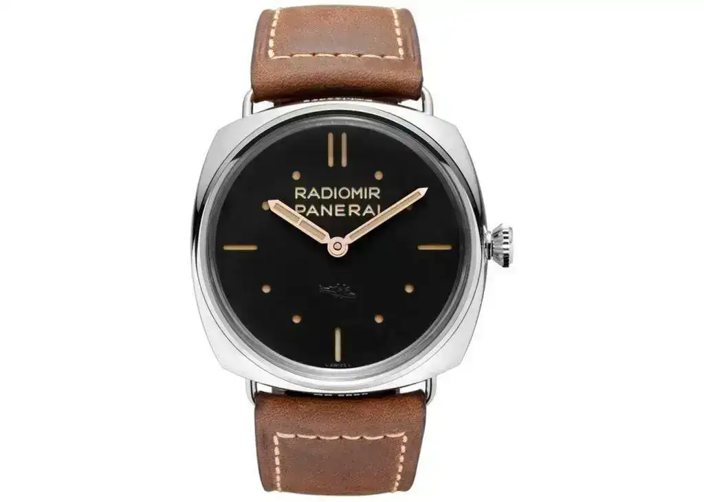

a mi me recuerda el dial al del Radiomir Siluro a lenta corsa S.L.C Pams 425 o 449 con el cristal abombado

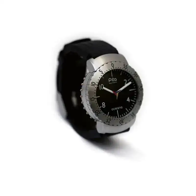

OCEANA TITANIUM
Extreme Features, Sleek Design
Oceana is the ultimate sports & dive watch: water resistant up to 5000 meters.
Two patented systems for a water-entry free case: Pita-TSM (Time Setting Mechanism) and Pita-RT (Remote Transmission).
No crown, no back cover, no weak points.
8.2mm thick rounded polycarbonate crystal.
No seal joint between crystal and steel case, maintenance-free.
Each timepiece is handmade in Barcelona by the AHCI Master Watchmaker, Aniceto Jiménez Pita.
Qué se sabe de este proyecto??? Me gustaría saberlo
