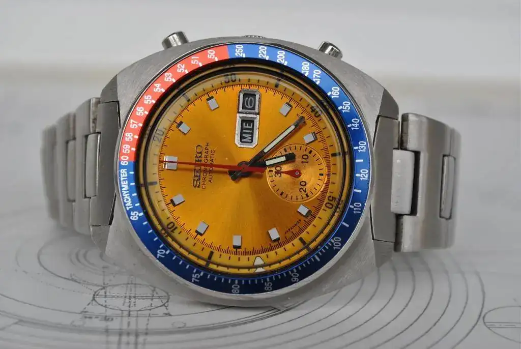

A las buenas mañanas, ayer adquirí (esta viajando a través de la península hacia mi casa) este ejemplar de bicho:)
Se que no lleva carga manual y que el pase rápido de fecha es pulsando a diferentes intensidades el pulsador:hmm:
Alguien sabe más cosas y particularidades sobre este mecanismo que creo es 6139b?:light:
Alguien más lo tiene por aquí? Que me pueden contar? Gracias

Fernando, hola.
https://thespringbar.com/blogs/guides/the-seiko-6139-600x-collectors-guide/
[TABLE="width: 100%"]
[TR="bgcolor: #F8C8C8"]
[TD="width: 250"]
Fig. 1
Fig. 2
Fig. 3
Fig. 4
[/TD]
[TD="bgcolor: #FFD2D2"][SIZE=+1]Seiko 6139B[/SIZE]
Features
automatic chronograph, 60s, 30min, pillar wheel
no manual wind
day: quickset by pushing the crown deeper, 2 languages
date: quickset by pushing the crown less deep
Data
12''', Dm= 27.0mm, Do= 27.4mm
H= 7.2mm
(dial spacer +0.2mm)
17/21 jewels
f = 21600 A/h
power-reserve 45h
Balance staff Seiko 315611
Stem Seiko 354617 / Seiko 357612
(normal/divers)
Mainspring / battery
Seiko 401616
Hands
1.50 x 0.90 x 0.26 / 0.26mm
Comments about the data[/TD]
[TD="width: 40%"]
Remarks
1972-1979
sophisticated excenter self-winding mechanism with just one gear stage (Fig.4)
like 6139A, only minor modifications of switching mechanism (dial side)
family/generations:
* ) quickset, turning crown (else pushing)
**) day in 2 languages
manual wind, 21600 A/h:
6100A: -
6102A: date
6110A: like 6100A, Railroad Watch
automatic, 21600 A/h:
6105A: date*
6105B: date*, hack feature
6106A: day, date, hack feature, 2 rotor screws
6106B: day, date, hack feature
6106C: day**, date, hack feature
6109A: day, date, smaller rotor
6117A: date*, GMT 24h
6117B: date*, GMT 24h, hack feature
6118A: date*
6119A: day, date, 2 rotor screws
6119B: day, date
6119C: day**, date
chronograph, 21600 A/h:
6138A: hour counter, day*/**, date*
6138B: same, modified switching mechanism
6138A: day**, date
6139B: same, modified switching mechanism
automatic, 36000 A/h:
6145A: date, Grand Seiko
6146A: day, date, Grand Seiko
6155A: date, GS Special
6156A: day, date, GS Special
6159A: date*, Diver 300
6159B: date*, hack feature, Diver 600
6185A: GS Veri Fine Adjusted
6185B: dito, hack feature
6186A: day, date, Unruhstop, GS Veri Fine Adjusted
Example, year: signature; shock device
1973: Seiko Time Corp., Seiko, Japan, 17 Jewels; Diashock[/TD]
[/TR]
[/TABLE]

Los hay a patadas y es un buen elemento como casi todo lo que hizo Seiko. Muy fácil de mantener, se desmonta, se limpia y se engrasa con facilidad, con un curioso sistema de embrague del segundero central que si se quiere puede estar todo el tiempo funcionando ya que no sufre con ello.
Es lo que te puedo decir de la parte técnica; de la estética ya te dirán los que saben de ello.
Que lo disfrutes en cuanto te llegue.

Gracias, ya me imagino por lo que leí que la máquina es muy fiable y que la estética depende bastante de su tiene piezas after market y tal, no me preocupa demasiado yo siempre he comprado los relojes por la maquinaria
