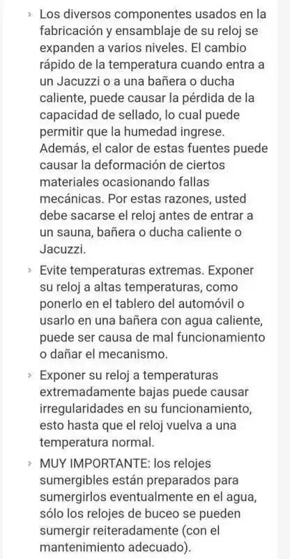

Te dejo extracto de la garantía de seiko, puede valer para cualquier reloj.
Ver el archivos adjunto 804266
Si, pero no pone que sean precisamente las gomas. Puede que hayan dilataciones del metal o vete tu a saber.
En cuanto a las gomas:
STEM
The stem gasket needs to seal in a semi-dynamic environment. The winding of the crown will cause the sealing area to rub, so the gasket needs to withstand abrasion. In addition, in screw-down crowns, the upper seal needs to withstand numerous compressions and de-compressions and still remain springy, ie have good compression set properties. Resistance to hydrocarbons (fuel, oil etc) is not really that important, unless you regularly store your watch in gasoline. Similarly, resistance to UV, high temperatures (over 200 F), and ozone are not required for the following reasons: UV - watch gaskets are not stored or exposed to UV for extented periods of time, unlike the rubber seal around your car window, high temperatures, by high temperatures we are talking about 200F and above, and lastly ozone which affects the service life of the rubber, but generally speaking, all rubbers will last 10 to 20 years, unless you store your watch near a large ozone generator, such as a huge generator. We will look at gas impermeability and saturation diving later.
