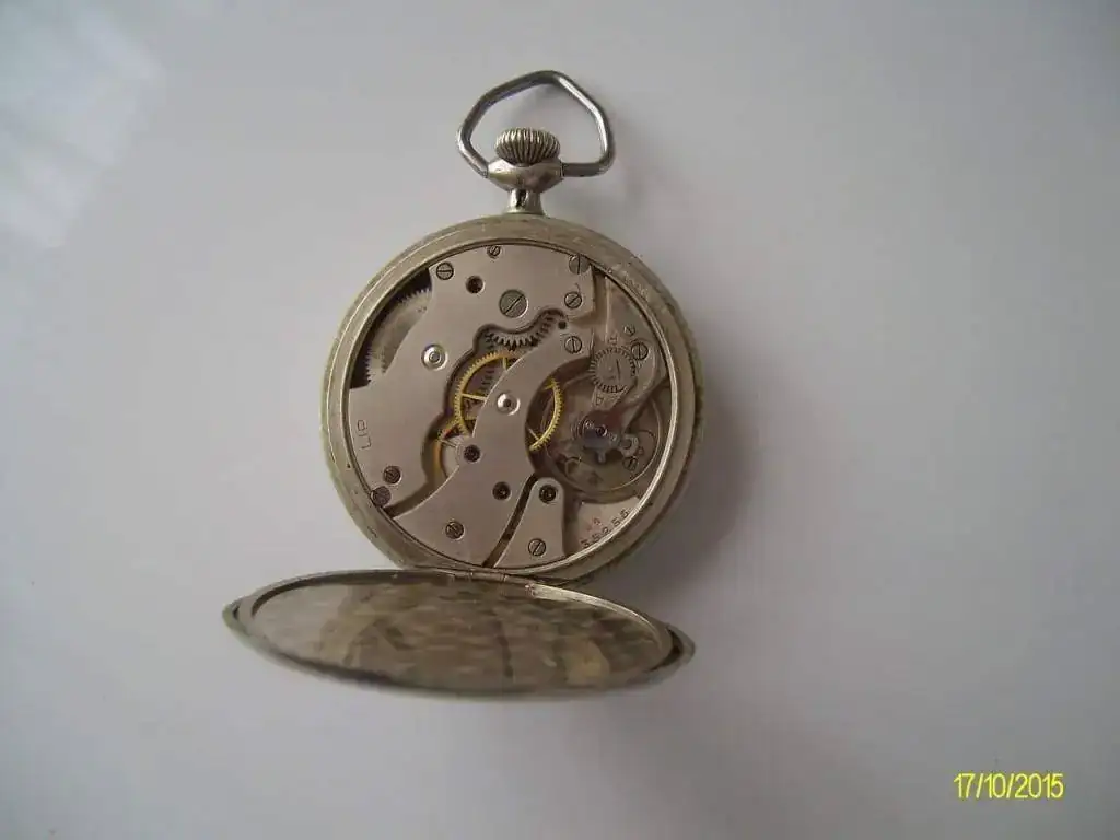

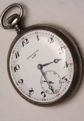

Presento un LIP de bolsillo no tengo idea de que año .En esfera pone cronometro .

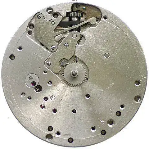

stepona, según el tamaño del calibre será un nº u otro. Me llama la atención los números que se ven. Puedes decírmelos.
[TABLE="width: 100%"]
[TR="bgcolor: #F8C8C8"]
[TD="width: 250"]
Fig. 1
Fig. 2
[/TD]
[TD="bgcolor: #FFD2D2"][SIZE=+1]Lip 39.2[/SIZE]
Features
stem wind and set
sub second
Data
17.5''', Dm= 39.0mm, Do= 39.55mm
H= 5.4mm
F= 0.5...0.6mm
T= 2.0mm
15 jewels
f = 18000 A/h
power-reserve 31h
Balance staff U1012
Stem W1512
Mainspring / battery
Zf3471, 2.00 x 14.0 x 0.18 x 390mm
Hands
1.75 x 1.00 / 0.29mm
Comments about the data[/TD]
[TD="width: 40%"]
Remarks
open face calibre
Breguet hairspring
differences not known between 39.2, 39.3
family:
39.2, 39.3: 17.5'''
40.2, 40.3: 18'''
Example, year: signature; shock device
ca. 1940: 328318, Lip, 393
(Lip 39.3)[/TD]
[/TR]
[/TABLE]

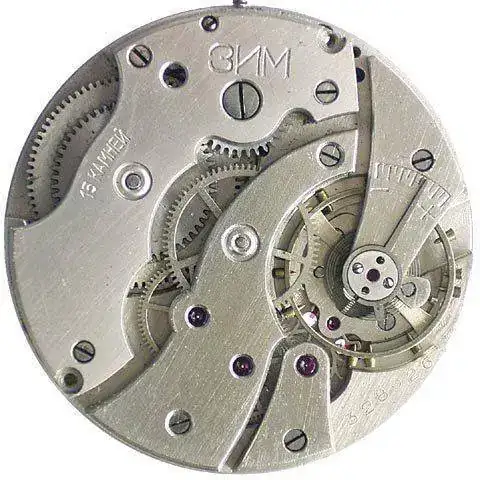

no descarto que pueda ser este. LIP 43.2
[TD="width: 250"]
Fig. 1
Fig. 2
[/TD]
[TD="bgcolor: #FFD2D2"][SIZE=+1]ZIM Salut (Lip 43.2)[/SIZE]
Features
stem wind and set
sub second
Data
17.5''', Dm= 42.45mm, Do= 43.2mm
H= 5.9mm
F= 0.5mm
T= 2.2mm
15 jewels
f = 18000 A/h
Balance staff U1951, Ronda 3545
Lip movements are poorly recorded, and ZIm movements even worse. The dimensions taken from the staff allow both, Flume U1951 and Ronda 3545 as replacement, although the dimensions slightly differ.
Stem W1609
Zf3423, 1.90 x 17.0 x 0.21 x 490mm
Hands
2.00 x 1.15 / 0.26mm
[TD="width: 40%"]Remarks
open face calibre
Breguet hairspring
if ever, then also listed as Saljut, Salyut), or yk-6
The few available sources agree only upon Lip as origin. Varying origin calibres are mentioned, only the Lip 43.2 not, although it is the only one with matching dimesions and layout.
Since catalog data are not available, they were taken from the Lip 43.2 as far as available. But some parts were modified after adopting the calibre from Lip.
ca. 1955: 328626, ZIM, 15 Kamnei (15 jewels)[/TD]
[/TR]
[/TABLE]
Resorte del tiret es diferente.

34 y 35253
pues no se que decir. Los mostrados tienen una numeración de 6 números y en el tuyo la segunda cifra solo tiene 5. Puede que sea anterior.

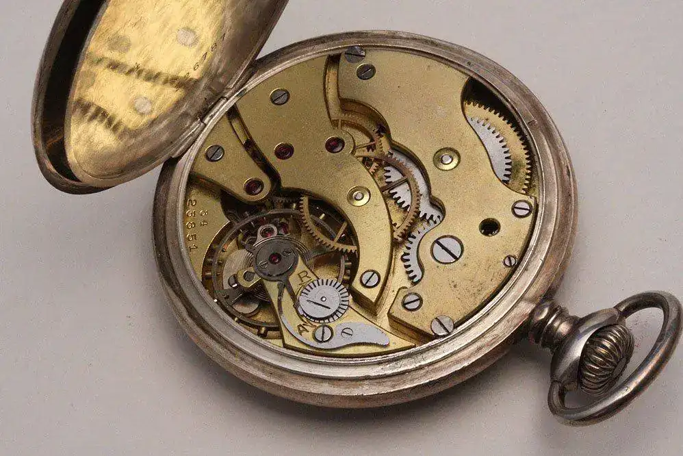

años 1920/30, este con serie 23.851
