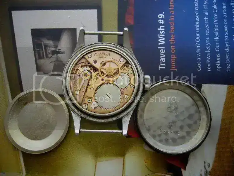

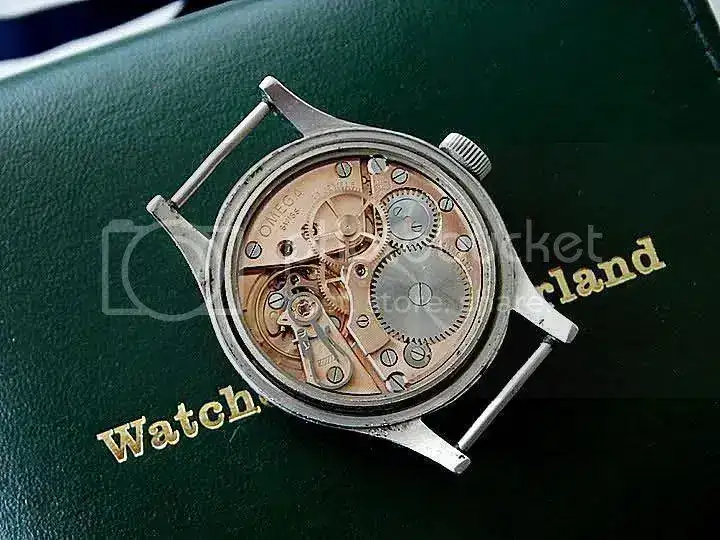

He visto un Omega calibre 283 con regulador micrométrico de 1953 que me ha llamado mucho la atención.
¿Cómo es posible, ya que no es un 30 T2 RG?, ¿se utilizó el este regulador en otros calibres?, ¿ es un matrimonio ?, ¿puede tener la categoría de cronómeter?
Hola Rafa, Ya lo ví, huele a chapuza, según Omega Museum, el reloj llevaba una 283 monda y lironda :
Bueno, yo también lo comprobé, será un Omega modelo Gabacho.
Saludos y un fuerte abrazo.

Hola Rafel,
Te pongo la respuesta de Omega sobre estos relojes a un señor:
* the OMEGA mvt N° 14'158'9xx is of caliber 283 - special adjustment
for " chronometer rating " ( but not officially certified ! )
* the case of ref. CK 2777 is the special construction , exclusively
delivered up to 1953 to the pilots of the RAF, and which has the inside
protection mumétal cover.
* it looks like that we had too many cases in stock of the ref. CK
2777 and which were then in 1955 no longer required to be delivered to the
British Army... hence we had converted these " RAF " to another special
version, i.e. the ref. CK 2777 - with the original movement with "
chronometer special rating " of cal. 283.... but fitted with a dial marked "
Railmaster " and delivered to our Agents in Canada.
* What is not possible to clear up, is why this " special " has been
made.
* We anticipate that we had, at those days, a huge quantity of cases,
which were not introduced in the " International Collection " , hence not to
be used as a " normal " item of the Collection. The " Railmaster " version
was then made perhaps as only for the Canadian Railroad, with the white dial
and the hands looking different from the RAF watches ...
* Therefore, the movement with a special regulator is a " novelty "
under the version of cal. 283, but indeed genuine !
* For your information, your watch has been delivered ( strangely...)
under the ref. CK 2777 ( wonder why using the same ref. as for the RAF...! )
to Canada, on October 24, 1955.
* The tool to make the cases " CK 2777 " have been destroyed in
1959...
Efectivamente existieron 283 con regulador cuello de cisne. Constructivamente y ajustados como Chronometre, pero no certificados. Para los británicos, que no esté certificado como Chronometre en esas fechas, no es indicativo, pues su criterio para considerarlos Chronometre era la construcción y no la certificación. Parece que sólo se fabricaron 1.000 de estos calibres especialmente ajustados.
En esa época se estaba cambiando el regulador micrométrico por el de cuello de cisne. Y de hecho, existen 30T2RG con regulador de cuello de cisne fabricados por la Omega en esta época de transición.
Pero 283 con ajuste RG...hasta el momento no existen referentes.
Un abrazo.
Juan

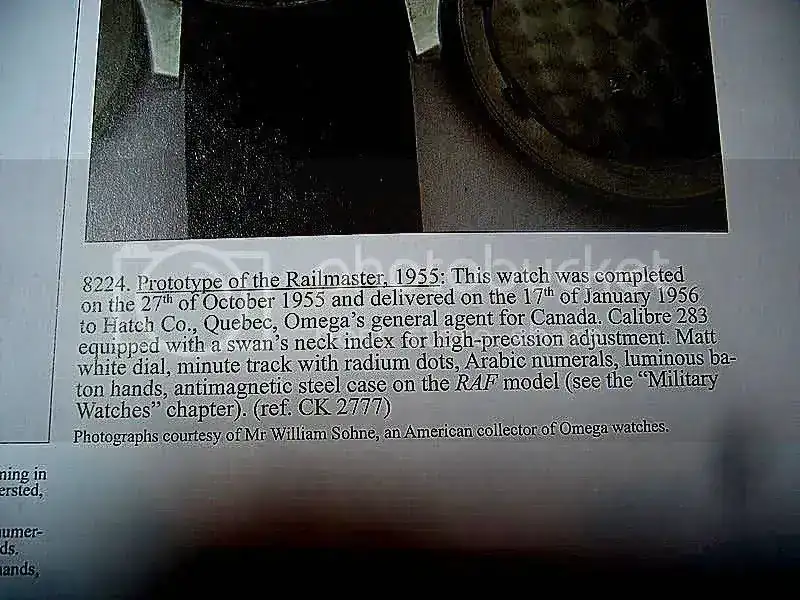

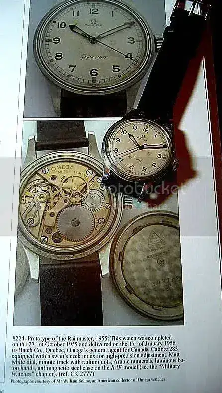

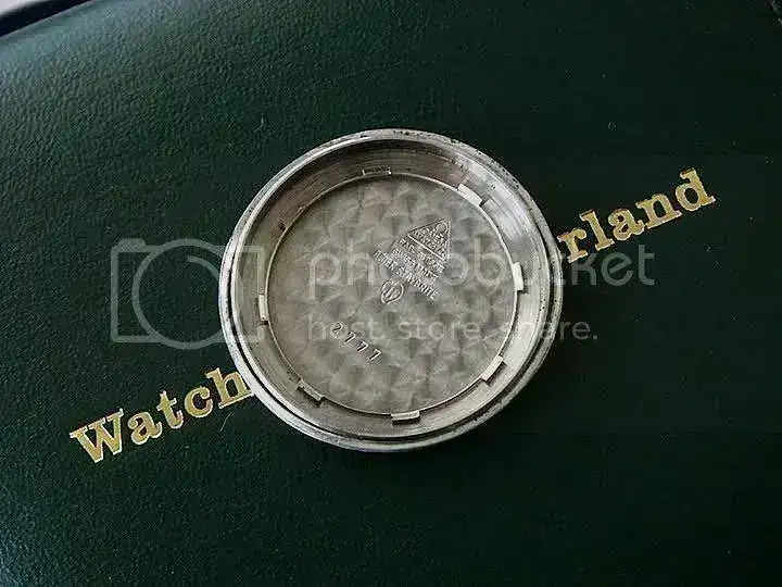

Railmaster Cronómetro.
Hola Juan, te pongo las fotografías del Railmaster Cal 283 que es al que se refiere la casa Omega:
+repetido
Hola Rafel,
Gracias por las fotos del bello Railmaster.
Aunque tenga un regulador especial y en fabrica fuera ajustado especialmente, son calibres no certificados oficialmente y esto es una custión clave.
Constructivamente son dos calibres muy diferentes. Los rochetes de los RG son especiales, por ejemplo, aparte de modificaciones en el volante y otros componentes que hacen que el calibre tenga poco que ver.
Existen otros integrantes de la familia 30 con ajustes especiales e incluso existen calibres estándar con certificado Chronometre. Pero el hecho de que estos 283 especiales no estén certificados, en mi opinión imposibilitan que sea considerado Chronometre.
Contructivamente diferente y especialmente ajustado sí, pero Chronometre no.
Ahora bonito e interesantes como ellos sólos.
Un abrazo.
Juan

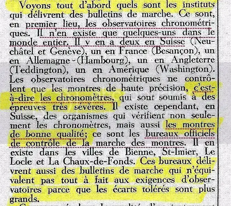

Hola Rafel,
Los boletines de marcha eran emitidos por los observatorios en Suiza con caracter oficial para garantizar que un reloj pudiera considerarse Chronometre.
En ellos se recogía el número de serie del reloj y los resultados que había obtenido en las distintas mediciones de acuerdo a su categoría y reglamento aplicable. Totalmente oficial y todavía hoy puedes solicitar ese certificado a Suiza.
Te dejo uno de las fechas en que debería emitirse para los 283:
El problema estaba en que no existía una estandarización de las pruebas a nivel mundial y por ello nace el certificado COSC,para unificar criterios. Antiguamente existían órganos certificadores en diferentes países con diferentes criterios.
Estos relojes se comercializaban normalmente. Y normalmente, dependiendo de la costumbre de la casa, estos boletines se expedían junto con el reloj y la caja. Para garantizar al comprador que el reloj que compraba había sido testado y clasificado como Chronometre por algún órgano.
Los concursos eran competiciones anuales donde las casas presentaban relojes para competir por obtener la mejor clasificación. Estos relojes especiales presentados a competición, raramente se comercializaban como bien apuntas.
Sin boletín, oficialmente en Suiza no podía considerarse Chronometre.

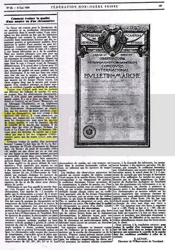

Hola Juan. Creo que he escrito varios hilos sobre el tema, A PESAR, COMO SIEMPRE, DEL OCULTISMO Y CONTRADICCIONES ENORMES.
Las pruebas, las últimas de Neuchâtel, se eliminaron por el enorme número de participantes que no pasaron del primer estadio. Que no presentaban innovaciones, que solo iban en busca del "papel". Que en realidad, no competían. Por la gran cantidad y poca calidad de los participantes. Se conformaban con el certificado de participación, que en muchas ocasiones se vendía como certificado de "cronometría". Si te fijas, los relojes que participaban, y ahora me remito a cuando se implantó la prueba para los relojes de pulsera, ni siquiera iban montados dentro de sus cajas metálicas. Sobre dichos certificados, y no hablemos, si efectivamente, pasaban la selectividad, y más si conseguían menciones y no hablemos si quedadan dentro de los primeros clasificados, se lanzaba el modelo oficial con referencia a lo conseguido o perseguido.
Me perdonarás mi querido amigo, pero a estas alturas soy muy escéptico sobre la teoría relojera suiza. Sobre el oficialismo y el marketing, del que no estuvieron exentas, todo lo contrario, las pruebas de cronometría, esencialmente para relojes de pulsera.
Creo recordar que la última vez que traté el tema fue cuando estudié el Zenith Cal. 135. Uno de los pocos modelos comerciales que fue fiel al modelo presentado y que, efectivamente, consiguió en primer lugar durante varios años.
El COSC, cuando se implató, se interpretó como un intento, aunque teóricamente se tratase de un organismo independiente, de favorecer a la relojería suiza frente a la nipona, que partició en Neuchâtel con estupendos resultados, poco antes del "cierre" y alemana, también. Como sabes, en el COSC no se compite, simplemente se certifica que se han pasado unas determinadas pruebas. Pruebas que la Seiko pasa internamente, así como existen otros certificados suizos o no, como el Sello de Fleurier (mucho más cotizado que el COSC) o el propio punzón de Ginebra, que aún cuando no exige criterios de marcha como el COSC, los requisitos obligatorios para los movimientos dan como resultado una calidad muy superior. De esta manera se evita lo que ocurre en la actualidad y que ocurrió en Neuchâtel. El conseguir un "papel" que haga más valioso el reloj. Huyendo de lo que fue el origen inicial, los avances relojeros, las nuevas aportaciones, con resultado en la exactitud. Y no simplemente un encasillamiento en ella, como viene ocurriendo en algunas patentes resurgidas que montan, desde hace años, los mismos calibres ETA con ajustes y que en su día consiguieron el COSC.

Buenas Noches Rafel,
He leído tus interesantisímos hilos, que son magníficos por cierto. Pero tengo una opinión un poco diferente a la tuya.
Tenemos que diferenciar las competiciones de cronómetro de los certificación de cronómetro.
Las competiciones de cronometría se desarrollaban en los Observatorios Suizos.
Las certificaciones de los Cronometros se realizaban en la BO´s (Bureaux officiels de contrôle de la marche des montres) que constaba de 5 oficinas independientes y que nada tenían que ver con los observatorios. Por lo menos en Suiza, ya que por ejemplo en UK sí certificaban los Observatorios. Estas oficinas independientes eran las responsables de testar los relojes que iban destinados al público de acuedo a un reglamento.
En los concurso de Cronómetros no se certificaba, se competía por obtener los mejores resultados en los test que estaban reglamentados.
De hecho en 1.973, lo que se hace es centralizar la BO´s bajo una única dirección y se crea el COSC aplicando la ISO 3159 para el control de los TEST.

Hola Rafel,
Totalmente de acuerdo, siempre es un placer dialogar contigo y como apuntas estos intercambios de información nos benefician a todos.
Mi visión del asunto es diferente a la tuya. En el análisis de la Cronometría, no se distingue normalmente entre los concursos y las certificaciones de cronometría. Y son muy diferentes.
La primera BO´s (Bureaux officiels de contrôle de la marche des montres) es fundada en 1.878 y desde ese momento certifica Cronómetros de acuerdo a su reglamento. Con posterioridad se fundan otras oficinas de certificación con dirección independiente pero con reglamento unificado de certificación, reglamento que varía a lo largo de la historia. Muy resumidamente se testaban los relojes para obtener el grado de Cronómetro durante periodos de 15 o 10 días, dependiendo si se presentaban a certificación clase A o B, siendo la A la mejor de ellas.
En esta época la definición de Cronómetro en Suiza no es única. La FH (Federation Suisse des Associations de Fabricants d´Horologie), considera como Cronómetros a los relojes oficialmente testados (en las BO´s). La Swiss Association for Chronometrie de 1.925, se desmarca de esta definición, considerando a Cronómetros como aquellos relojes que obtienen el grado de Cronómetro en los observatorios de Astronomía, y con los reglamentos aplicables en ellos.
Las competiciones de Cronometría se desarrollan en los observatorios de Neuchâtel desde 1.866 y desde 1.873 en Ginebra. Pero hay un matiz muy interesante, la certificación y competición de relojes de pulsera es muy posterior. La primera se realiza en Neuchâtel en 1.941 y en 1.943 en Ginebra. Para competir, los relojes presentados debían obtener el grado de Cronómetro por debajo de los parámetros del reglamento, eso les daba derecho a competir. Y el reglamento era mucho más duro que el de los BO´s, diferentes en ambos observatorios (aunque muy similares) con test que duraban respectivamente 44 y 45 días.
Para que te hagas una idea, en 1.945 participaron 10 relojes de pulsera en la competición de Ginebra y 82 en Neuchâtel. Se certificaron por los observatorios un total de 302 relojes de pulsera en todo el año. Es decir, de los 302 certificados por los dos observatorios, 92 tuvieron el derecho de participar en dichos concursos. Ahora, en el conjunto de la industria suiza se certifican 21.185 relojes Cronómetros. 302 por los observatorios y el resto ( 19.883) por las BO´s.
En 1.966, se certificaron 327.533 relojes de pulsera por la industria relojera suiza. Sólo 991 por observatorios y el resto por las BO´s. Y no es lo mismo un reloj certificado por un observatorio que un reloj certificado por una BO. Los criterios de obtención de dicho certificado son muchísimos más rigurosos en los observatorios que en las Bo´s.
En 1.952 se realiza una definición única. Los relojes Cronómetro son aquellos que regulados a diferentes temperaturas y posiciones obtienen un certificado oficial de marcha. Organizaciones en Suiza con posibilidad de certificar:
1. Los observatorios de Neuchâtel y Ginebra.
2. Las BO´s.
Y una recomendación a los fabricantes, aquellos relojes certificados por los observatorios, deberían ir especialmente diferenciados con la inscripción "Chronometre d´Obsevatoire". Estos relojes son muy raros y muy valiosos.
Conviven pues, tres entidades certificadoras. Con reglamentos distintos y poder certificador. Ahora bien, ¿cuando hablamos de relojes Cronómetros a que nos referimos normalmente? Esta cuestión es la que creo que está difusa en la mayoría de las ocasiones. Existen muy pocas unidades certificadas por los Observatorios, con sus criterios. Existen aún menos unidades de relojes que participaron en concursos, con sus criterios. Mayoritariamente nos referimos a las unidades certificadas por las BO´s. Que no tienen mucho que ver con las unidades oficialmente certificadas por los Observatorios, pues los criterios para obtener dicha certificación son mucho más laxos.
Desde mi punto de vista debemos diferenciar entre:
1. Relojes Cronómetro con premios en concursos de Cronometría.
2. Relojes Cronómetro con certificado emitido por observatorio.
3. Relojes Cronómetros certificados por las BO´s.
Las dos primeras categorías son las más raras. Escasas unidades de la 1ª existen en el mercado. Unas pocas más de la 2ª. Y la inmensa mayoría pertenece a la tercera.
Los Cronómetros BO´s son los que se convierten en los COSC actuales en 1.973. Una vez que se unifica la dirección de las BO´s en el COSC y se aplica la ISO 3159.
Los Cronómetros de Observatorio como tales desaparecieron en 1.972. Fueron una categoría especial, el paradigma de la Cronometría, donde las grandes casas presentaban los avances técnicos y los relojes especialmente diseñados para ellos. Escasos y raramente comercializados. Los BO´s son otra categoría, la que conocemos actualmente. Y en aquella época, un BO´s muy difícilmente alcanzaría el grado de Cronómetro de observatorio. Mejores que los relojes estándar, sin duda. Especialmente ajustados y testados, sin duda.
¿Que los relojes COSC se derivan de las competiciones de Cronometría de los observatorios?. Desde mi punto de vista, no. Los relojes COSC actuales se derivan de los BO´s.
2. Las BO´s.
Un abrazo.
Juan

Y como resulta muy difícil el documentar todo lo dicho, sí puedo adjuntar una publicación del boletín oficial de la relojería suiza de 1939, la publicación “La Fédération Horlogère Suisse”.
En ella se dice, que existen los Observatorios, detallando que en Suiza hay dos, que solo controlan los relojes de alta precisión; "es decir, los cronómetros". No obstante en Suiza, además, hay otros organismos que verifican, no solo los cronómetros, también los relojes de buena calidad (no de alta precisión), son las Oficinas Oficiales para Control de Marcha de los Relojes (había 4 en la época). Estas oficinas libran "boletines de marcha" que NO equivalen "exactamente" a las exigencias de los observatorios (cronómetros), porque las desviaciones permitidas son más grandes.
Es decir, yo no hago las distinciones que indicas, si no las siguientes, tomando un símil del fútbol, espectáculo que no es que sea de mi agrado, más bien lo contrario, pero que creo servirá:
1.- Reloj que juega en un Torneo Internacional para la obtención del título de Cronómetro. Pruebas de los Observatorios, primera fase de clasificación: boletín de marcha cronométrica.
2.- Reloj que demuestra que puede jugar en un Torneo Nacional. COSC, sin confrontarse con otros equipos, reconociéndole una supuesta destreza para poder hacerlo en primera división. Su calidad, sin mención a que podría sacarse el título de Cronómetro.
3.- Reloj que demuestra que puede jugar en un Torneo Regional concreto. El que recibe el B.O. cantonal, reconociéndole una supuesta destreza para jugar en la división regional de su demarcación.
Lo dicho, lo es sin perjuicio de aceptar, coloquialmente, como cronómetro o grado cronómetro a ejemplares que contrastada calidad, de marcas conocidas, que consuetudinariamente los hemos llamado como tales.
Imposible denominar cronómetros a la multitud de relojes que consiguieron B.O. en las oficinas cantonales, que confrontan una amalgama muy heterogénea en cuanto a calidad.
