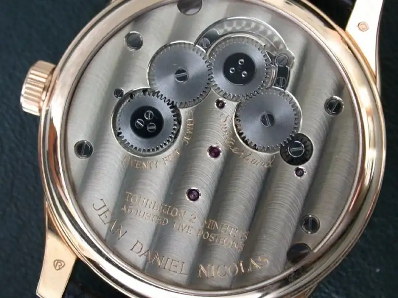

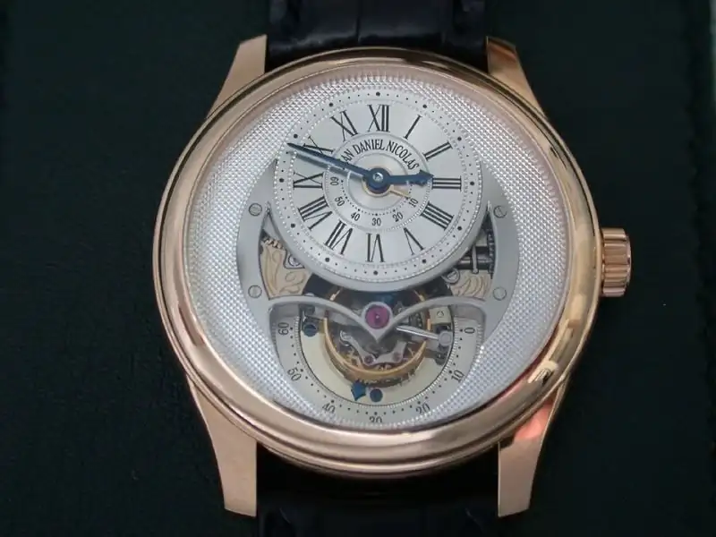

Solo quiero poneros unas fotos de este gran artista independiente

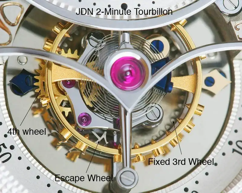

no entiendo, a ver si me aclarais
tiene una cuarta rueda este tourbillon? como se impulsa esa cuarta rueda? cuál es su función?::Dbt::::Dbt::
An inherent and interesting feature of the two-minute tourbillon is that the fourth wheel, which is usually the “fixed” wheel in tourbillons that rotate once per minute, has to be located inside the carriage. It runs in a counterclockwise counterpoint to the clockwise direction of the carriage, creating a wonderful visual effect. The fixed wheel in the two minute tourbillon is the third wheel, and Daniel inverted the teeth so that the wheel, when given its mirror polish, is a contrasting background to those blued steel and gold seconds hands, making reading their progress around the dial easy.
Dios mio que preciosidad gracias por descubrirnoslo
muchas gracias, aunque me temo que o lo veo en un esquema para tontos o en un video, o no voy a acabar de entender nada...::bxd::
