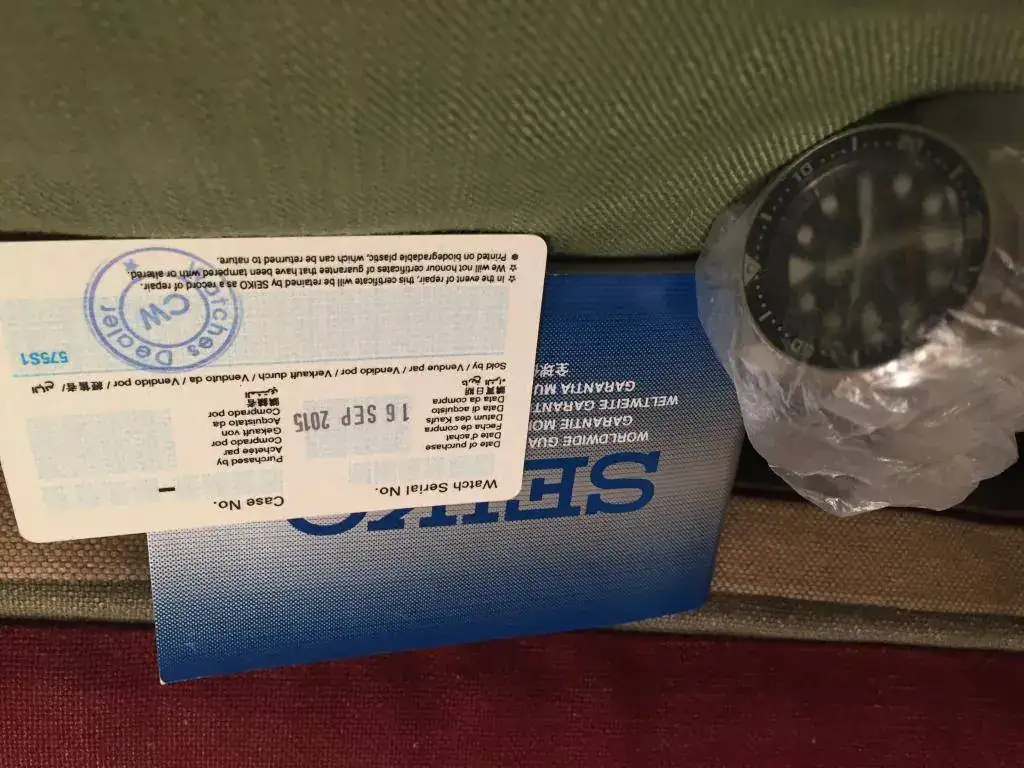

Acabo de ver que el vendedor reza esto en su página web:
We are not authorized dealers for the brands we carry, because we want to offer you lower prices. Manufacturers do not allow dealers to offer both manufacturer warranty and low prices, so all dealers must choose only one or the other. And so you too have the decision to make about which is more important to you. To help you choose us, in addition to low prices and great selection, we cover every watch we sell with our own 2-year warranty. Just like the manufacturer, it covers all manufacturing defects and associated costs except the one-way shipping from you to us. And to minimize the chance that you will ever need it in the first place, we inspect each watch before it leaves our warehouse.
La garantía viene sellada y fechada, justo con el mismo cutre sello que comentas Peterway...
(No se por qué sale al reves... Aunque bueno tampoco importa)
En fin mañana probaré suerte en un SAT que he visto que hay en mi misma calle... Aunque ya me huelo lo que me van a decir...
