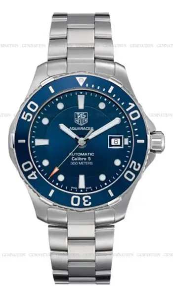

You Are Here: Watches • Mens • Tag Heuer • Aquaracer • WAN2111.BA0822 Tag Heuer Aquaracer Calibre 5 Mens Wristwatch
Model WAN2111.BA0822
Retail Price $1,600.00Our Price $1,091.00Your savings $509.00 (31.8%)
Quantity: 12345678910
This watch usually ships in 1 business day.Order today for shipment on Thursday Jul 15, 2010.In Stock
Product Details Item number: WAN2111.BA0822Brand: Tag HeuerStyle Number: WAN2111.BA0822Also Called: WAN2111BA0822, WAN2111-BA0822Series: Aquaracer Calibre 5Style (Gender): MensCase: Stainless SteelDial Color: BlackMovement: AutomaticEngine: Calibre 5Functions: Hours, Minutes, Seconds, DateCrystal: Sapphire CrystalCase Diameter: 41.5 mmCase Thickness: 11.5 mmCaseback: Stainless SteelBezel Material: Aluminum - Blue PVD FinishBezel Function: Rotating Uni-directional with 60-minute diving scaleWater Resistance: 300m / 1000ft (suitable for swimming, snorkeling, skin diving, diving)Crown: Stainless Steel - flutedCalendar: Date aperture at 3Watch Bracelet / Strap: Stainless Steel, brushedWatch Clasp: Folding Clasp with pushbuttonWatch Bracelet Length: 8.5 inchesAdditional Info: Luminous hands and markers

TE PONGO LA INFORMACION DE UNA PAGINA BASTANTE CONFIABLE (LO PUEDO DEMOSTRAR) EN LA CUAL NOS DICE QUE EL BISEL ES UNIDIRECCIONAL Y SI TIENE MOVIMIENTO.
