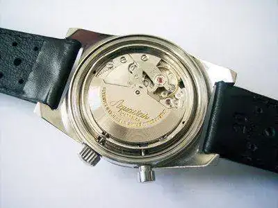

os pongo fotos de la maquinaría en cuestion ¿me podeis indicar que significa ese +y-?

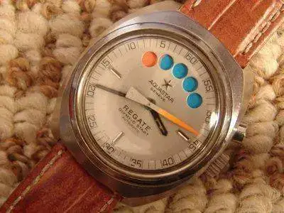

Here’s something different, a sailing timer from the Swiss company Aquastar…
(Click pictures to enlarge)​
From the early 1960’s onwards, Aquastar were one of the few companies who featured a sailing timer in their line-up, the purpose of which was to give the wearer a visual countdown to the start of a yacht race.
So how does it work? Well as you’d imagine, arranging a standing start for a yacht race can be a bit tricky(!), so two starting pistols are fired; the first 10 minutes before the start, and the second 5 minutes before the start. It’s then up to the crew to ensure that their yacht crosses the start line as close to the start time as possible, but not before.
When wearing the Aquastar timer, on hearing the second pistol you push the reset button, the centre second hand returns to zero and the five ‘minute markers’ on the dial turn red. As the last five minutes of the countdown elapse the minute markers turn slowly back to silver and when all the markers are silver the race is underway. The system works well, as even at a glance you can see how much time is remaining.
Being Aquastar’s first sailing timer the Regate only tracked the last part of the countdown, but in later models the function was enhanced to cover both parts of the countdown, with blue markers for the first five minutes and red for the second.

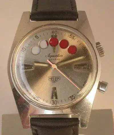

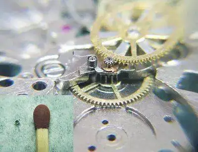

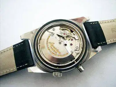

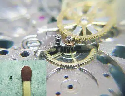

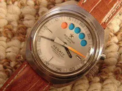

Ok, back to my watch… Although being in decent cosmetic condition, it arrived with several problems; it would only run for a few seconds, the timer didn’t work and the reset button didn’t do anything.

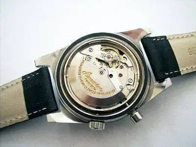

The movement in this watch is a Felsa 4000N, an 18,000bph calibre with both automatic and hand winding. At first glance, it would seem that the timer function is simply a module added to the base calibre. However, further investigation reveals that the changes go much deeper, including a third wheel with an independent shaft allowing for the second hand to be reset. (I hope to cover how the whole timer mechanism works in a subsequent post.) —-> That post has now been written, see here.
It looked as though someone had tried to fix this watch in the past but given up, the timer mechanism had been assembled incorrectly and judging by the condition of the oil it must have been many years ago. Thankfully all the parts were there, so after a thorough clean and some ‘head scratching’ during assembly it was finally back up and running again.
With the mechanical problems solved, a clean up for the case and a new crystal finished the job (It’s a shame that the dial has a few age spots in the lacquer, but on the whole it’s not bad at all)…

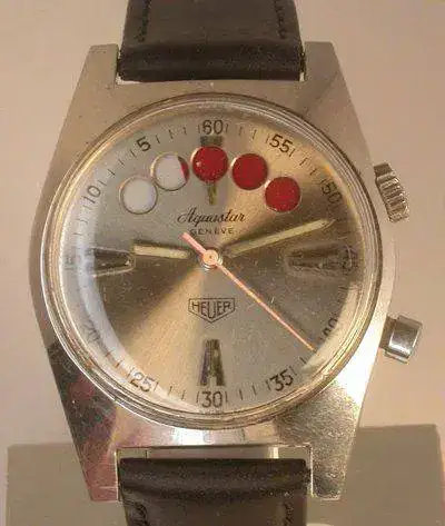

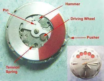

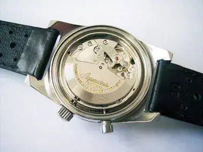

I recently had a chance to work on another Aquastar Regate, the first version from the 1960’s…
I restored one of these a few months ago, and working on this one reminded me that I was going to write a post about how the sailing timer mechanism works. In previous posts I’ve described how the timer is supposed to be used (here if you missed it), and how the timer mechanism works in the later Lemania based model from the 1970’s (here).

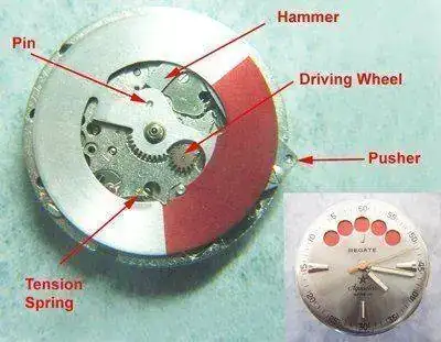

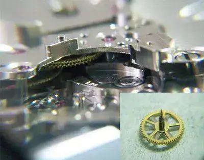

To recap, the calibre inside this model is a Felsa cal. 4000N; a 18,000bph automatic calibre, modified to include the sailing timer. Like the Lemania based version, removing the dial and hands reveals the rotating disc for the timer…
The picture above shows the timer in “stopped” condition, in this state the disc is locked in position by the tension spring. When the pusher is pressed, the hammer moves under the disc contacting the pin on the underside of the disc pushing it around anti-clockwise 90 degrees until the red section is at the top and the 5 holes in the dial show red (inset).

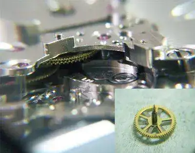

Power for the mechanism is provided by the driving wheel which transfers power to the teeth on the disc, rotating it back to the stopped state in exactly 5 minutes. The tension spring ensures a smooth transition and locks the disc in place again when complete.
The driving wheel pictured above is mounted on the extended axle of the third wheel. Digging deeper into the going train you can see that the third wheel is actually two independent wheels on a single axle with a friction washer separating them (inset below)…
While the lower of the two wheels performs the normal function of a third wheel in the train, the upper wheel is responsible for providing both the power to the timer driving wheel, and to the centre second pinion. In normal operation both wheels rotate together due to the friction provided by washer between them, but when the pusher for the timer is pressed, the friction provided by the washer is overcome and the upper wheel rotates independently, also moving the second hand back to zero to start the countdown.
With the wheel train bridge removed you can see how the third wheel is connected to the centre second pinion…
This calibre has one more technical trick up its sleeve. When the timer is engaged it is essential that the second hand is returned precisely to zero to start the countdown, regardless of its position. This is made possible by the addition of a cam to the centre second axle, and beside it you can see there is a spring loaded lever. When the wheel train bridge is in place, this lever is pressed against the cam and stops the second hand in the zero position when the notch on the cam hits the lever. To give an idea of scale here, inset is a picture of the lever spring next to the head of a standard match.
As the only problem with this watch was a lack of servicing, so after a clean and oil it was back up and running again. The only thing left to do was straighten the second hand, and polish the cloudy crystal. Here’s the result…

TRADUCCIÓN 1
Yo tenía una oportunidad recientemente para trabajar en otro Aquastar Regate, la primera versión de los 1960…
Yo restauré uno de estos hace unos meses, y trabajando en este uno me recordaron que yo iba a escribir un poste sobre cómo los navegación cronómetro mecanismo trabajos. En los postes anteriores yo he descrito cómo se supone que el cronómetro es usado (aquí si usted lo extrañara), y cómo el mecanismo del cronómetro trabaja en el Lemania más tarde basó a modelo de los 1970 (aquí). Para recauchutar neumáticos, el calibre dentro de este modelo es una cal de Felsa. 4000N; un 18,000bph calibre automático, modificado para incluir el cronómetro de la navegación. Como el Lemania la versión basó, mientras quitando el dial y las manos revelan el disco girando para el cronómetro…
http://www.thewatchspot.co.uk/images/BlogImages/Large/Regate2-2.jpg
El cuadro sobre las muestras el cronómetro en “detuvo” la condición, en este estado el disco se cierra con llave en la posición por la primavera de tensión. Cuando el arribista se aprieta, el martillo mueve bajo el disco que avisa el alfiler en la parte inferior del disco que lo empuja alrededor de anti-en el sentido de las agujas del reloj 90 grados hasta que la sección roja esté en la cima y los 5 agujeros en la muestra del dial rojo (inserte). Impulse para el mecanismo que se proporciona por la rueda tendencia que transfiere el poder a los dientes en el disco, mientras girándolo atrás al estado detenido en exactamente 5 minutos. La primavera de tensión asegura una transición lisa y cerraduras de nuevo el disco en el lugar cuando completo. La rueda tendencia se imaginada sobre está montada en el eje extendido de la tercera rueda. Excavando más profundamente en la ida entrenan usted puede ver que la tercera rueda realmente es dos ruedas independientes en un solo eje con una lavandera de fricción que los separa (inserte debajo)…
http://www.thewatchspot.co.uk/images/BlogImages/Large/Regate2-3.jpg
Mientras el más bajo de las dos ruedas la función normal de una tercera rueda realiza en el tren, la rueda superior es responsable para proporcionar ambos el poder al cronómetro la rueda tendencia, y al centro segunda ala. En el funcionamiento normal ambas ruedas giran debido juntos a la fricción proporcionada por lavandera entre ellos, pero cuando el arribista para el cronómetro se aprieta, la fricción proporcionada por la lavandera se supera y la rueda superior gira independientemente, mientras moviendo atrás también la segunda mano para poner a cero para empezar la cuenta atrás. Con el puente de tren de rueda quitado usted puede ver cómo la tercera rueda se conecta al centro segunda ala…
http://www.thewatchspot.co.uk/images/BlogImages/Large/Regate2-4.jpg
Este calibre tiene un truco más técnico a su manga. Cuando el cronómetro está comprometido que es esencial que la segunda mano ha devuelto poner a cero para empezar la cuenta atrás, sin tener en cuenta su posición, precisamente. Esto es hecho posible por la suma de una leva al centro segundo eje, y al lado de él usted puede ver hay una palanca cargada primaveral. Cuando el puente de tren de rueda está en el lugar, esta palanca se aprieta contra la leva y detiene la segunda mano en la posición cero cuando la muesca en la leva pega la palanca. Dar una idea de balanza aquí, la intercalación es un cuadro de la primavera de la palanca al lado de la cabeza de un fósforo normal. Como el único problema con este reloj una falta de reparar era, así después de un limpio y engrasa regresaba de nuevo en marcha. La única cosa salida para hacer era enderece la segunda mano, y pula el cristal nublado. Aquí es el resultado…
