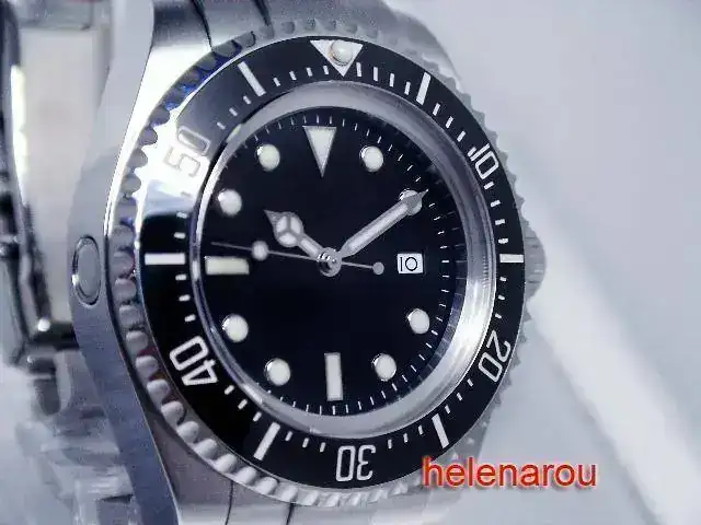

Bueno , el caso es que estoy decidido a pillar un Homage del Deep Sea para un proyecto que te tengo en mente y no se cual de estos dos pillar. Por las características son muy parecidos y visualmente tb. POr eso os pido ayuda , opiniones de alguno que los haya tenido .
Ahora os pongo fotos y caracteristicas:
HELENAROU
Product Description
44mm Deep Sea Sterile Solid Steel Watch with Ceramic Bezel and ETA 2836-2
Branded is also available
Case size: 44m excluding crown, Solid 316L Stainless Steel with Screw Lock Crown and 2 pieces Solid Screw down Case back
Bezel: Unidirectional rotationable Non-scratchable CERAMIC
Case height: 18.7mm
Glass: Anti-reflection DOMED Sapphire Crystal in 2.75mm thickness
Movement: Genuine SWISS ETA 2836-2, 11.5 ligne, 25 jewels, with Incabloc shock protection, automatic, sweep seconds, date at 3 o'clock and 28,800 BPH. ** We are only selling Swiss ETA, and don't stock or selling Asian ETA like other sellers **
Water Resistance: 5 ATM
Bracelet length: Up to 9.0 inches Solid Stainless Steel with NEW STYLE GlideLock Clasp and fliplock extension links
Dial: Black Sterile Dial with white Marker and Blue Lume
Hand: Silver Anodize Hand with Blue Lume
Watch weight: Heavy 216g
PARNIS
MOVEMENT: SWISS ETA 2836-2 25J Automatic (self-winding) movement
CASE DIAMETER: 43 mm without crown 47mm to crown
THICKNESS: 17.5 mm
LUG SIZE:20.5MM
DIAL COLOR: Black dial
CASE MATERIAL: brushed 316L stainless steel case with brushed back and Steel bezel BRACELET: stainless steel
FRONT GLASS: scratch proof mineral glass
BACK GLASS: Solid Case back
