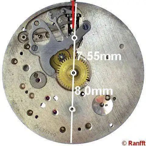

El Landeron 47, es el primer cronografo de palancas que salió al mercado, año 1937, es tambien el primer crono de 3 pulsadores, uno de ellos en la Corona, pero no la corona, dentro de la corona.
Movimiento de muy corta producción, que sirvió de base a los posteriores y archiconocidos 48 y 248
Veanlo en Ranfft

Con relación al movimiento, ya sabes, de hace 70 años, siempre hay dudas, pero esta contestacion en Watchuseek de Roland Ranfft, en persona, aclara la diferencias en uno y otro movimiento, ojo que se refiere solo al de 2 pulsadores, pero en la misma base.
"Hi Merrick,
model changes of Landerons were always floating, because almost all parts
were interchangable between the members of what I'd call the 48 family.
There are only minor differences between Landeron 47
and Landeron 48
1) The chrono cock of the 47 has a gap to access the dial screw, while in
the 48 it is shaped not to cover the screw.
2) The upper corner of the balance cock of the 48 was cut to give more
space for the head of the movement mounting screw. In the 47 this curve
is missing.
3) The minute recording jumper is adjustable with an excenter in the 48
while it fixed in the 47.
4) The clutch levers have different shapes.
If you compare the details with your movement, you'll agree that ist is a
Landeron 48 with the unadjustable jumper of the 47. As this jumper is one
of the few not interchangable parts, you can be sure that it is a very early
Landeron 48.
Regards, Roland Ranfft "
