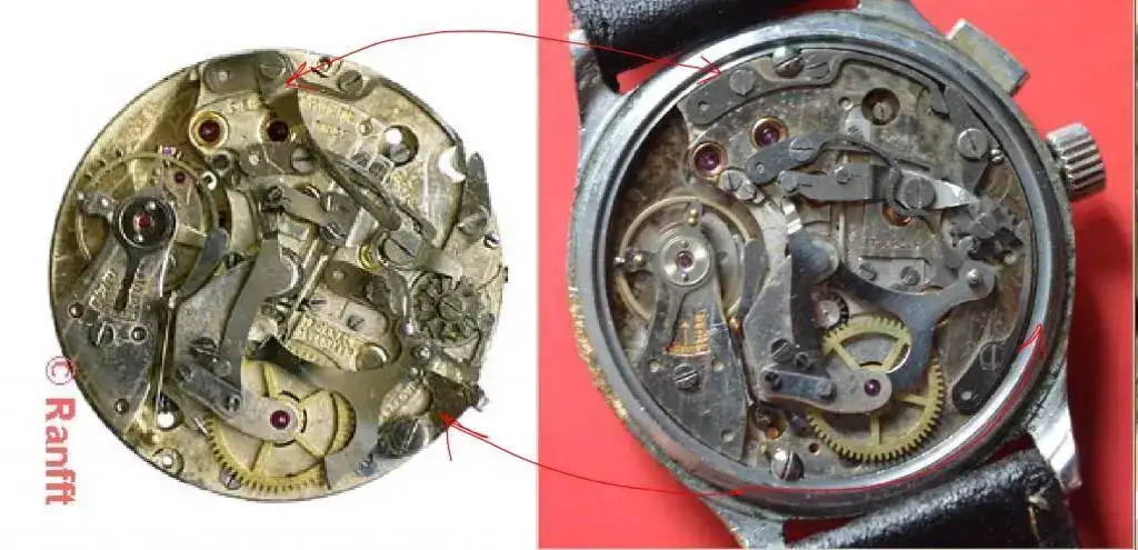

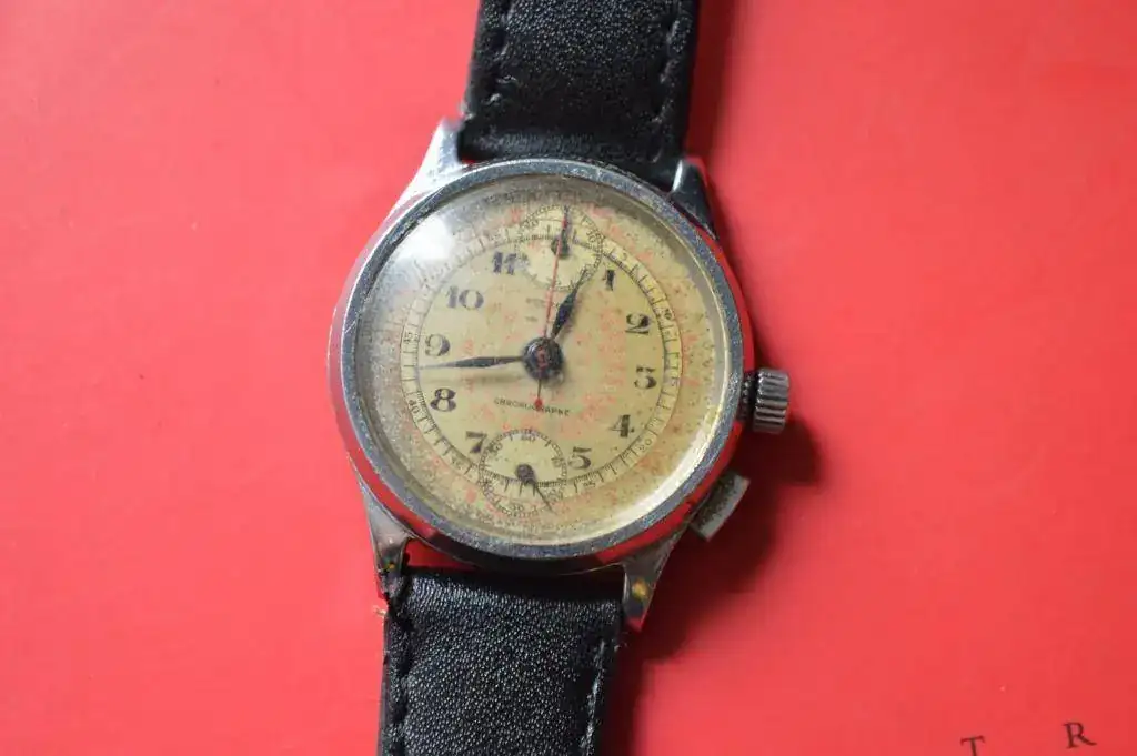

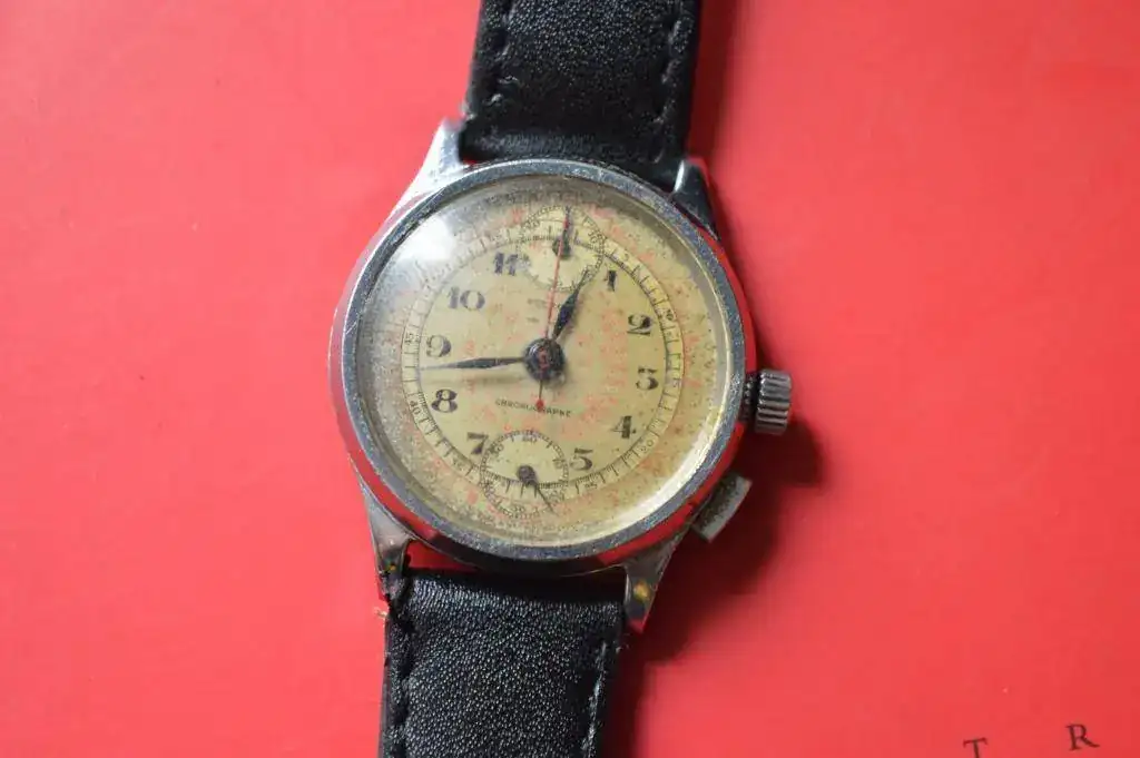

Bueno, amigos, tengo bastantes dudas acerca de esto. A ver si alguien me saca de ellas:
Muchas gracias.
creo que SI y podría ser[TABLE="width: 100%"]

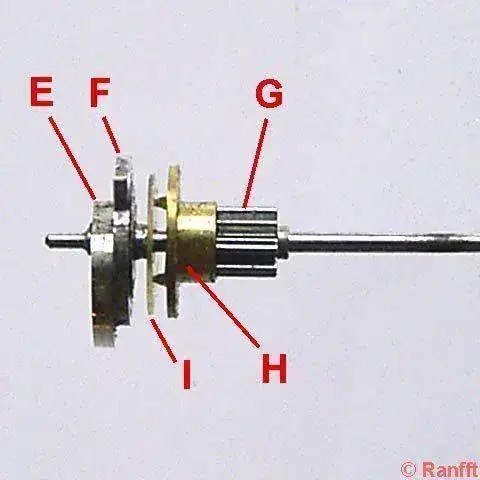

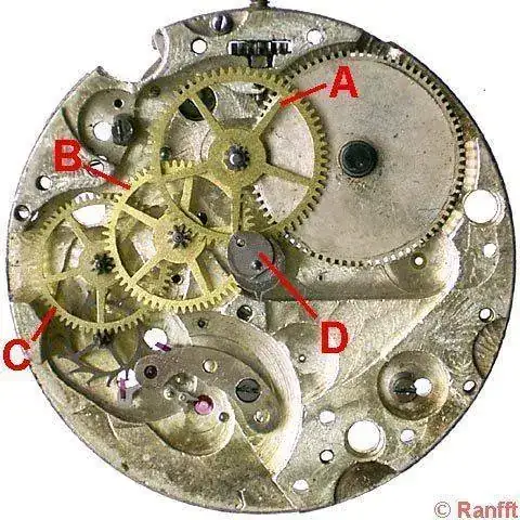

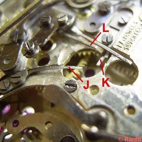

Patented axial clutch for second counter (Fig.3-5):
The minute wheel A is not in the center like in conventional movements. It drives the hands gears via canon pinion (Fig.2), and the third wheel B. This drives the sub second C and the detachable center second D.
On the center-second arbor with heart disc E and minute-counter driver F the pinion G with clutch H is running. Pushing (left in Fig.4) the arbor will clamp the clutch washer I beween F and H, and thus couples both together. The two points on H are then pressed into the soft washer I, thus reliably connecting both parts.
The clutch H is kept floating with springs J and K, and the spring L keeps the clutch parts apart. Coupled is by a lever (Fig.1, center) pressing on the center-second arbor. As the heights of all springs are adustable, the clutch can be sensitively adjusted to engage and disengage reliably without too much friction loss.
In most chronographs the clutch is realised by gears, and therefore the second counter jumps one tooth forth or back when started. This doesn't happen here, but there is a drawback in return: The original clutch washers I became brittle after some time, and replacement isn't available since long. But one can make them from suitable plastic material.

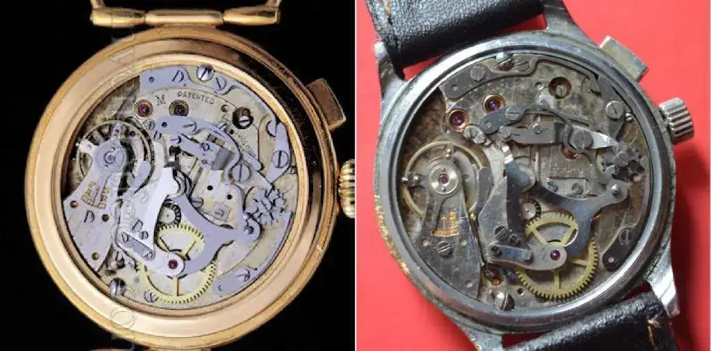

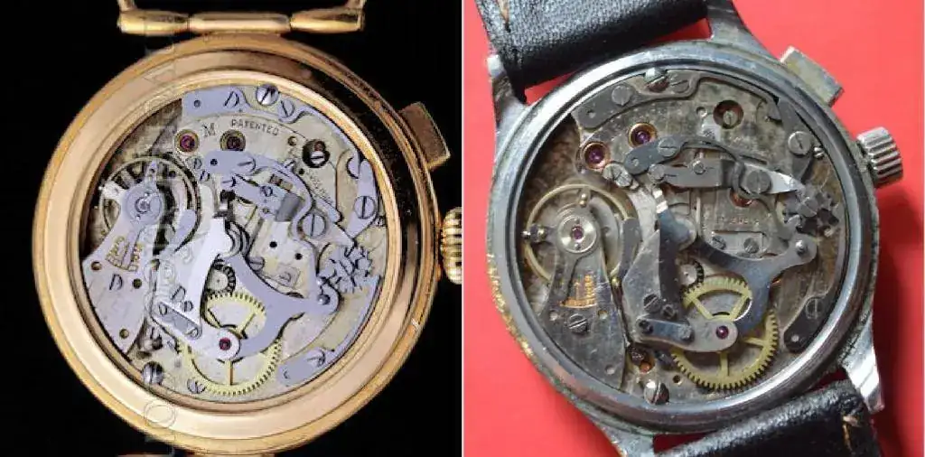

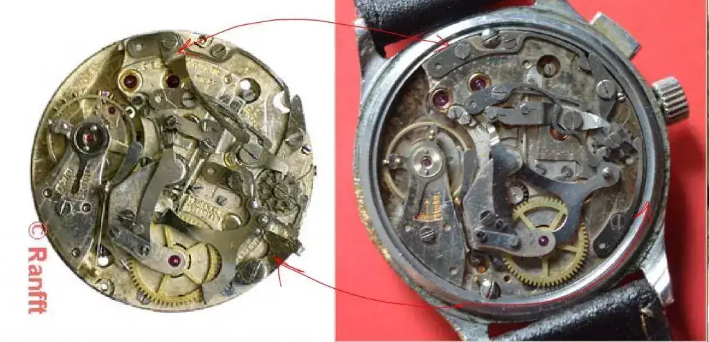

Gracias, Cesc. Sí, puede avenirse a ese "tronador", en cuyo calibre tampoco aparece ninguna señal de la marca y sí "M patent", como en el que muestro yo. Lo que ocurre es que me hago un lío comparando la complejidad de estos calibres.
Geniales aportes Cesc.
Como dice Velablanca tiene todas las caracteristicas del 130
Con el calibre 134 existen diferencias y además parece que este Tronador lleva solo un pulsador.
Es cierto que esto de los cronos es un mundo aparte....

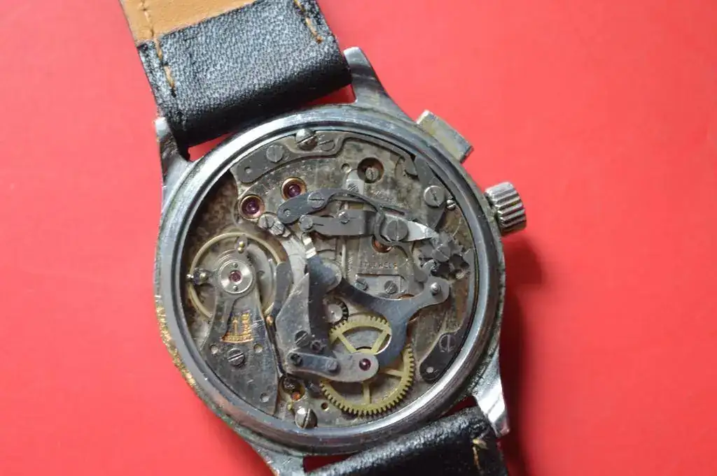

Sin ser ningún experto yo lo veo muy de verdad. Precioso.

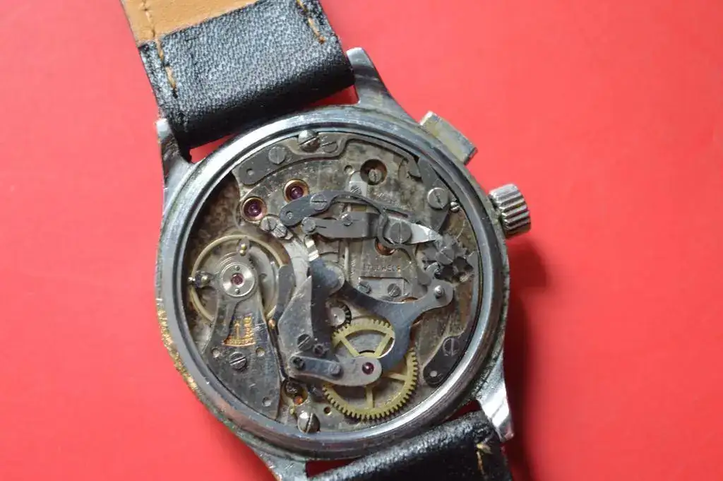

Corona cambiada, el movimiento no parece estar en muy mal estado pero le hará falta un repasillo. Si estás pensando en comprarlo presupuesta un pico mas para dejarlo bien bien y no pagues de más.
Muchas gracias, Vicente
Sí y ahora que sé que es bueno, me encanta.
La corona es de Tissot. Ya está en el taller. Le he dado al relojero una corona de cebolla que creo le irá bien, pero que me guarde la otra, para lo que se presente.

Gracias, Vicente. Sí, todavía no me atrevo a meter mano a las tripas de los relojes. Cuando os leo y ve lo que hacéis se me antoja que estoy a años luz de vuestra habilidad ( me refiero a ti, a Casiná, etc.). Estoy a la respuesta del relojero, al que enfaticé que se limitara a corregir el adelanto que traía (supongo que tendrá la espiral pegada) y a cambiar la corona por una de cebolla, además de un repaso. Porque el mecanismo del crono funcionaba --y espero que aún funcione-- perfectamente.
Sí Luis, conozco las dificultades de estos calibres, pero el crono funcionaba perfectamente: reseteaba y acumulaba minutos si problemas, por eso lo compré. Si no, lo hubiera dejado allí. Lo único es que adelanta una barbaridad. Claro esto solo pude verlo al llegar a casa. Así que le he dado instrucciones al relojero de que no toque más que lo imprescindible.

Este calibre 134 de Pierce, al ser de arrastre por friccion tiene su punto debil en una infima juntita de corcho que casi nunca lleva (yo tengo tres y ninguno la lleva) aunque se pueden hacer inventos por parte de un relojero muy experimentado, que tengas suerte compañero.
Si lleva la juntita dile a tu relojero que tenga mucho cuidado al limpiar el reloj que se volatiliza.
Mucha suerte compañero, el reloj es precioso
¿dónde está la dichosa junta?
