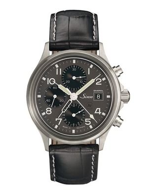

Sinn 103-st-diapal

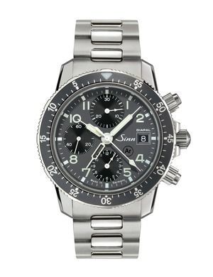

Sinn 358-diapal

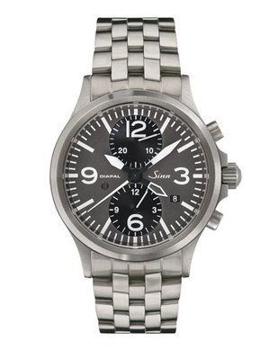

Sinn 756-diapal
