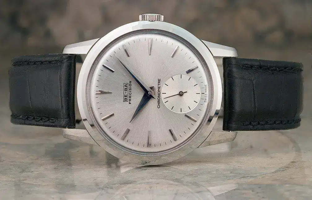

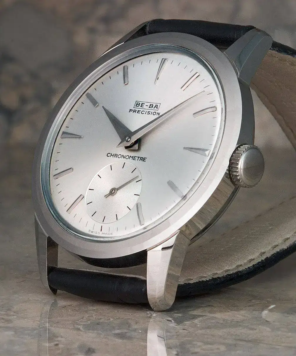

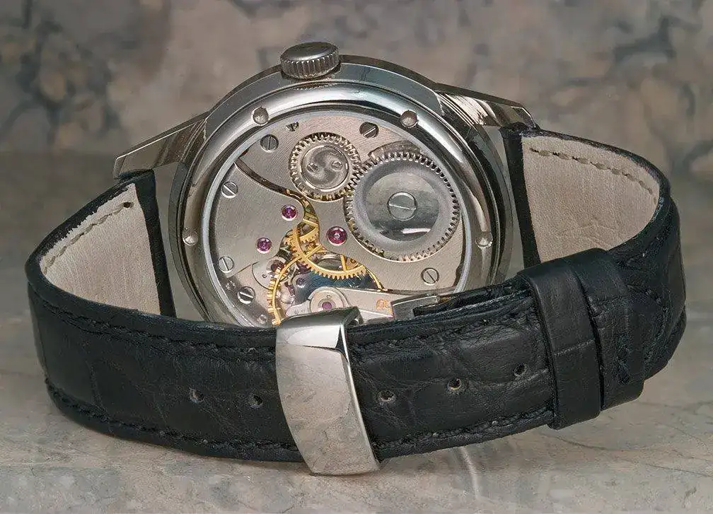

Be-Ba Competition chronometer, Peseux 260Before launching into the subjects raised by this watch, let me issue a warning that this isn't just any ordinary one-or-two-off custom-cased-and-dialed wristwatch. To appreciate this one we are going to venture into some obscure topics. I will try to summarize rather than send all off clicking away into the void, albeit with some loss of a completely informed presentation, and of much detail.
It is necessary to distinguish between watches receiving common COSC ("Controle Officiel Suisse des Chronometres") chronometer certification and those receiving Observatory certification or actually competing at either the Geneva or Neuchatel Observatories. Almost all of my information comes from Fritz von Osterhausen's book "Wristwatch Chronometers", and I have summarized quite a bit, for his presentation is very detailed, if not terribly friendly in the English translation.

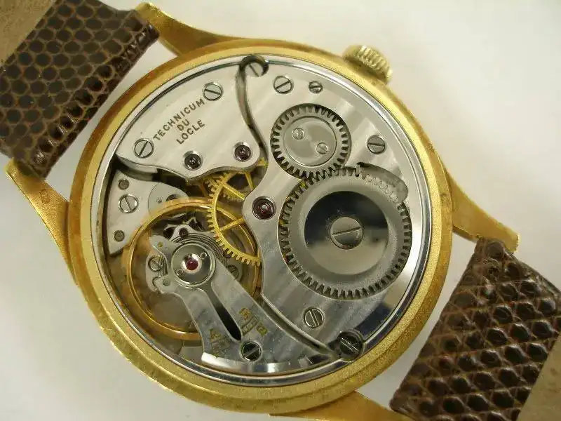

The Peseux 260 movement was designed specifically for observatory competitions, and its total production of some 3300 units was spread over nearly a quarter-century, ending in 1970. This picture shows a Peseux 260 incorporated into a Ulysse Nardin watch, and cased appropriately for competition. This would appear to be an earlier version, as it has a steel hairspring and cut balance, rather then the blue Nivarox 1 spring and solid balance of the Be-Ba.
[SIZE=+0][SIZE=+2][SIZE=+0][SIZE=+2][SIZE=+0][SIZE=+2][SIZE=+0]

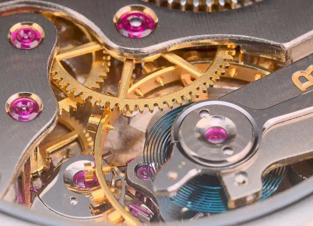

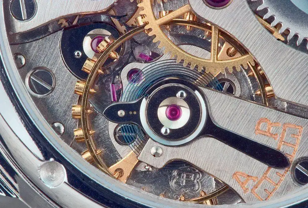

At 13 lignes (just under 30mm) diameter, the 260 is at the size limit for its category, and the 13.5mm diameter balance is obviously as large as possible. Likewise, the barrel is over 12mm diameter to allow for the longest possible mainspring and consistent torque supply. Other refinements appropriate to a movement of such narrow application are not obvious, but the finish of the bridges, teeth and screws is exemplary, if not especially decorative. This particular movement has been custom-cased and wonderfully dialed, and provided a neat display back. I have no evidence that the Be-Ba's movement was ever submitted for testing, or entered into competition, but even if, as with the street-legal homologation of certain racing automobiles, it turns out to be just intended for a well-informed consumer, it is still a great, pure-bred engine dressed in beautiful if appropriately subtle clothing. As of the moment, the origins and meaning (if any) of the appelation "Be-Ba" remain charmingly undetemined.

Gracias por el artículo Mazel, interesantísimo. Y respecto del reloj ese que dice "Be-Ba", ya me gustaría beber, ya... bonito como él solo.
Una belleza ese calibre.............:ok::

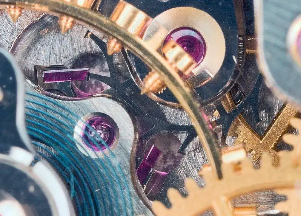

Y que fotos!, en la penúltima foto parece que te vas a caer dentro del calibre!, muchas gracias por este interesante aporte, Mazel!

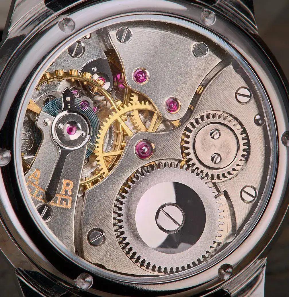

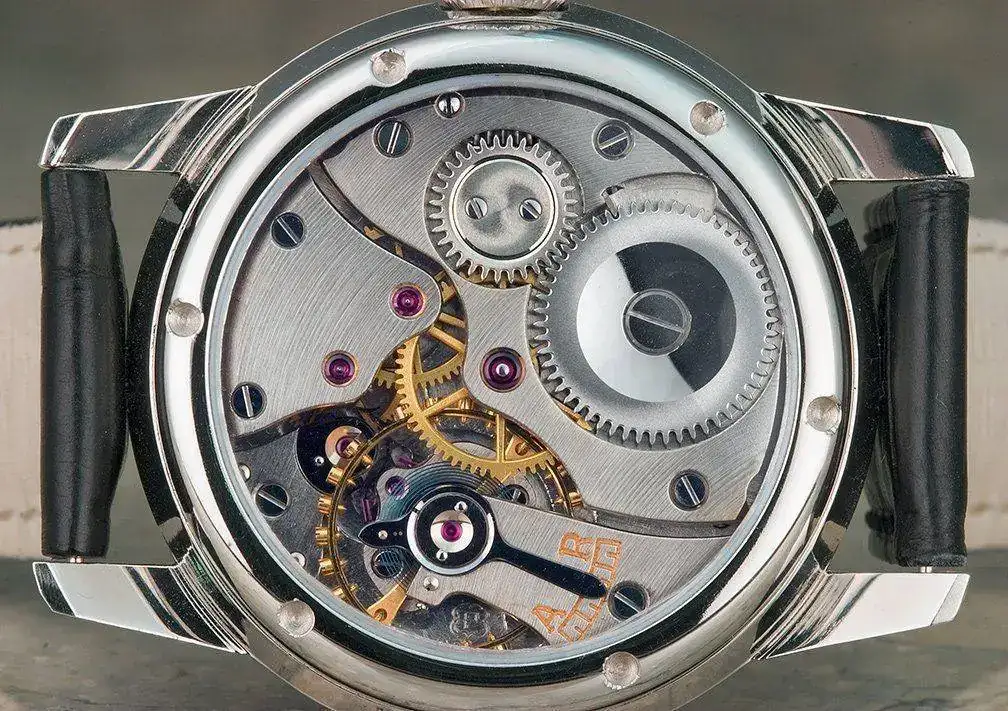

Una versión actuializada de Kari Voutilanien comentada por el amigo tempus a un precio inalcanzable, sólo para el mercado de luxe.

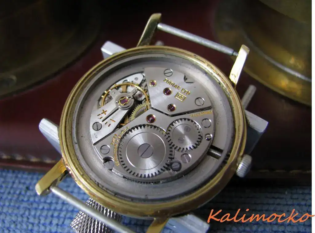

Fantástico Miquel!!!! Un hilo 5 estrellas. Peseux es uno de mis movimientos favoritos, este escaso 260 es el súmmum de la marca con 13 líneas para competir con los mejores.
Te acompaño con un 320 de 10,5 líneas pero que al igual rezuma gran calidad.
