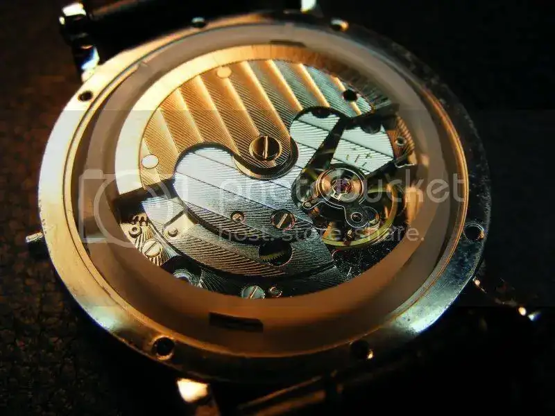

Respecto al calibre Claro, es un Seagull ST16 remarcado. El mismo forero hace un desmontado completo del mecanismo "suizo" y chino, y una comparación pieza a pieza. Como dos gotas de agua.
Claro-Semag CL-888 versus Sea-Gull ST16

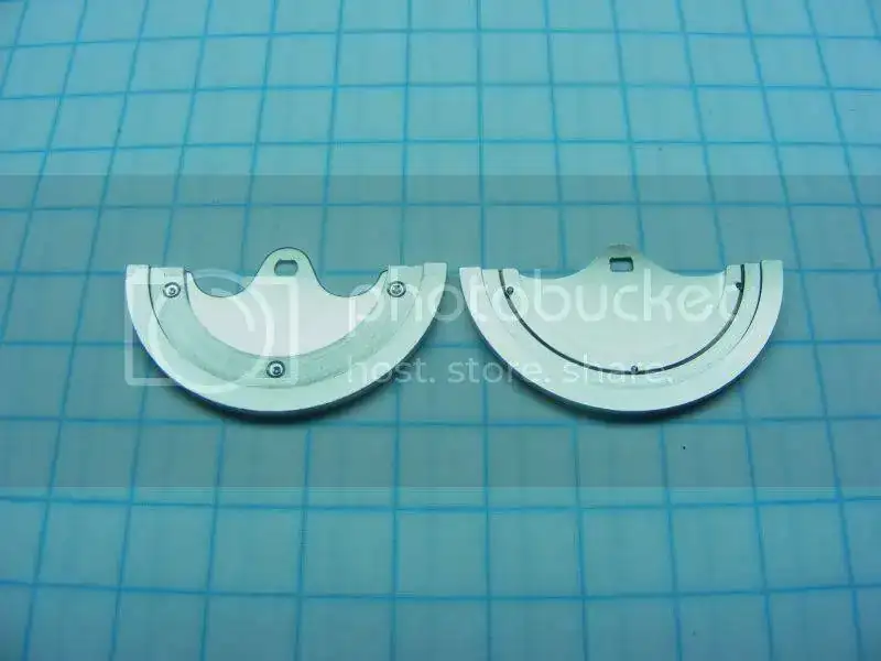

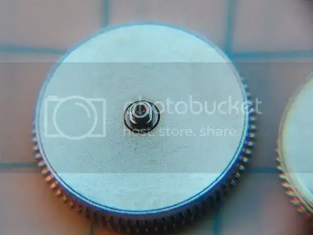

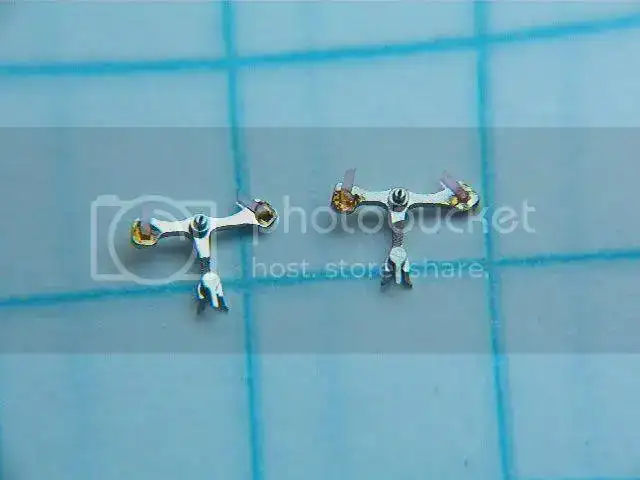

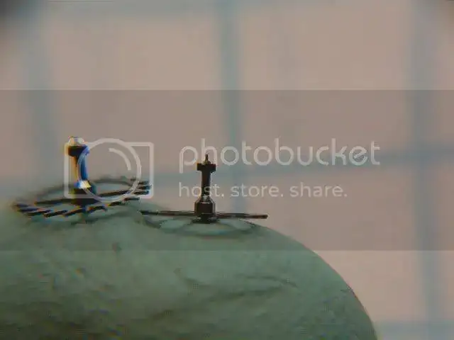

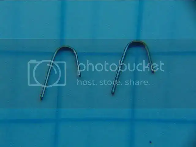

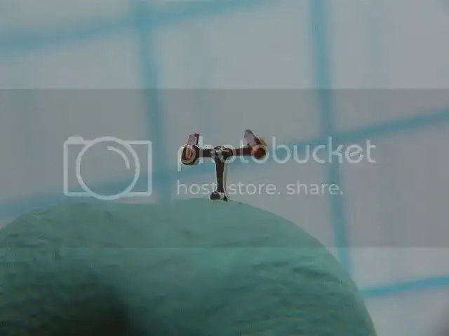

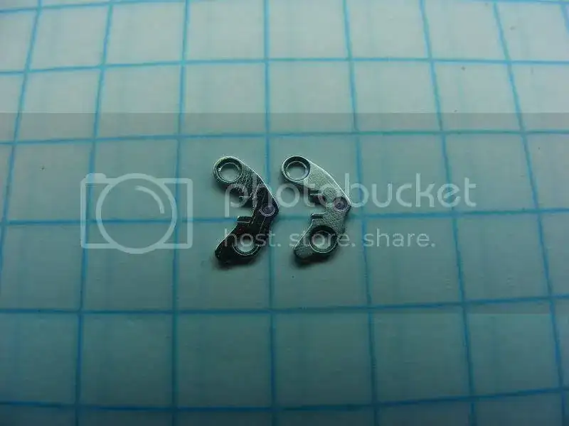

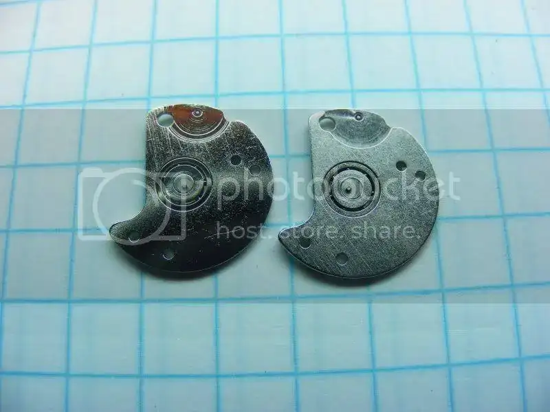

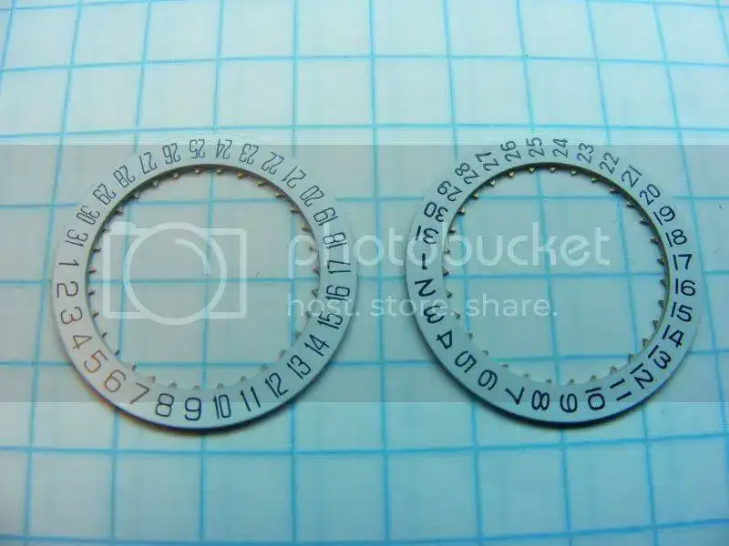

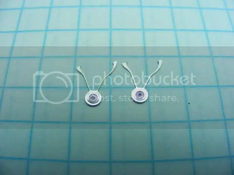

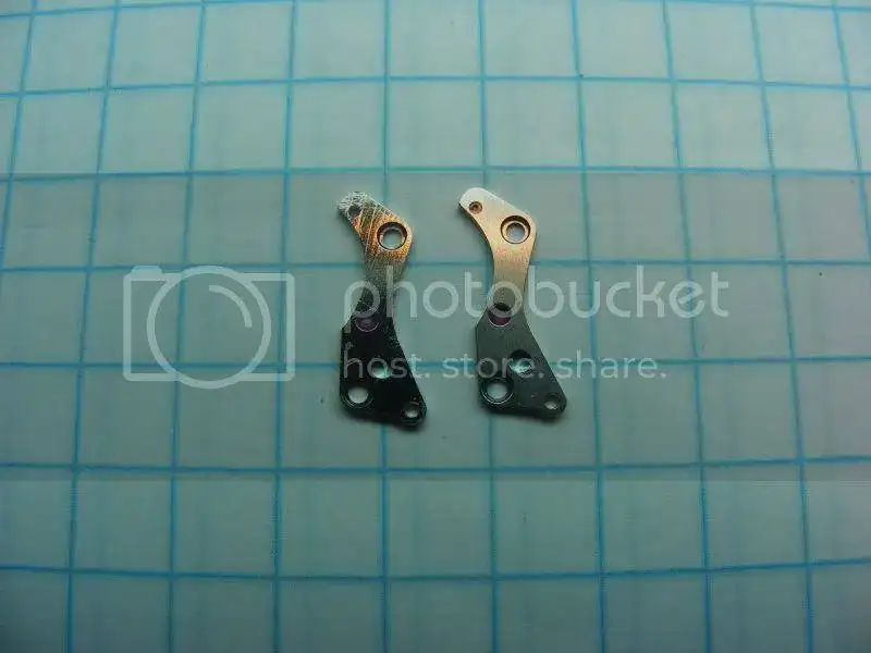

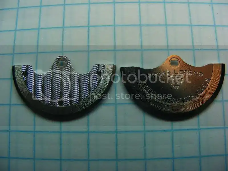

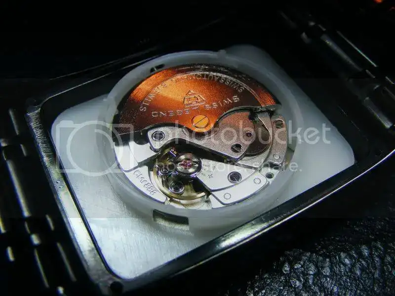

I was asked Zoodles95 to tear down and compare these two movements during a routine service so we can see just what are the differences between these two movements:
(Note: the top,or right-hand image will always be the CL-888 and the bottom, or left-hand image will be the ST16.)
Here are the two movements in there respective cases, the CL-888 in a large black Swiss Legend; the ST16 in a smaller Seagull.
The first thing done was check the timing of the two:
CL-888:
Beat error - 0.9 ms
Rate - +6.00 (dial up), +21.5 (crown down)
ST16:
Beat error - 1.5 ms
Rate - -7.2 (dial up), -11 (crown down)
Both of these rates are acceptable, and should average within my preferred band of +/- 10 s/d.
Now we start withe the actual disassembly of the movements. For those who wish to see the actual steps taken I refer you to the WUS thread titled "Inside an ST16 (lot's of images)", where did a step-by-step on the disassembly of this movement.

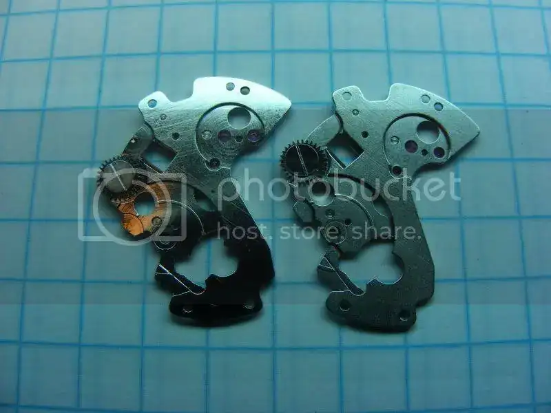

I thought there would be some differences between the two, but, as you will see in the following pictures, there isn't.

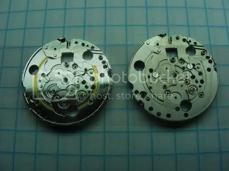

Mainplates
Date wheels
Main Bridge
Auto Bridge
Rotors

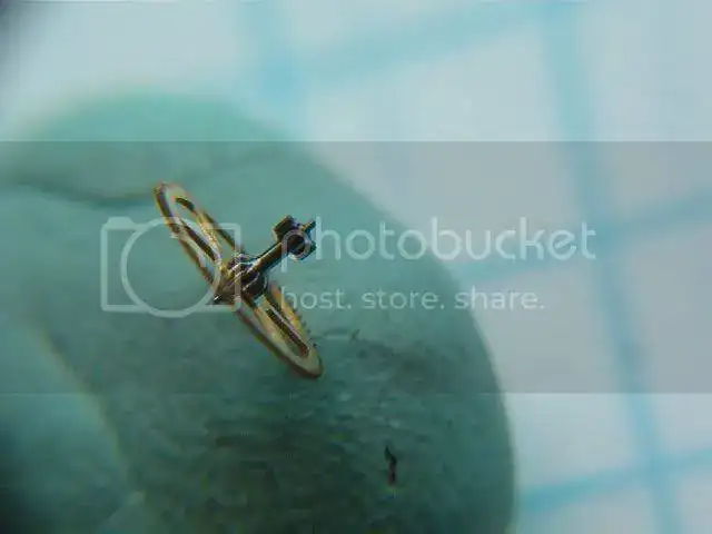

2nd Wheel

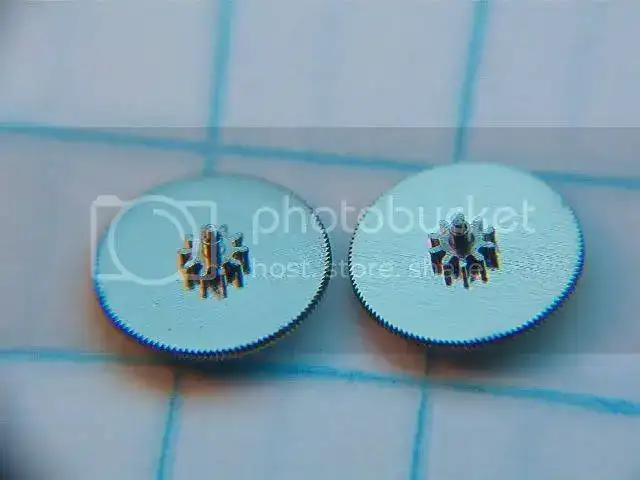

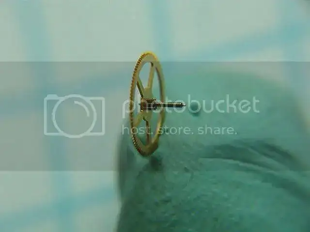

4th Wheel

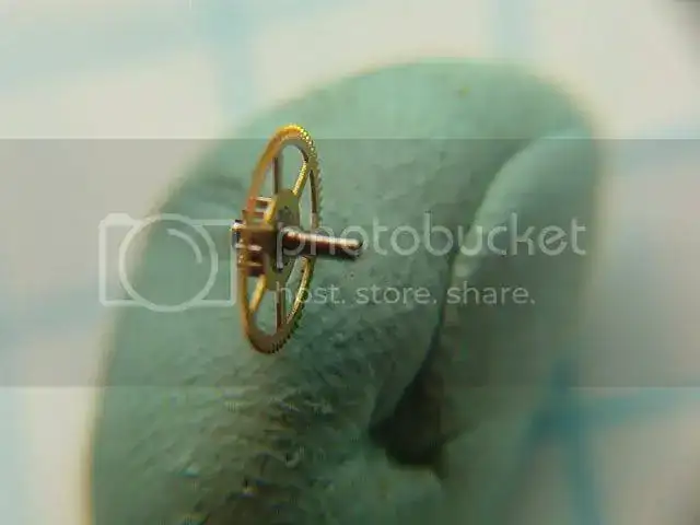

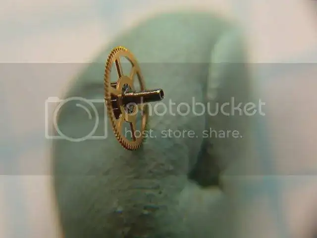

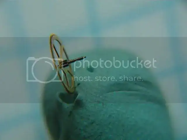

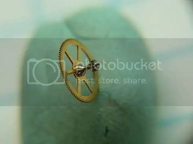

3rd Wheel

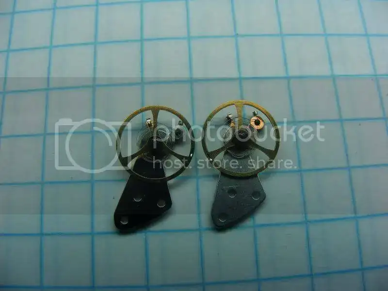

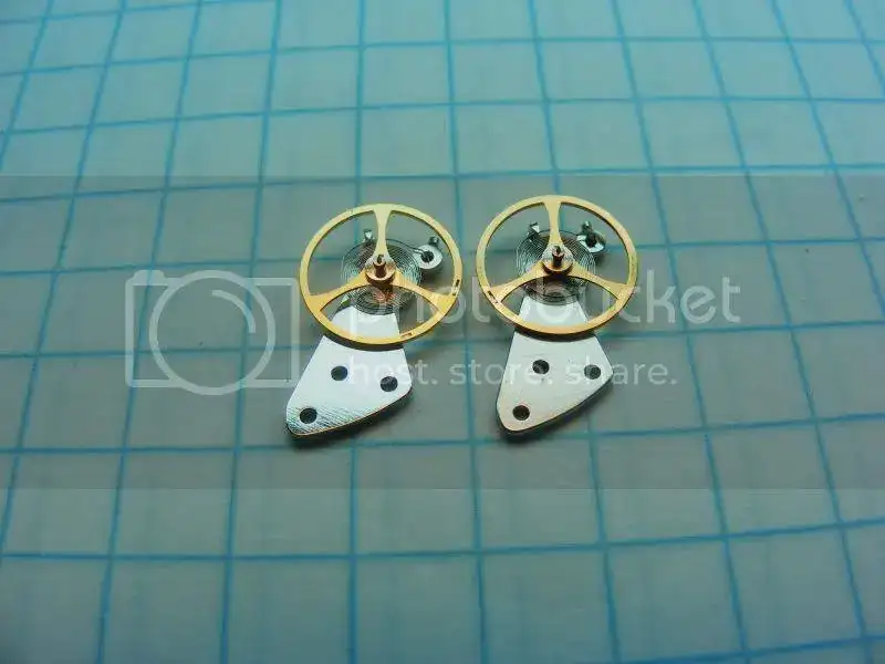

Balance
Pallet Bridge

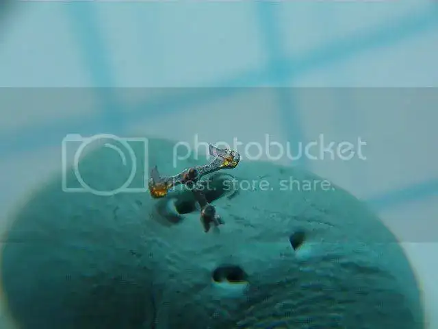

Pallets

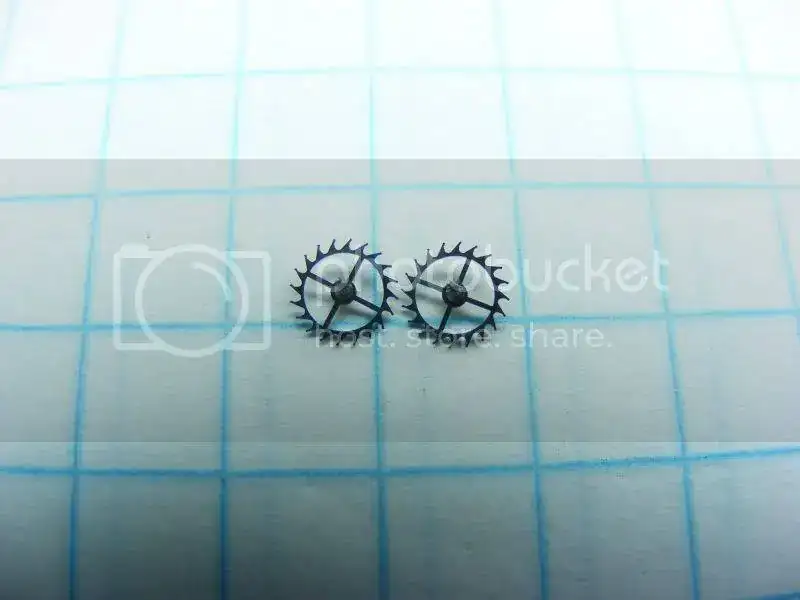

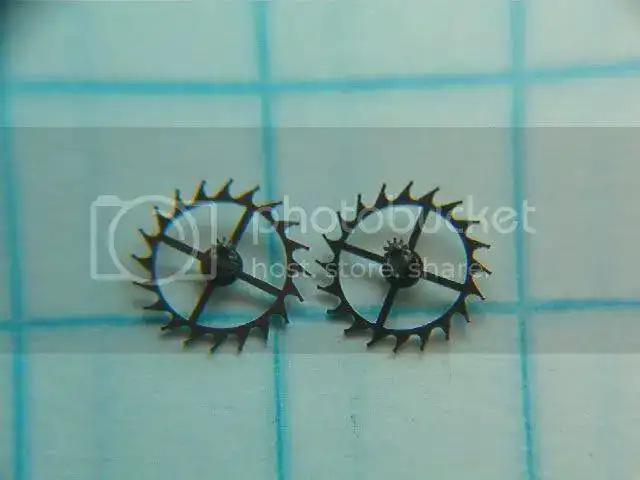

Escape Wheel

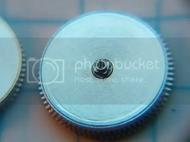

Barrel

"Magic Fingers" for auto-winding

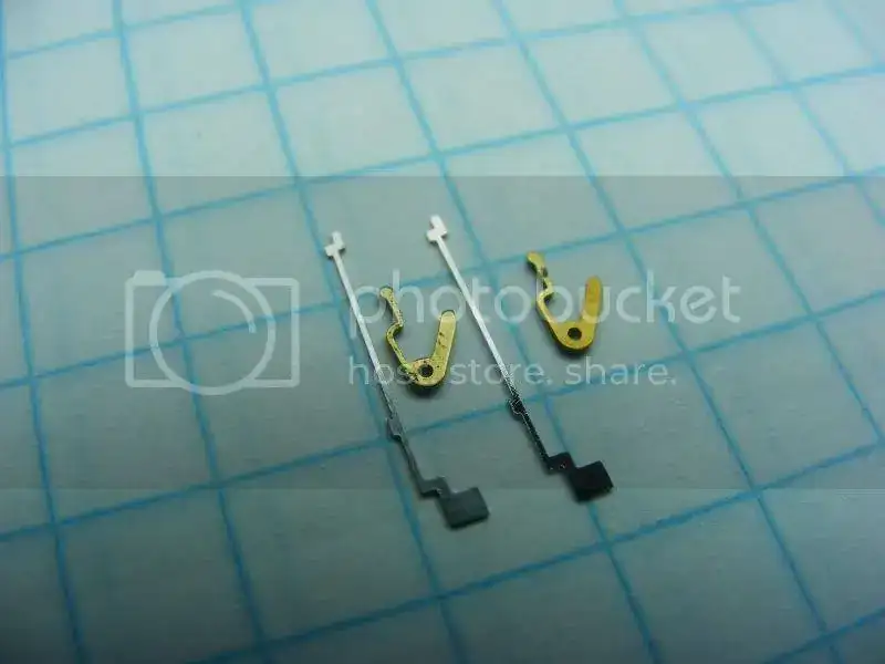

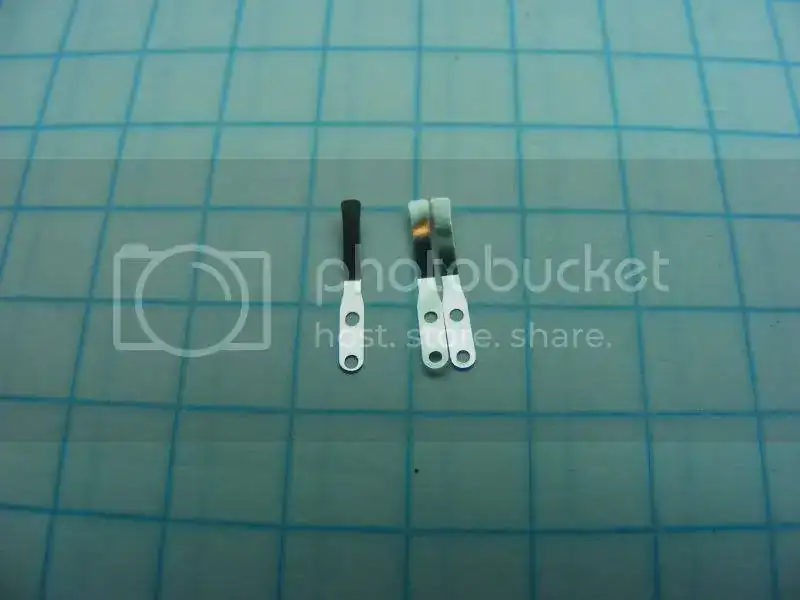

Click/Click spring combination and hack lever
C-spring

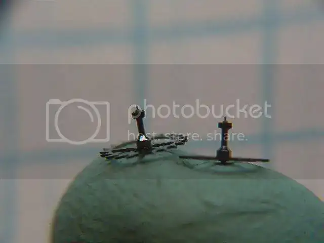

Here is the only difference I found:
