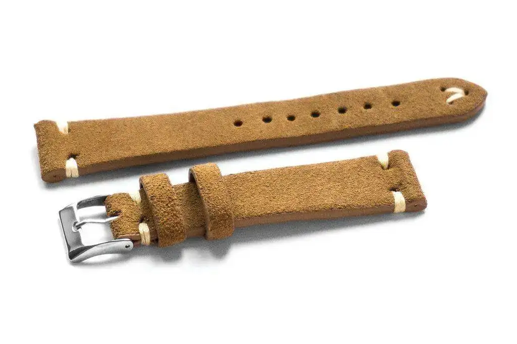

En la sección de leather nato straps tienes correas nato de ante o piel vuelta, son las que pone "sucede nato strap"
Yo tengo una marrón claro de ante en un seiko vintage y queda genial, tienen un precio muy asequible y buenas calidades.

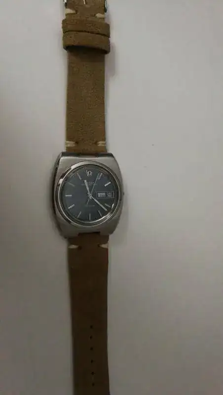

Tienen tan buena pinta que me he pedido está. Voy a intentar hacerlo yo, he medido y solo tengo que "morderle" 2mm. A ver cómo queda! Gracias la web está muy bien y vienen de Suecia. Portes 1,95$ por Deutsche Post. A ver las calidades. Creo que según presupuesto voy a pulir a espejo la caja y ponerle la correa, puede quedar genial...
Ver el archivos adjunto 468858
Muy bonita compañero, seguro que le queda genial la combinación, ya nos contarás cómo queda y si has podido moederle esos 2mm.

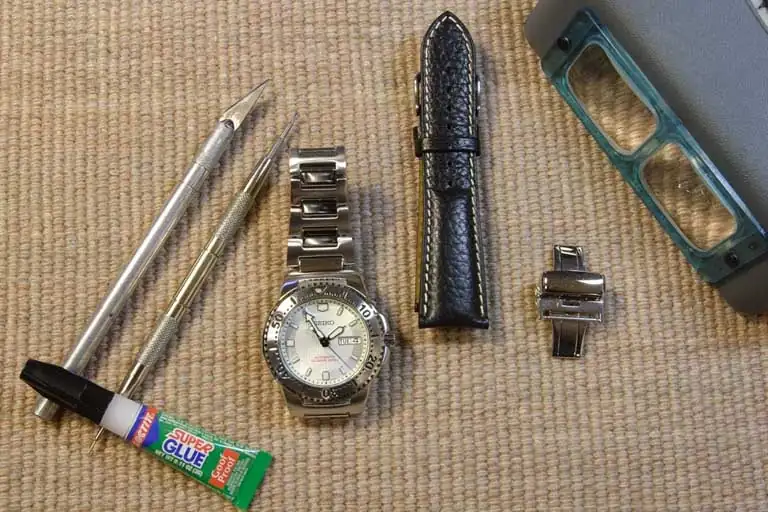

My project for this afternoon is my Seiko SKXA47K White Knight, with its semi- integrated bracelet. I've wanted to put this on a strap for a long while and now is the time! Below are the basic tools I'm going to use, an Exacto blade to do the cutting, Super-Glue to hold down the 'flaps' after I cut them and magnifying goggles so I can see precisely what I'm doing.[/SIZE]

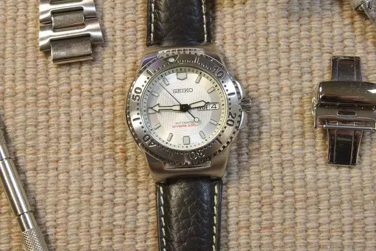

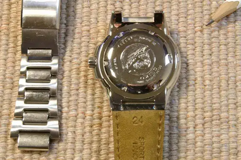

[SIZE=+1] I picked a 24mm pilot style strap because it seemed like the right overall width to match the White Knight case design, but you can see the problem in the picture below, the stock bracelet has a small (15mm) center part that sticks into the case to mate up. I certainly didn't want a 15mm strap on this monster of a watch, so my plan is to cut notches in the strap, on the outside corners, to create a 15mm wide center section that will mate up like the original bracelet.[/SIZE]
[SIZE=+1] Here I'm using a soft sharp pencil to mark the lines I'll cut on, using the case lugs as my model. You could also use the bracelet to determine where to cut. Measure and make your marks carefully, remember the advice, "Measure twice, cut once!"[/SIZE]

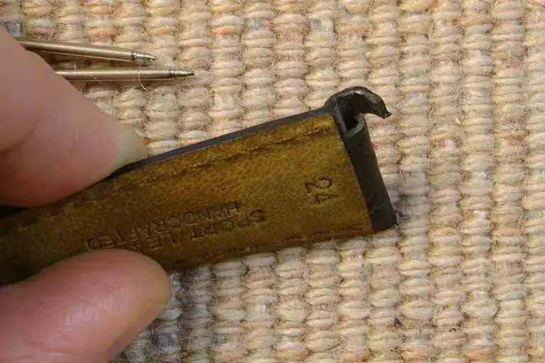

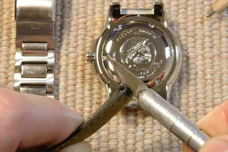

[SIZE=+1] Now the scary part, cutting the expensive strap you bought.
Cut straight down from the top, but with the blade angled slight as shown so your cut is deeper at the back of the strap that it is in the front. Cut all the way down through the 'pin loop' to the thick part of the strap, at this angle. You can always go back and cut more deeply in the front if you need to![/SIZE]

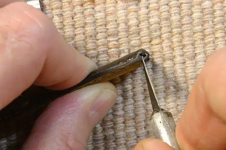

[SIZE=+1] Now you cut in from the edge, on the back side ONLY, to meet the top-down cut you made. You are trying to make a 'flap' out of the corner of the strap that is in the way, so you can pull the flap to the back of the strap, out of the way, and glue it there. Then it will have a smooth 'shoulder' and look original, not like it has hacked out.[/SIZE]
[SIZE=+1] Below you see the first two cuts are done, and the 'flap' I'm talking about.[/SIZE]

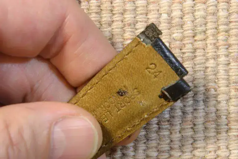

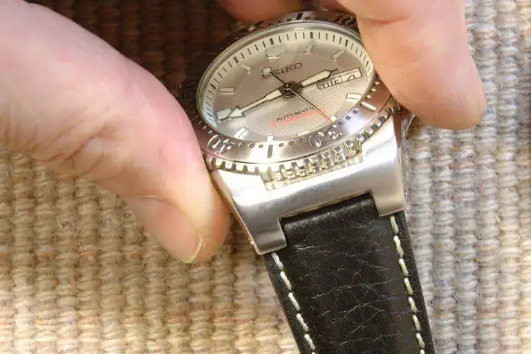

[SIZE=+1] Try folding the flap down to create the notch and hold it up to the watch case to check on the fit. Usually, in my experience, but not always, the notch won't be deep enough, and now is the time to perhaps cut the front a touch deeper, but more importantly (and more effectively) trim some of the material out from behind the flap so it can fold down more and make the notch deeper.[/SIZE]

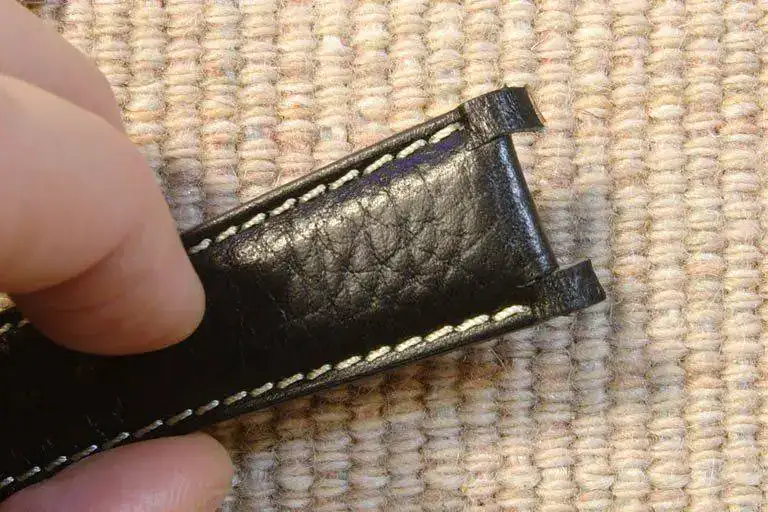

[SIZE=+1] Be careful when trimming the material out from behind the flaps, I had to trim some of the thick strap material below the back of the flaps in this case, so they would fold down deep enough. Try not to cut the stitching either! Here is a picture of both sides cut, and trimmed, ready to fold over and glue.[/SIZE]

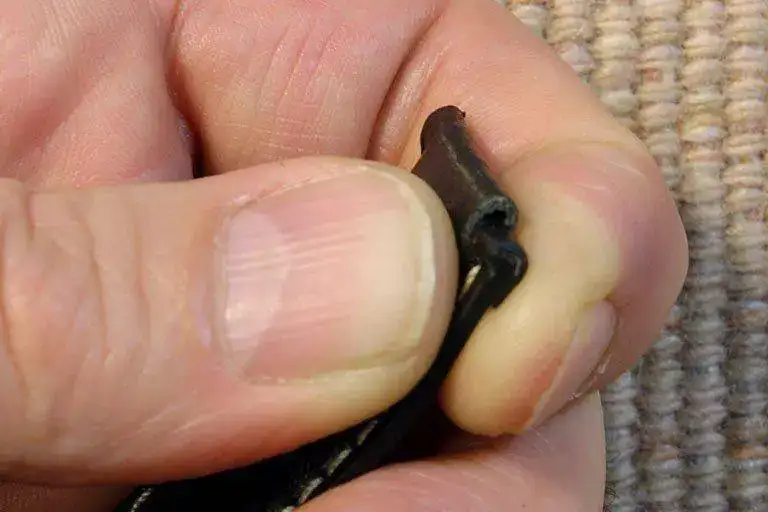

[SIZE=+1] And below you can see one flap folded down and Super-Glued. You can also see where I have trimmed some material away from the back of the strap on the other flap. I put the Super-Glue on the inside of the flap, fold it over, pulling tightly to make the notch as deep as possible, then hold the flap to the back of the strap until the glue sets. I occasionally lose a little skin in the process.[/SIZE]

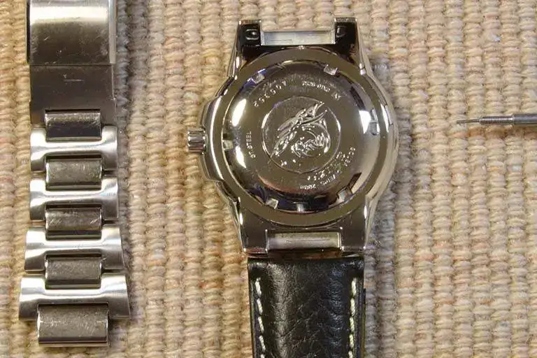

[SIZE=+1] And here is the tongue side of the strap, all glued up and installed. The leather where the spring bars go through will stretch over time, so don't make the notches too deep. I usually cut them such that putting the spring bars on is fairly difficult the first time, which is a pain I'll admit. But the upside is when the leather stretches later the strap will still be a nice tight, attractive fit. [/SIZE][SIZE=+1]
[/SIZE]
[SIZE=+1] And below, through the magic of editing, is the whole strap, cut, glued and fitted! Quite a different look from the original bracelet, but looking very proper and professional, no rough edges. Another hint is to use a black magic marker on the remaining exposed edges of the cuts you made so they are dark black and don't distract from the professional appearance of your work.[/SIZE]

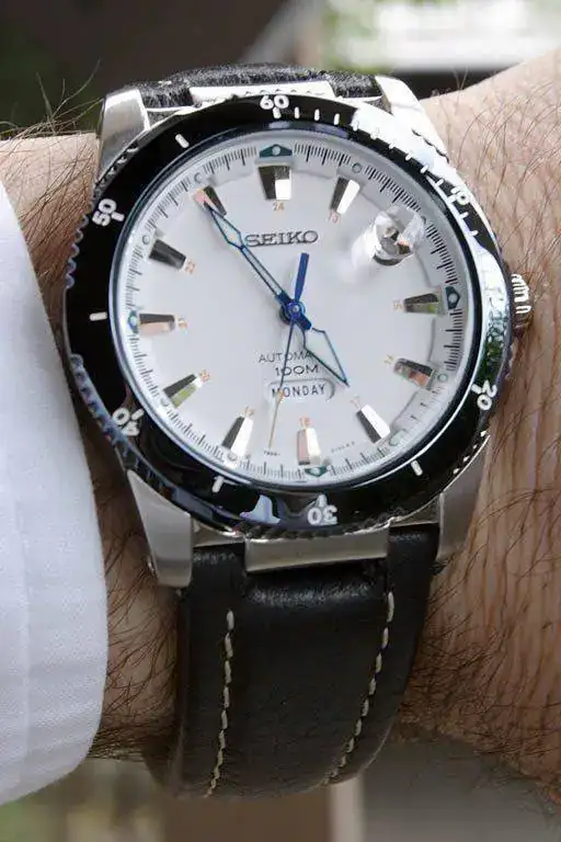

[SIZE=+1] Next is installing the nice butterfly deployant, and trying the completed project on! Here is the watch I was wearing today, very 'patriotic' on this Fourth of July, since red, white and blue are the color of the US flag! [/SIZE][SIZE=+1]
[/SIZE][SIZE=+1] It's my Pepsi version of the Citizen NY2300 series divers, on it's original rubber strap.[/SIZE]

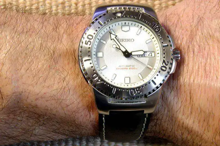

[SIZE=+1] And now here are a couple of hairy wrist shots of the completed project. Here's a normal top-down kind of shot.[/SIZE]
[SIZE=+1] And here is an angled version that shows more of the new strap. I like it!

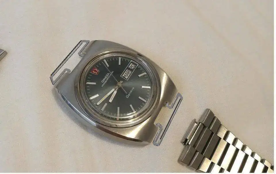

Pues una vez lo intente, lo de cortar una correa para adaptar a ese tipo de asas, y perdi tiempo y dinero.
La verdad es que no le veo mucho una correa que no sea su armis.

Yo me pondría el Omega este con su armis; no soy de armis de ese tipo, de hecho solo tengo dos Tissots vintages y llevan el mismo sistema de armis con encastre a la caja pero ni me planteo hacer " malabares" de quitar poner etc.; en fin,suerte.................
Para que quede bien, la correa debería tener el ancho de la caja y disminuir en la hebilla, aunque sólo sea un par de milímetros.
En esta foto esta la clave, no es cortar.
Perdona pero que le pasa al armis ?, ¡es genial!. Que no te gusta lo puedo entender pero los relojes vintages van así. Le puedes poner lo que quieras, pero no creo que ligue demasiado con la pieza. Prueba a pulirlo un poco todo: armis y caja, y a ver si con más brillo te gusta más, y lo puedes hacer tu mismo.
Gracias por las respuestas y las ideas. Llegó la correa y le va de vicio pero he hecho un destrozo al intentar adaptarla. Como plan b voy a pegar una tira de piel del ancho de pasador que haga de nato en ese trozo. A ver cómo queda....
yo lo veo bastante bien, aunque hubiese escogido una correa que abarcara el ancho de caja.
Que destrozo le haz hecho?.

Es un reloj precioso, personalmente me gusta mucho como le queda la nueva correa, cual es el destrozo? Porque no se aprecia nada, le va como un guante.
Qué te parece la calidad de la correa?
