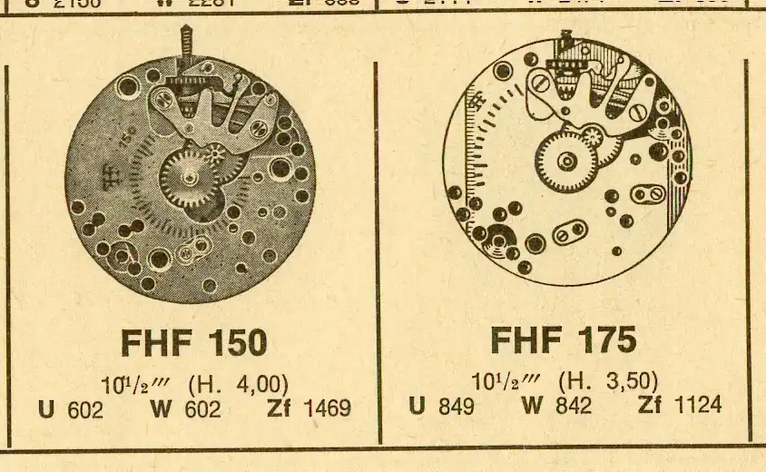

a ver que dicen los maestros, mientras lanzo esta posibilidad. https://www.youtube.com/watch?v=OOfpPAfGGik
[TABLE="width: 100%"]
[TR="bgcolor: #F8C8C8"]
[TD="width: 250"]
Fig. 1
Fig. 2
Fig. 3
Fig. 4
Fig. 5
Fig. 6[/TD]
[TD="bgcolor: #FFD2D2"][SIZE=+1]FHF 150[/SIZE]
Features
manual wind
sub second
Data
10.5 / 11.5''', Dm= 23.3 / 25.6mm
Do= 23.7 / 26.0mm
H= 4.0mm
F= 0.5mm
T= 2.0mm
15 jewels
f = 18000 A/h
power reserve 44h
Balance staff U602
Stem W602
Mainspring / battery
Zf1469, 1.80 x 9.0 x 0.10 x 290mm
Hands
1.40 x 0.70 / 0.21mm
Comments about the data[/TD]
[TD="width: 40%"]Remarks
varying bridge layouts (cf. photos),
many of them probably signed as FHF 150, and only in old data sheets listed with individual designations
differences not known between 150, 151, 156, 158, 159, 162-164, 166, 174, 178, 187, 201, 203, 208
option (only 150, 152): 11.5'''
family:
150: sub second
150-1: sweep second
150-3: sub second, date hand
Example, year: signature; shock device
1-2) ca. 1940: Swiss, 15 Jewels - FHF 150
(10.5''')
3-4) ca. 1945: 15 Jewels - FHF 150; Shock-Resist
(10.5''')
3-4) ca. 1950: Swiss, 15 Jewels - FHF 150; Incabloc
(10.5''')[/TD]
[/TR]
[/TABLE]
Hola cesccat . Es muy parecido , acabo de pedir al vendedor para medir el diametro del calbre para ver si nos aproximamos mas .
Bueno , el vendedor respondió , 26 mm el diámetro del calibre .
