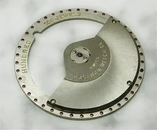

porque de acuerdo con la ISO 1112, solo se cuentan los rubis que tienen una función.
The ISO standard is written to clearly establish what can be termed a functional or non-functional jewel. It defines a functional jewel as a "jewel which serves to stabilize friction and to reduce the wear rate of contacting surfaces of the components of a timekeeping instrument". It defines a non functional jewel as a "jewel used for purposes other than as defined in 3.2" (ie a Functional Jewel). In addition, the standard contains detailed drawings which clearly define the functionality of various combinations of jewels and pivots. I would like to propose a third category - which I will call "Useless Jewels". That is, jewels which are technically functional according to the ISO standard, but which are used in places which serve no effective purpose other than to increase the jewel count of a watch
